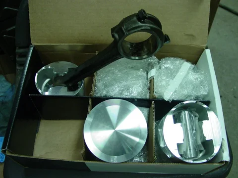

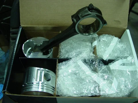

The pistons did come in from Wiseco, .060" oversize, stock dome height. CR increases to 8.2 with the increase in displacement, plus the flat face SBC valves and a .020" mill raises it further to ~8.6:1. These pistons are actually heavier than stock, due to machining constraints. But that just means they are nitrous-ready. :hillbilly:
Box o' Pistons:
better view of pistons:

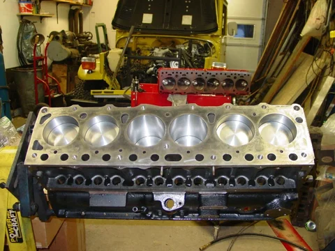

Pistons stuck in a 2F block:
