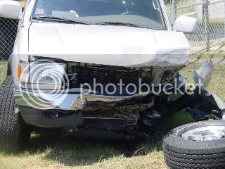

Hi all, I'm John and I have a 99 4runner that is going from 2wd to 4wd sas and from crashed to repaired. This build is taking what seems like forever.
Here is how it started :whoops:.

Thanks. This was my daughters 2wd 4runner before she turned into an oncoming 96 firebird going about 50 mph:whoops:. I am going from 2wd to 4wd sas with body work. I have found it to be difficult to find body/frame parts, they all seem to be smashed in the front or rolled. If I ever get it done it will be sweet.:cheers:
