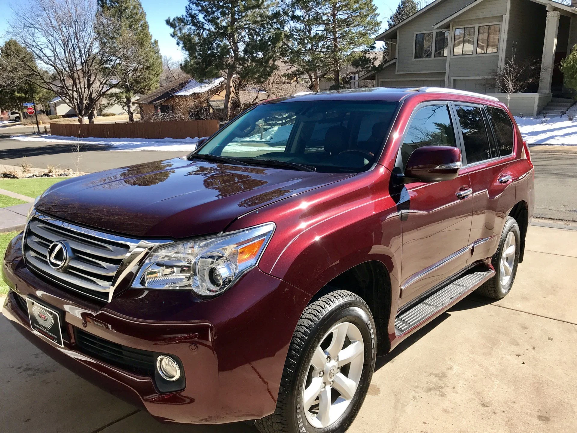

Anyway, I found this incredible low mileage (42k miles) 1-owner well-maintained example for $28k and had to grab it.
Behold! (It won't look like this soon, stay tuned)

Congratulations on your new toy! What trim level does it have?

Thanks Richard, I believe the trim level is "premium" - it has the power 3rd row, rear entertainment, but no AHC or Crawl.

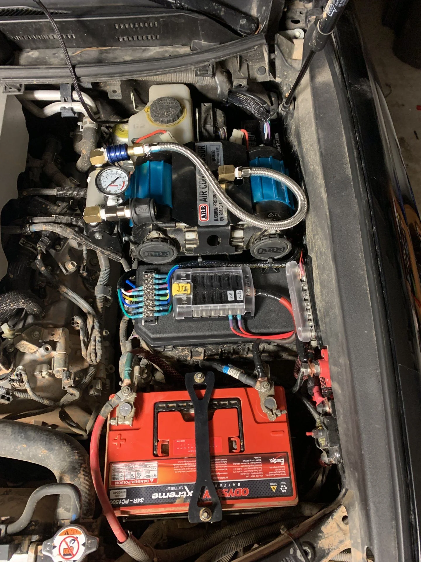

I like it! Same compressor and location that mine is. I purchased mine from Slee Offroad.
I also have my quick connect right there, but I didn't add a pressure gauge.
Just curious what you may need a pressure gauge for? In the last three vehicles I've built that all had compressors I've needed one. but I'm open to a good excuse to put one on. I think I have an extra pressure gauge laying around in my garage somewhere. When I air down, and need to inflate, I just use the gauge on my tire chuck so I can see the pressure at the tire.

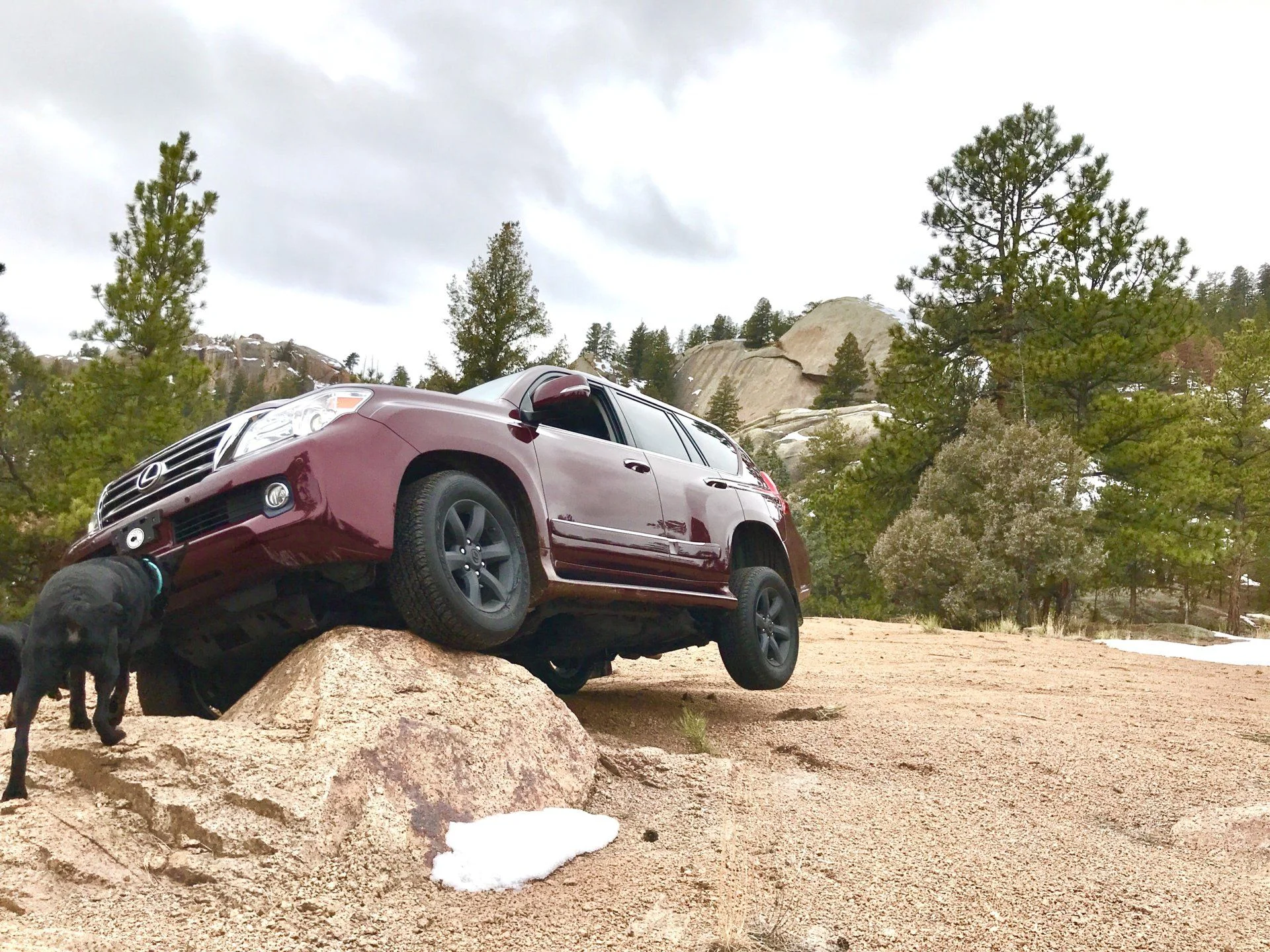

Flex isn’t too bad. Not as good as my 200, but it’ll do!

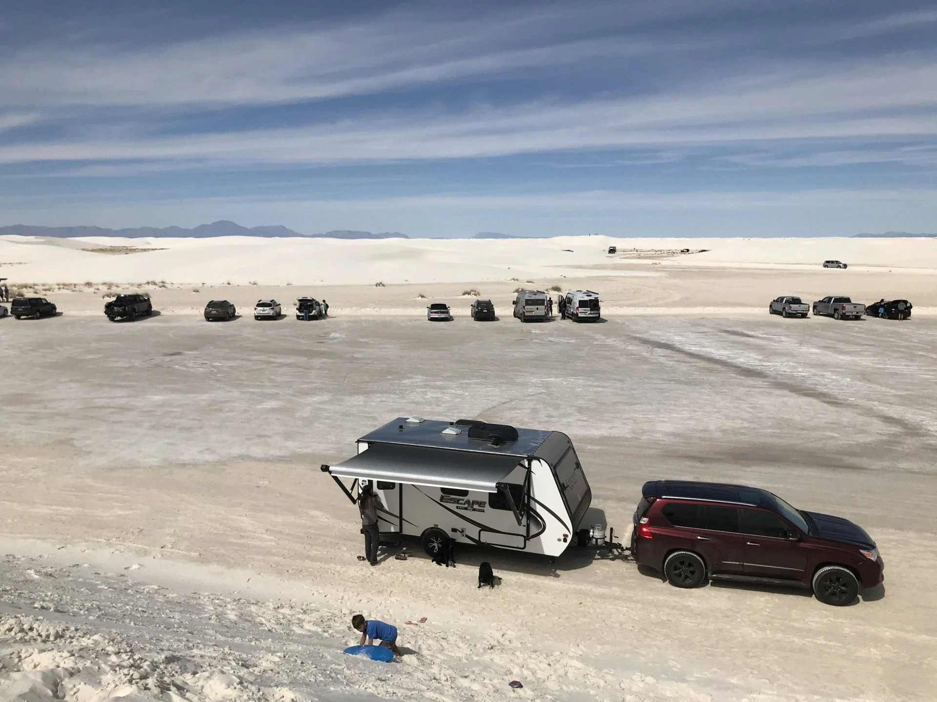

First towing experience. 3,000lbs dry weight travel trailer, towed 1200 miles round trip from Denver to White Sands National Monument in southern New Mexico. I added a Curt hitch, trailer brake controller and went for it.
Lots of gear, 3 kids, 2 dogs, 2 adults and incredibly high winds passing through Raton and some other places. The truck did excellent when there was no wind, but in high wind I was floored in 3rd.
The weight and size of the truck were a significant advantage over any car-based crossover in terms of stability.
I would estimate 5,000 pounds all in on the weight.
Side note: check out Meow Wolf in Santa Fe NM! That place is crazy weird and cool.
I like your setup and about what I was thinking for a camper size (here in Denver as well). Did you do weight distribution hitch? did the trailer track straight or fishtail in the wind (would love to find a small dual axle). Have you added an additional tranny cooler? thanks
No weight distribution, just tossed the trailer on the ball and went for it.
Tracked straight as an arrow, never got “fishy” on me, even in intense wind.
I didn’t add a tranny cooler. I moved the shifter over to 4th gear and let the engine rev higher than normal - I kept it from hunting between 3-4 by feathering the gas pedal most of the time. Cruise control really wanted to grab 3rd a lot, but once I got a feel for the transmission I was able to keep it in the power and without the extra shifting.
As for the trailer itself, we’ve really enjoyed it for the year or so we’ve had it. Very maneuverable and light, but also has enough room for our family of 5 and 2 dogs because it’s a hybrid (both ends fold out to queen size beds.) Still gives you the amenities of bathroom, kitchen, AC, heat, etc.
I should add that I have Spidertrax 1.25" spacers at each corner. 2.5" overall width increase - I firmly believe this helped considerably in high cross-wind situations.
