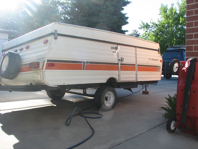

Here is what I came home with, A 1978 Rockwood RW1008.
The bad...
It has a few other small 1" or smaller holes, However for $100.00 we couldn't have asked for more, We could have gotten it for less, But the lady was a single mother of 3 and she threw out the $100.00 price.
I have put new bungee cords on the slide outs, Run new copper tubing for the stove and heater, My wife or nephew will be sewing up the holes.
I plan on doing an SOA on it so I can fit some 13-14" wheels on there, It towed great.

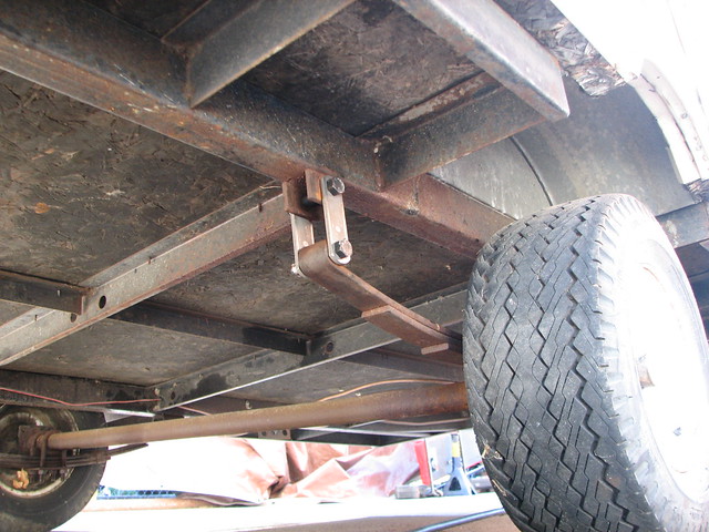

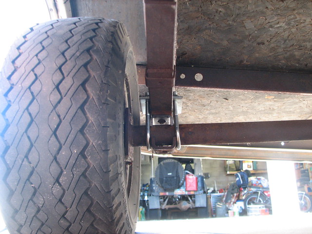

First off I wanted to get rid of the puny 20" tires on this thing, So I figured I better do an S.O.A. on this muthuh!
All I needed to do was buy a $25 kit and bolt it on, I think I will go through and weld on the spring perches once I have it square.
Now I have 4.5" in front of the tire and just over 5" behind the tire, So I could very easily 26-27" tires, Not to mention improved road manners.
I hope to have the tires tomorrow along with some bearing buddies.
It's pretty easy and cheap to swap hubs to a 5 lug style which opens a lot of options for wheels. You might also consider adding some shocks, I find my SOA pop-up a little bouncy on washboard without them.
Yes, I was considering swapping to 5 lug, That way I know I can get a 26" tire, Its just adding at least $100.00+ to the project, Not a huge amount..

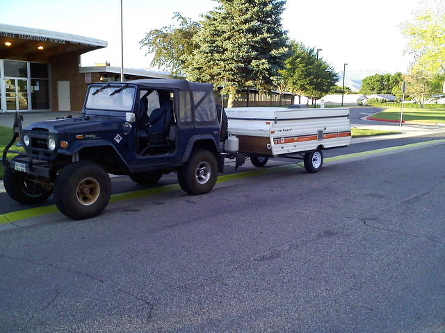

Here is the SOA finished project.
26" tires on 14" rims, I had to go with the 5 lug hub's but that wasn't a huge ordeal.
For those of you that may not know, My FJ40 is also sprung over with 35" tires
