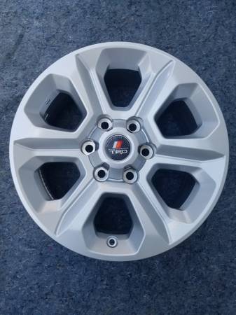

My wheels are UGLY, stock but they are beat. Would 4Runner 17” wheels work fine? There are so many wheel and tire threads and I think I’m more confused than when I started searching. Found some for sale locally:

On the wheels, pay attention to the offset and width of wheel. Go with something like a 17x8 with zero offset and this wheel will allow you to go to a taller and slightly wider tire if needed.

4Runner wheels fit just fine but are 0.5" narrower but if you stick with the stock size tire, they are fine. I got a set for my highway tires from CL for $125 with extra lug nuts :cool:
