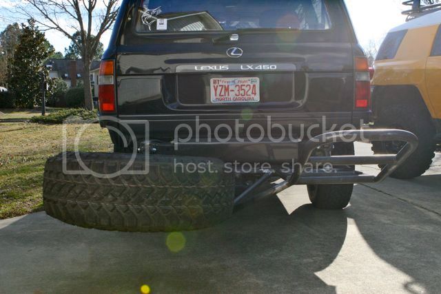

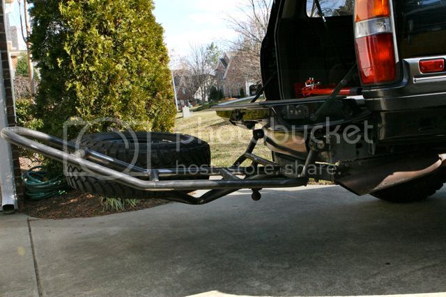

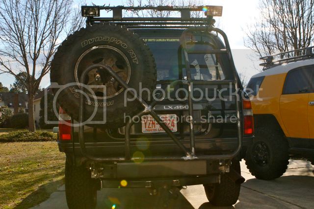

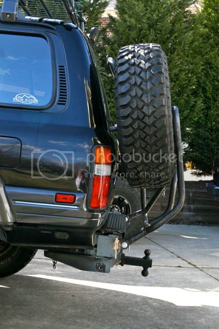

Eventually I'll have a swing-down style tire carrier on my truck, but it won't be assisted. It'll simply flip down and face the ground.
How about a swing down mounted to a stout swing out. It will allow access to the rear yet still serve as a swing down when required. All manual, its a spare tire swing down, something that gets used infrequently on most rigs. Something like an actuator or tilt and trim set up requires regular use to keep in good working order. If not cycled on a regular basis they will not work when you need them to.
