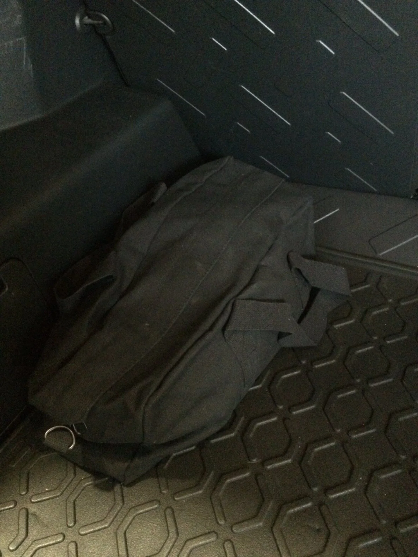

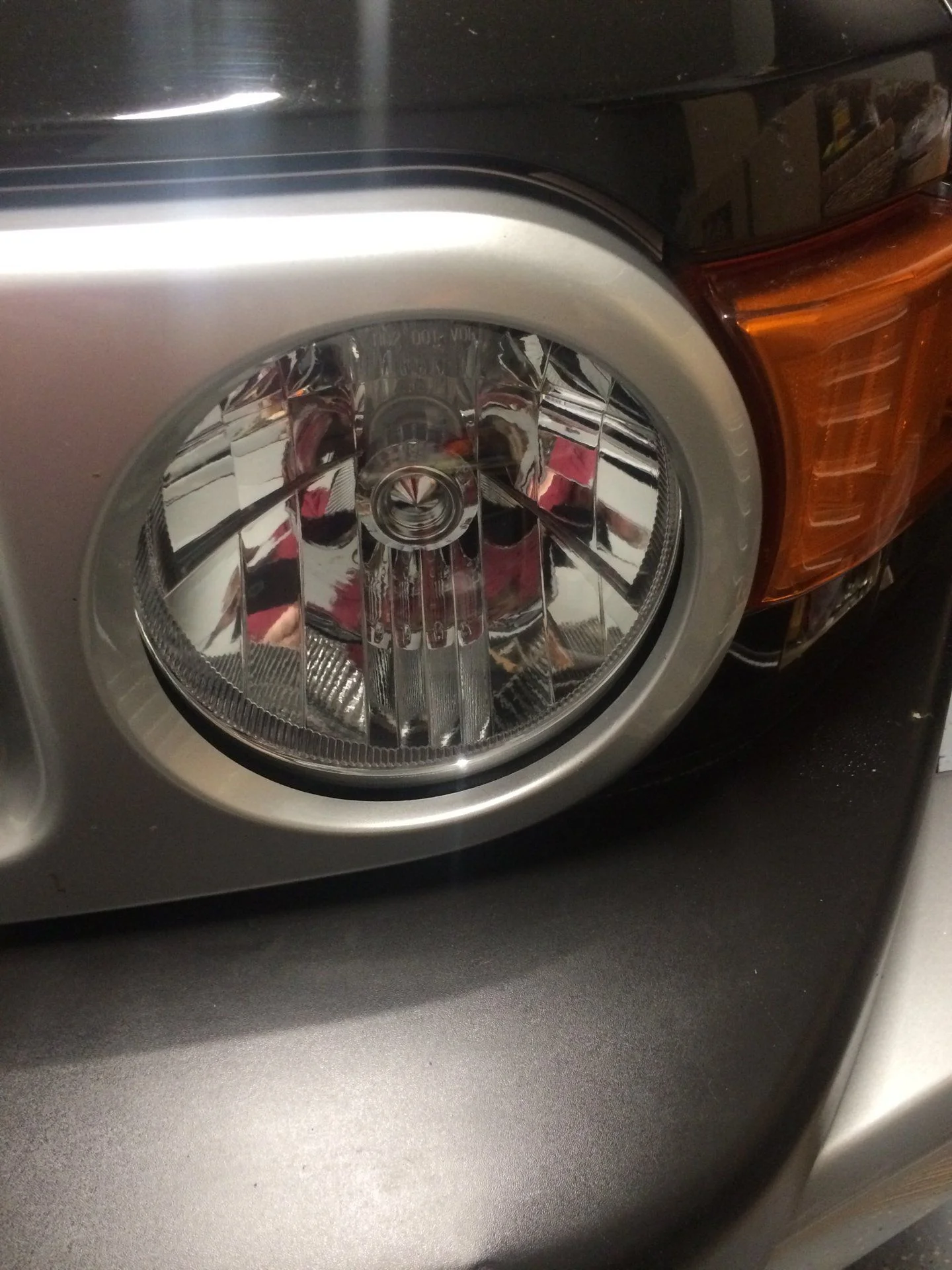

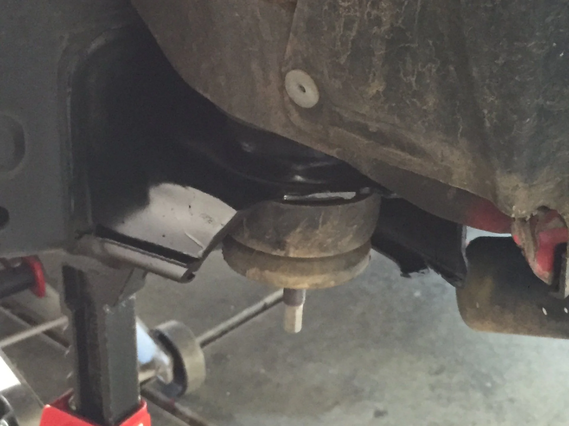

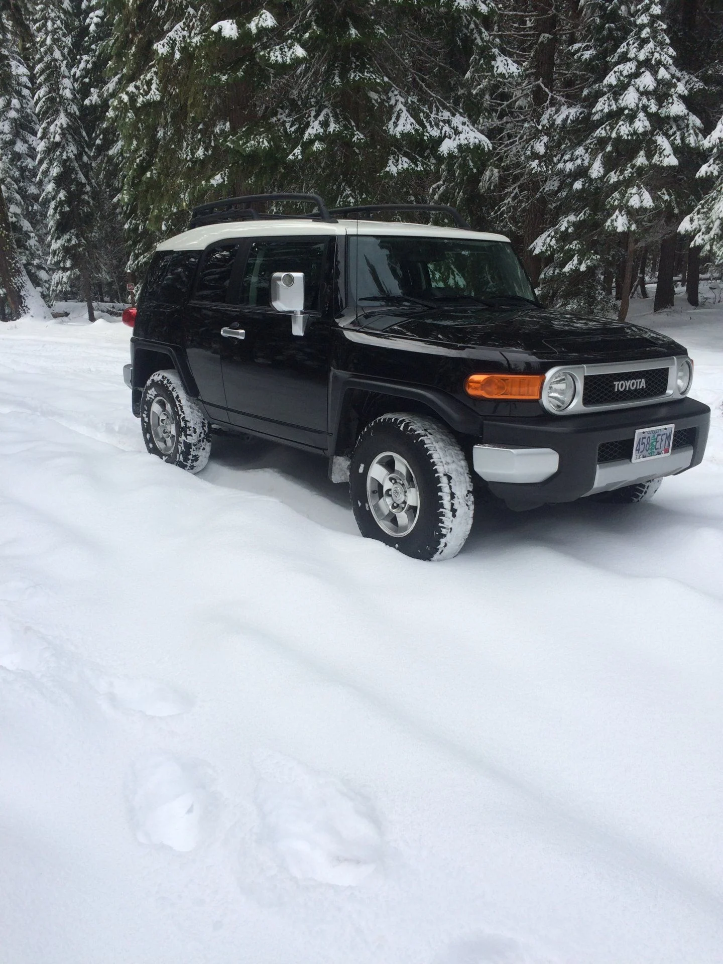

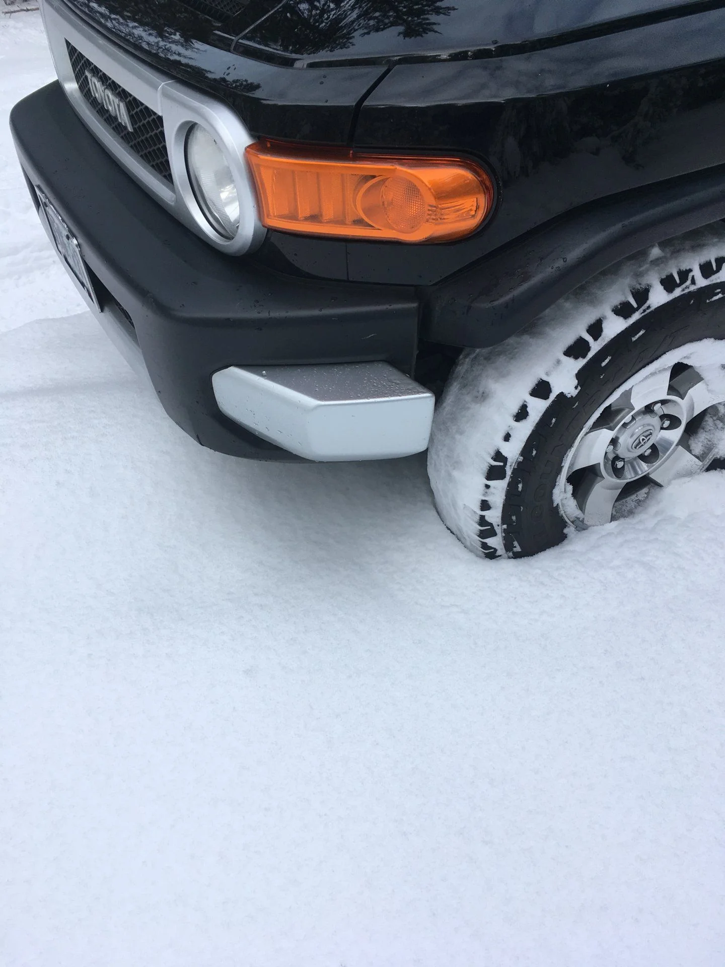

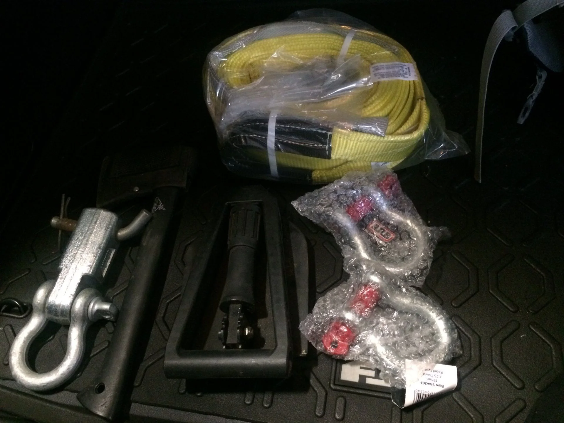

So I have been real busy with work so the fj has been on hold . I did get a few things though . I purchased a set of the body mount chop plates from metal tech I have orderd a Springtail rear door rack . And I picked up some basic recovery gear from Wheelers off-road . (Recovery strap / a few d-rings and a warn receiver d-ring . Stopped by the army /navy store and picked up a bag to keep it all in . Added a gerber folding shovel and gerber hatchet . Booked my room for the FJ summit this year . Still on the fence on what wheels to run . Looking at fuel Anza. Or ICON but having a black fj I think black wheels mite be to much ? I am really really considering having the fj painted or maybe a wrap . My headlights were a little fogged so I picked up a maguriers headlight restoration kit . Super easy to do . I popped my grill off to make it easier . They look like new again I have also decided on running Demello bumpers . Took her out yesterday to play in the snow a little .

Nice, I will say that when I did my bmc I did not weld end cap plates on the frame. Does not need it , the strength is still in the channel section steel. I am a certified welder and would have no problem welding the end caps on but it is just not necessary, just primer it and paint it black and leave it. I put the rubber cover back on to keep street crap off it but thats all. Heres a pic of mine. BTW, do take a piece of low-tack tape (painters blue masking tape) and form your cut line then use a silver pencil to mark it and remove the tape ( so you dont burn it) Remove the rubber bushings and wear welding gloves and a full face shield and ear plugs and use a cut-off wheel in a 41/2 inch grinder and cut in a direction away from you and you can have those chops done in 5 minutes each.
