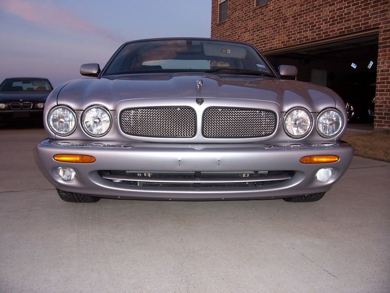

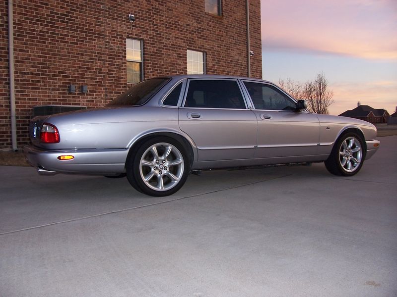

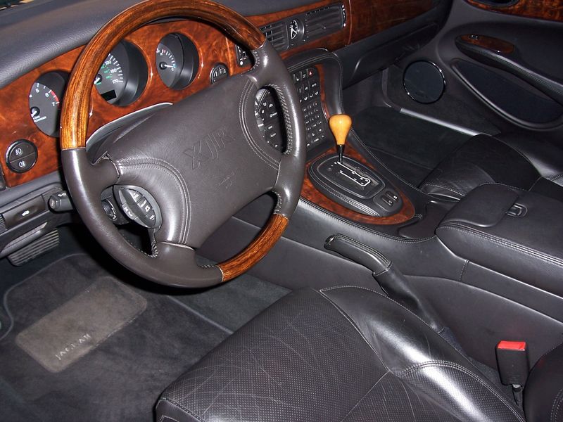

Screw the cruiser. I want pics of the jag.
Apr 26, 2004
5,816
Utah
Looks like some sweet cars in the stable, I'm wondering how the cruiser fits in?
Oct 20, 2008
305
Wichita, KS
Actually the pics are from the PO so it's not my E39 540i in the background. I've been too lazy to take pictures. The Land Cruiser actually is replacing a Mercedes C36 AMG (sold), which has been my daily driver for about a year. I don't need two sports sedans, but I do need something that I can happily drive in poor weather, haul lumber from Home Depot, pull my 4x8 utility trailer, and take fishing. I'd also like to try my hand at some light off-roading. The FJ80 will share DD duties with the Jag, along with serving a "utility" role. My wife is tired of my hauling 2x4s in her Mazda MPV minivan.;) Plus I've always loved the Land Cruiser.
