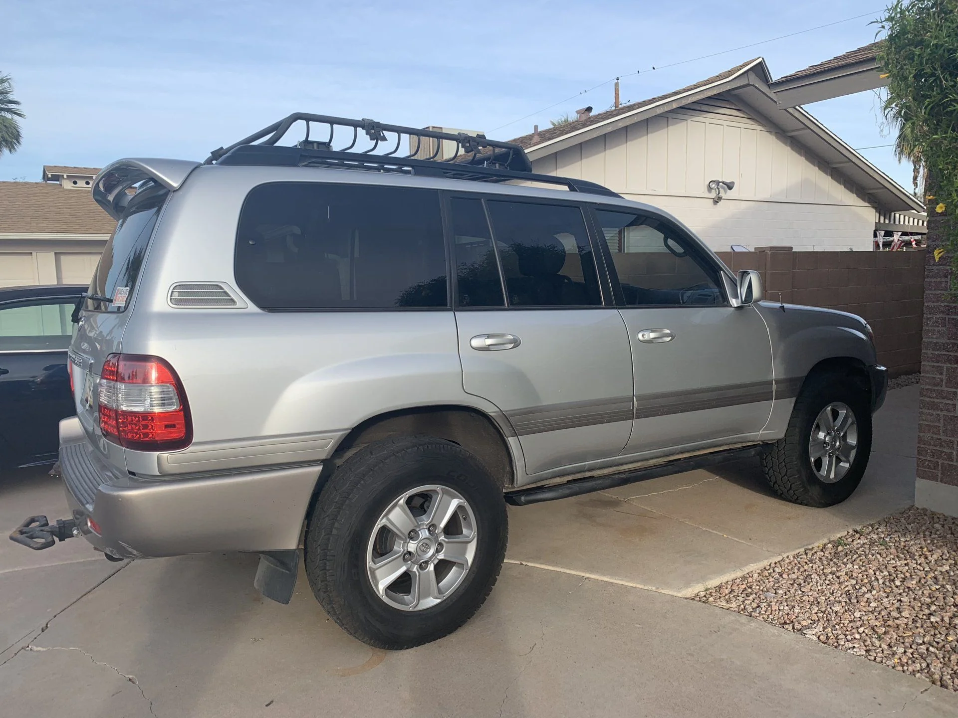

Wow! It does look super clean!... especially for 212k miles. Cosmetically, looks mint in and out. Congrats! How much $?
Love your mods - subtle and very tasteful. Thanks for posting.

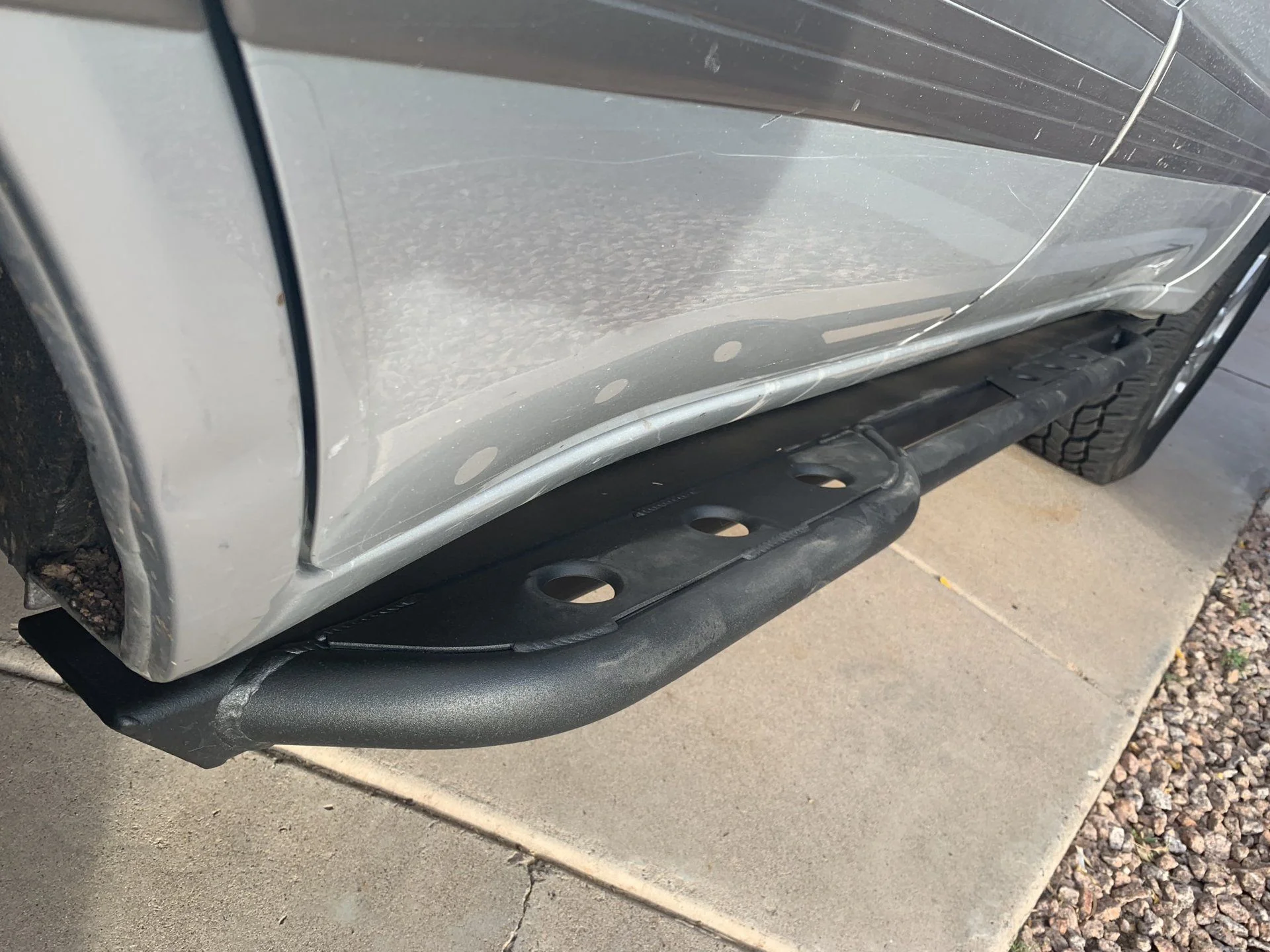

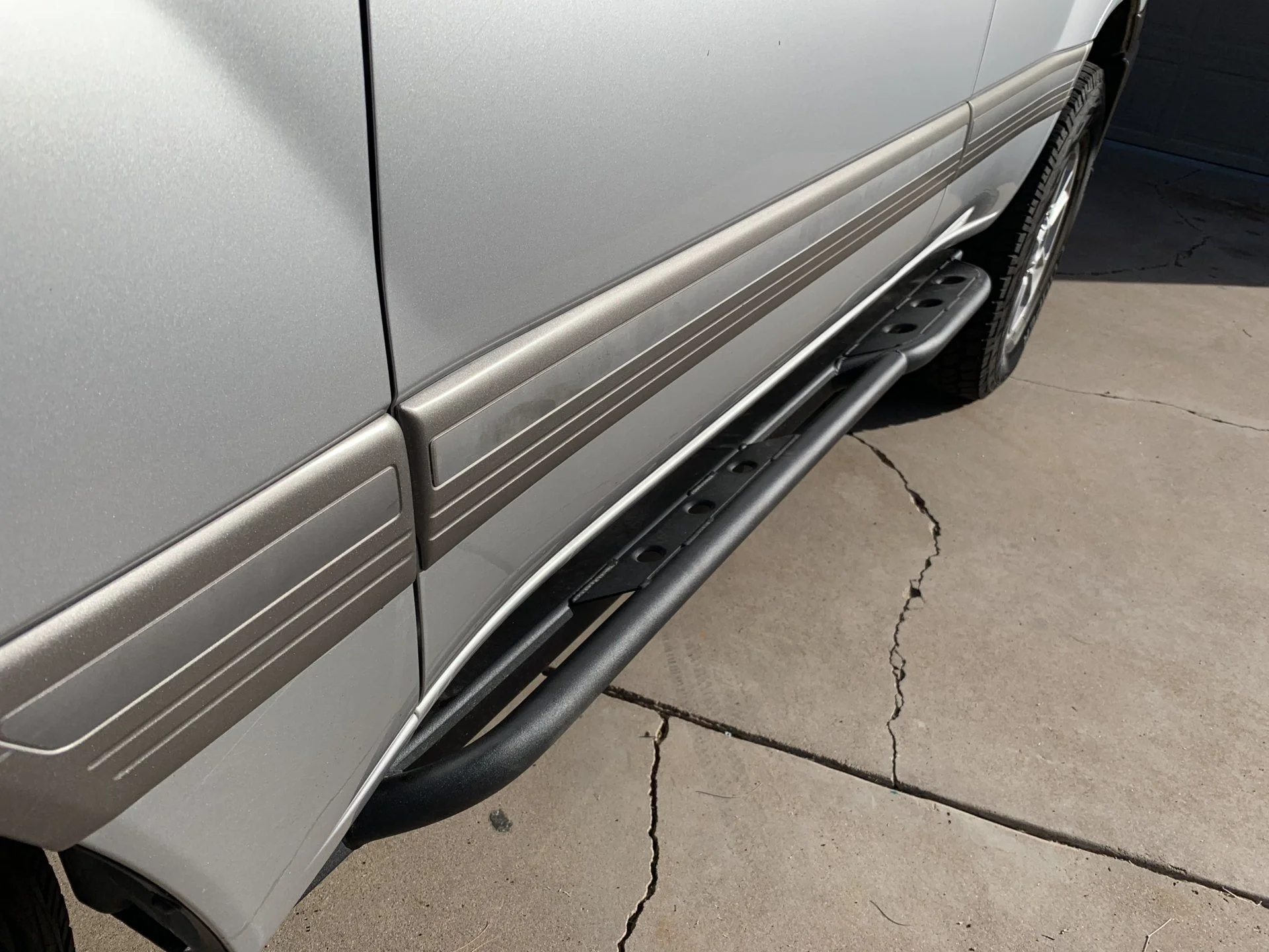

Finally got around to getting my metal tech sliders powder coated! I'll install them once the ambient temperature is below 90, sooooo late October.
10/31 - Halloween treat for my LC
As Promised finally got around to installing my metal tech sliders. the process was really easy, jack stands and AHC make it an easy one-man job. Also changed the oil while I was under there, went with the Mobile1 synthetic and the Napa platinum filter (made in the USA)
