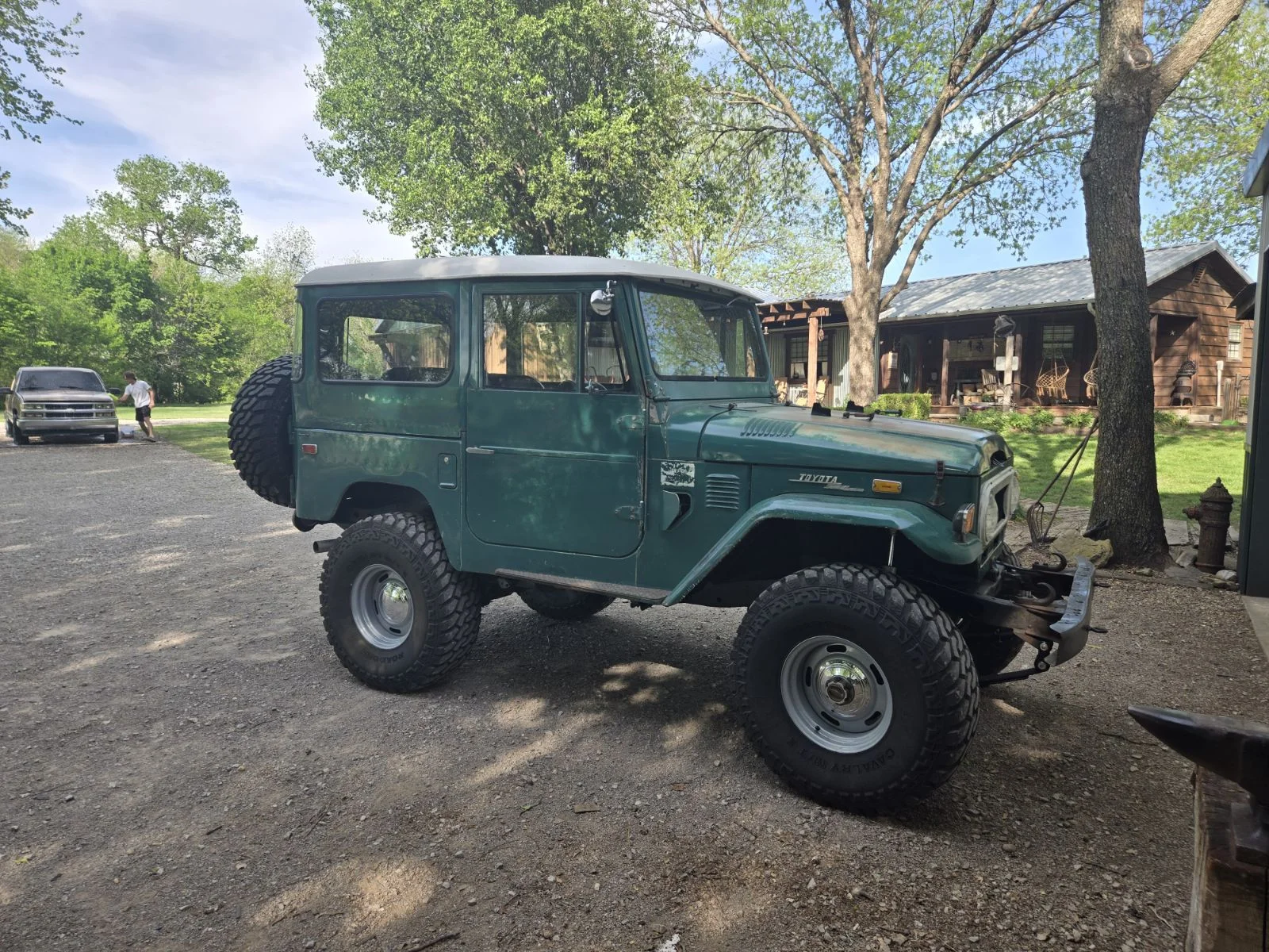

1973 FJ40. Work in progress. Currently 305 chevy, 3 speed toyota. 4 inch lift on 35s. Lockers front & back. 4 disc brakes. Plans are 383 with sm420 transmission. Its just for fun, won't ever be a clean show truck.

Welcome, and you have a great looking 40. In the photo posted above, has the engine already been removed? I ask because that front shackle angle is negative, which is definitely not an ideal setup. 40's ride rough, but improper shackle angle can make it way worse!

Motor still in it. This was just a week after the lift was installed. Hopefully some settling will help the angle.
