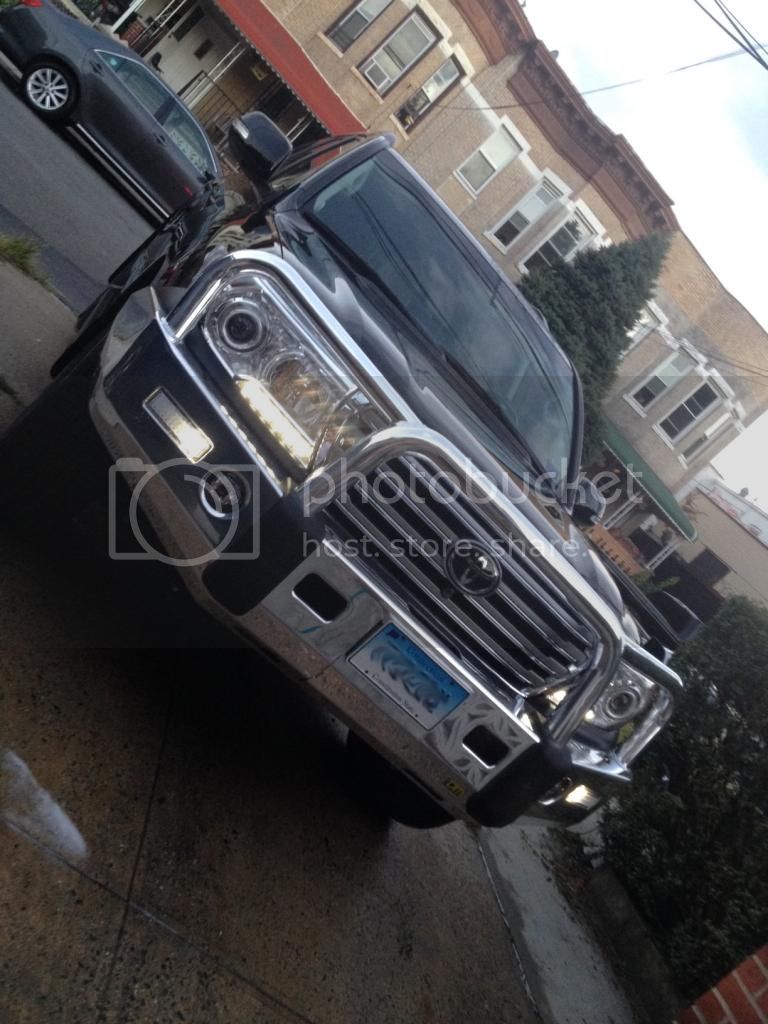

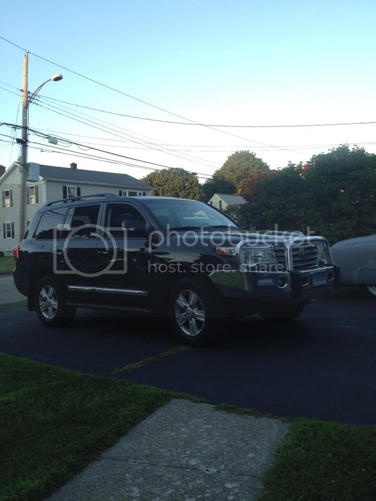

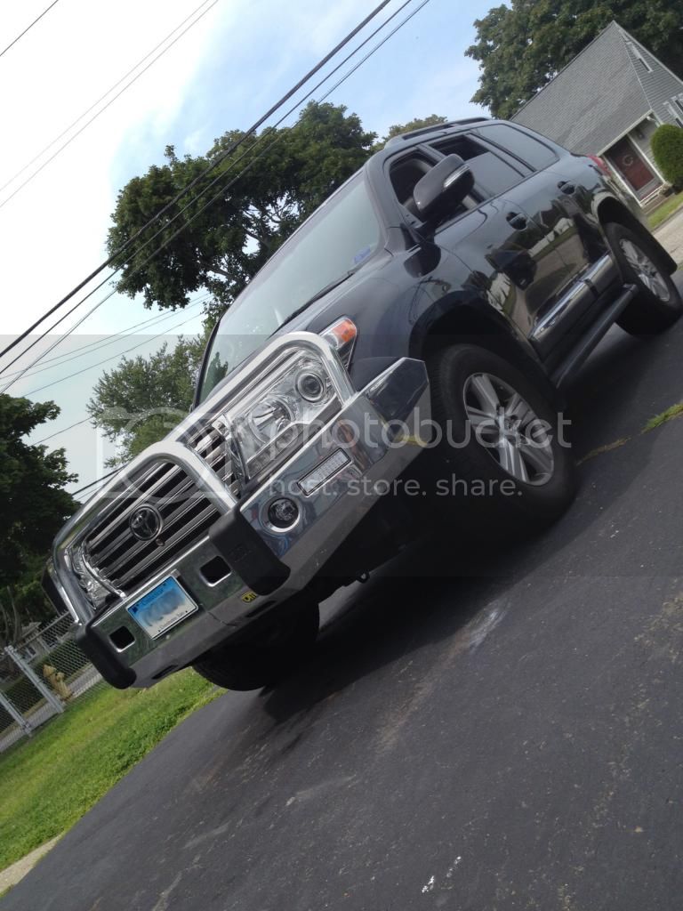

Hey all,
I just received and installed a TJM T15 aluminum bumper on my '13 200. I ordered it from Any's Autosport because they could get it. My local TJM dealer said the factory wasn't shipping 200 bars into the states any longer but clearly that isn't the case. It did take forever to arrive, but I was warned and it wasn't a problem. The bar came well packaged with all the components ready to install. Very nice quality parts. Installation went well and I'm very pleased with the bar. Here are a couple pics.
...just thought you guys would like to know.

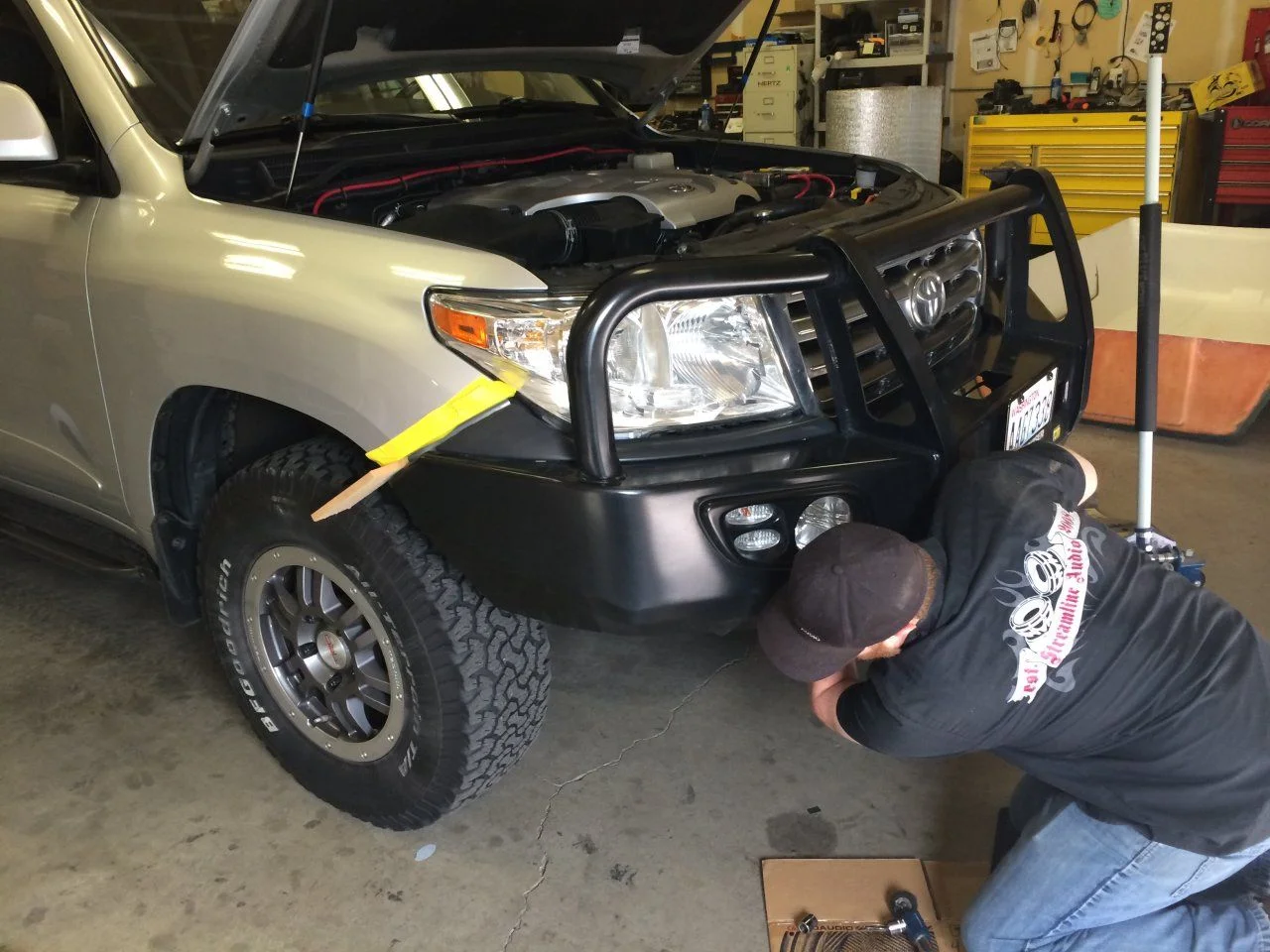

Here you go.

If you don't mind, can you post the picture of the front camera view on navigation screen to give us an idea of how view is obstructed by bars on bumper. Thanks

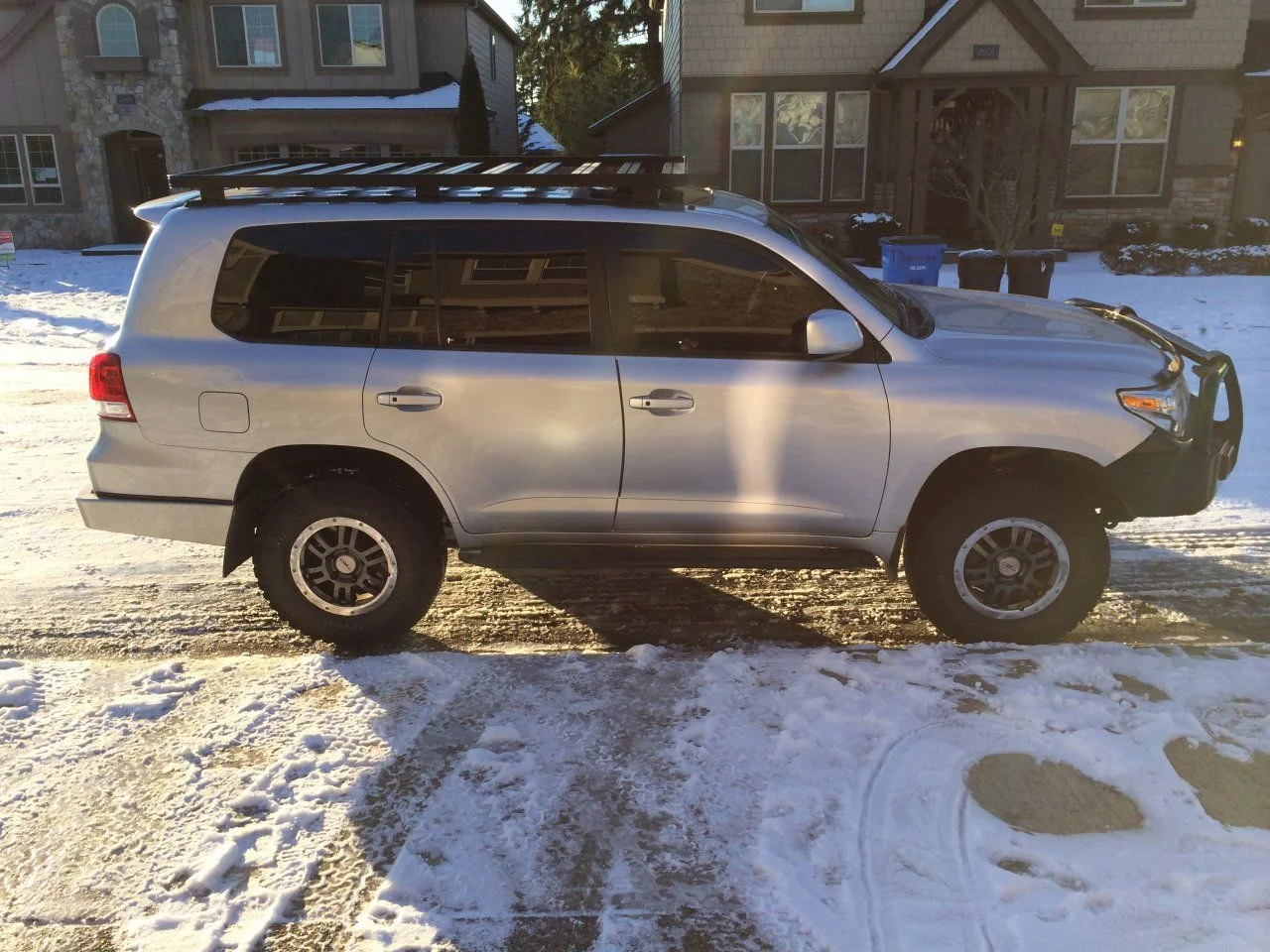

Is the TJM bumper more bulky than the ARB? In front shots it looks to drop lower.
Definitely not, the ARB is substantially bulkier and is the reason I went TJM. I have an ARB rear which I really like and plenty of other ARB products, but for the 200 the TJM was the way to go.
The 2nd picture was a bit distorted, so it looks a bit wonky. Look at the first picture to determine departure angels and how far it sticks out compared to an ARB.

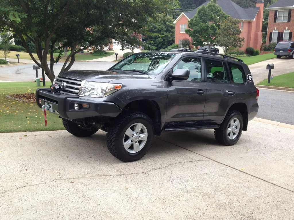

I don't have measurements to compare with the TJM, but here's a somewhat similar shot with the ARB. To me it appears the ARB sticks out further, but maybe not quite as low?

Sorry, I've been away. Here are some more photos including what the front camera "sees"
~ Carl

Carl, you really have to get that gap between your bumper and your panels fixed asap man. Trust me on this, even small bumps will lead to scraping and rubbing noises over time.
Thanks! It's hare to see in the pic but there is a 1/2" space between the bumper and the panel, but I still have to fine tune it. On bumps (pot holes) where the driver's side wheel drops I get a thump. No idea where it's coming from but clearly something needs adjustment. That's my task for the weekend.
Any pointers?

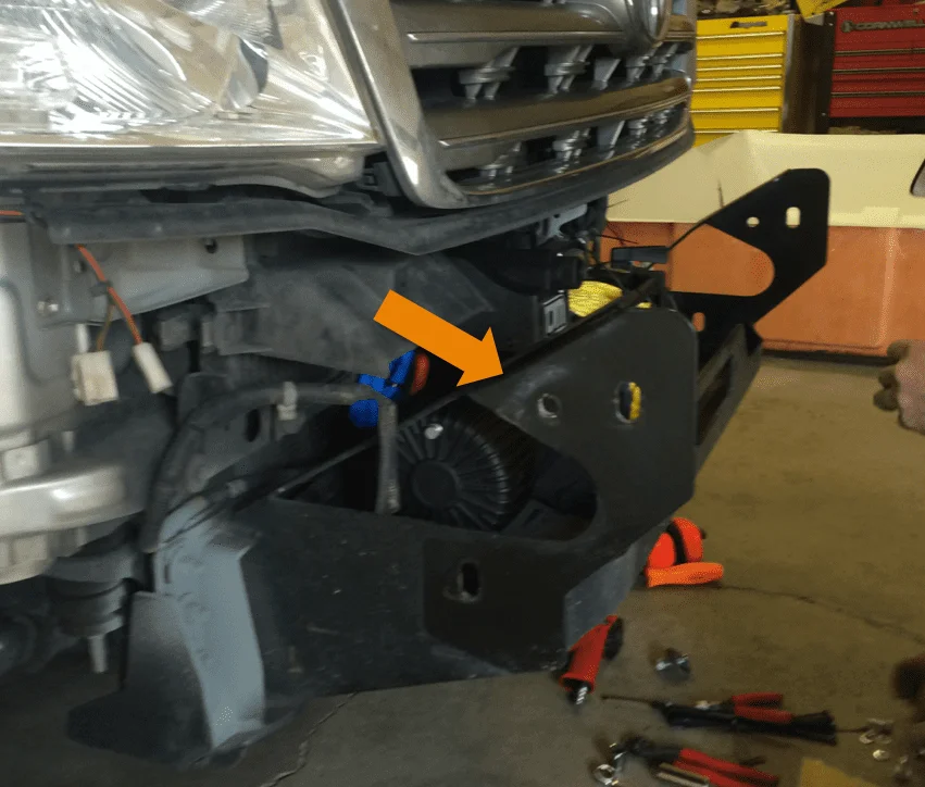

Once you have got it situated to your liking, make sure to drill the third retaining hole (one per side). You will see where there is a place on the side of the bumper where it connects to the winch mount (between the other two bolts) where you can drill into the winch mount to keep the bumper from sliding over time (the two existing holes are slotted and allow slippage over time).
Sort of awkward to explain but very easy to do... take 5 minutes. Spray the hole with black paint, let it dry, and then put the bolt in.
