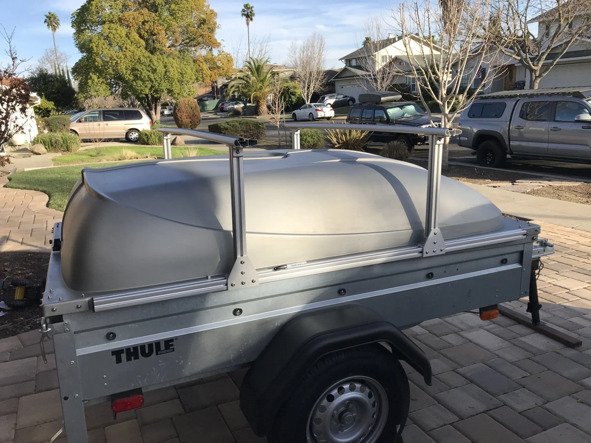

Thats possible. They make a 1'x1", however that said both Thule and Yakima make t-bolt assessors for their newer style aero bars. Heck you can even utilized the Aero bars as I had initially planned to do:

Thanks for putting out the information for building the rack set up. I have everything in hand and I had a question. Did you remove the original spacers from the bolts holding down the lid and then sandwich the trailer cover between the extrusion rail and the steel lid frame?
Thanks.
Thanks.
@Planet can you take a picture of the spacers you're referring to? I'm not recalling the spacers since I added the rack so long ago

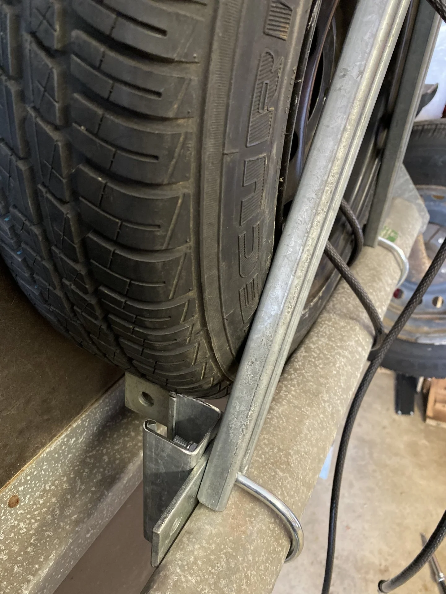

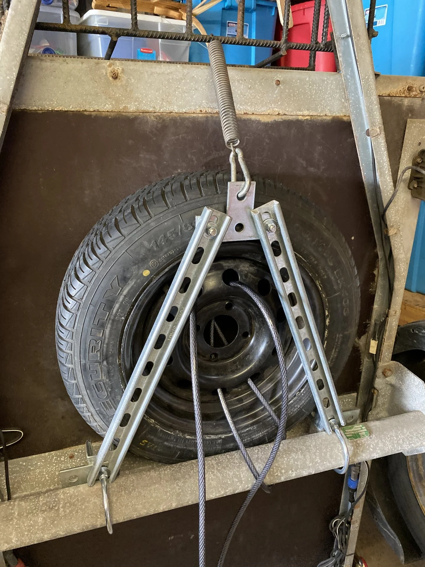

Wanted to share my version of a below-deck spare mount. Heavy on the overkill, definitely not the cheapest way to do it, but a lot of the materials I already had on hand.
I first bought a spare tire carrier from under a 90s Dodge Dakota as found at my local U Pull it salvage place. Couldn’t quickly conceive a simple way to mount that, so I shelved it.
after a few leisurely hours, I:
Assembled with stainless nylock nuts & ss bolts; Ubolts at the axle that span up through the low profile unistrut, and a 90* unistrut connector (to locate the spare side to side). The spring at the top is a trampoline spring hooked to the PO-built, rebar cooler cradle. The spring is taut enough I easily use one of my brake spring pliers to connect-disconnect-so those are tucked away inside. I did use button head carriage bolts at the T where the spring connects, as those bolt heads do touch the sidewalk. We set out soon for our maiden voyage.
@Vintage56 looks good, but what happens if that spring fails? with the way these light trailers can bounce around, that spring has me a little concerned.
If you notice the cable threaded through, that’s my “suspenders” to supplement the “belt.” If the spring fails, the cable is threaded soundly enough that nothing will sag more than an inch or two and the way it’s woven, can’t fall out any which way.
