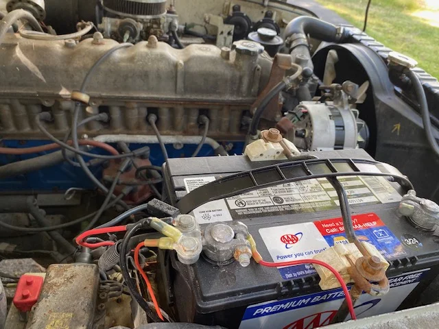

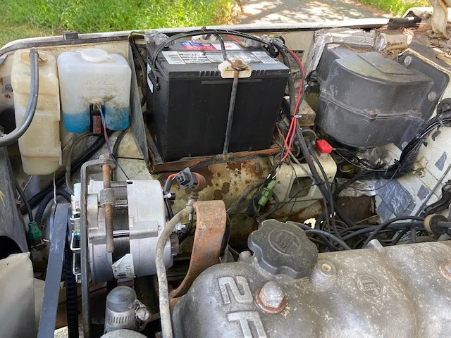

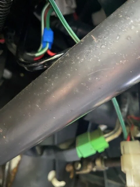

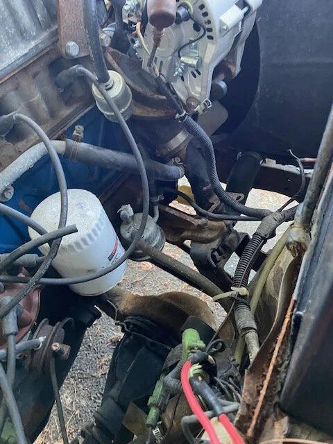

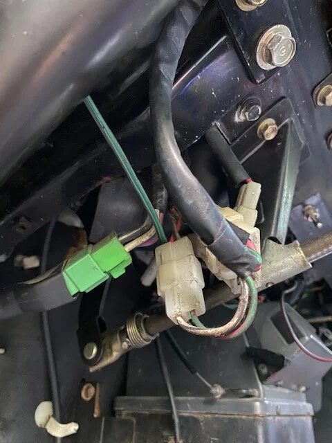

It is a 1979 FJ55 -- I am attaching photographs
Are your terminals clean and tight? Look at the cables, corrosion can crawl under the insulation rendering them nearly useless. Have your battery load tested - you could have volts but no amps to do the work.
Know any car people? They should be able to help you figure out what is wrong in like 2 minutes.
Those battery terminals are likely corroded under the bolts. Remove the neg, take it apart and clean. Then do the +, put it back on then the neg.

I would replace the positive terminal to start, you need a good contact on both post and those clamp style terminals are good for emergency situation.
Check all your ground connections for corrosion too.

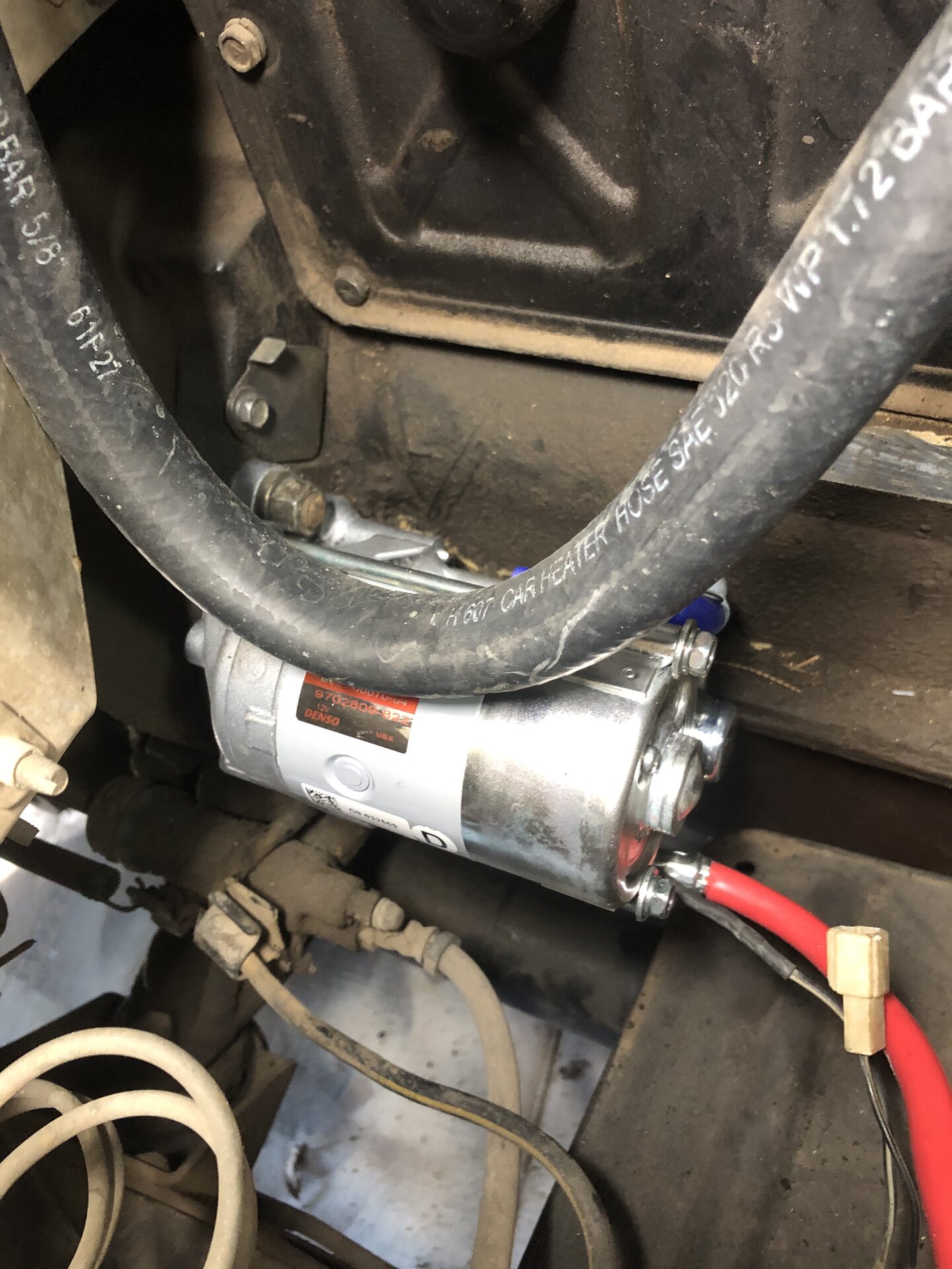

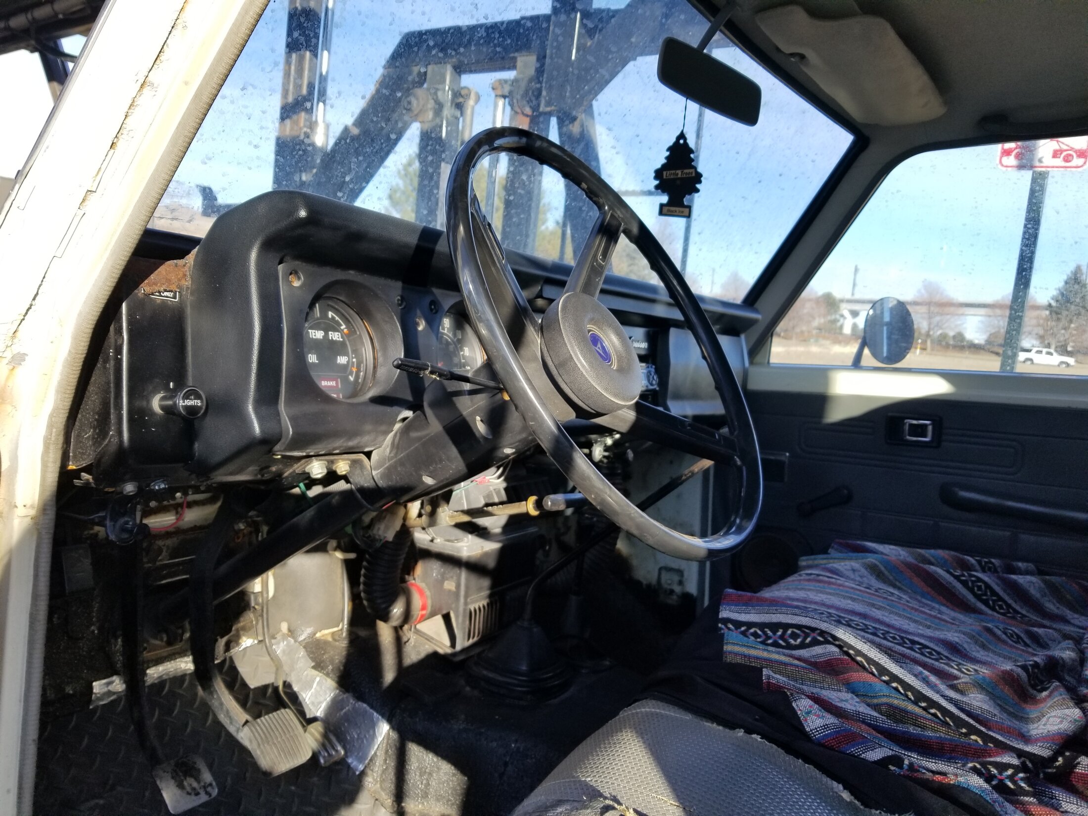

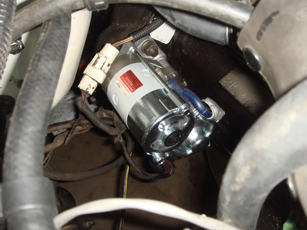

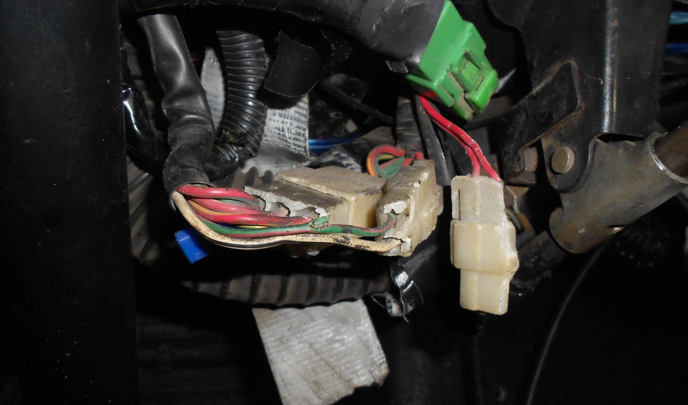

Lets focus on the New starter you had replaced a few months ago and also your steering column mounted 4-wire Electrical Key switch that has the 4pin green plug on the end coming out of your black plastic column clam shell upper column covers ....
- more then several Detailed and up close and personal Photos of your starter where Both the B+ battery cable Lug bolts on and also the factory Black w/ white tracer stripe plugs into / clips on to the rear of your starter same area as the B+ battery cable
- these system parts and wires / circuits are directly related to each other and a solid place to FSM format : inspect , confirm and verify
- note : please take a moment and wipe off any finger prints and Land Cruiser stuff from all your camera phone lenses , this does make a difference in every way you might not think possible ? like color coded tracer stripe correct accurate visual Confirm and Verify .......

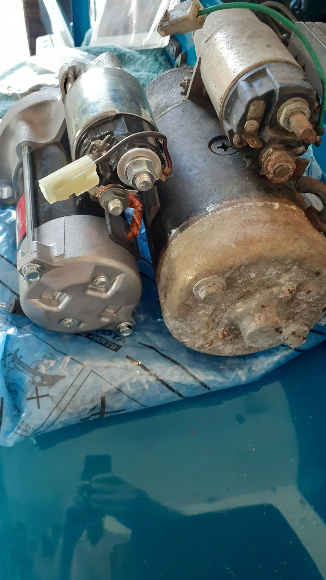

the below is a 1/79 FJ55 that came to live at my shop as its 24/7 care taker for the owners many years ago , this is a day 1 example of how i got to know my special Girl
BIG YELLOW :D
thanks
below these this is what we need to see well , and from different angles , underneath , top side etc ....

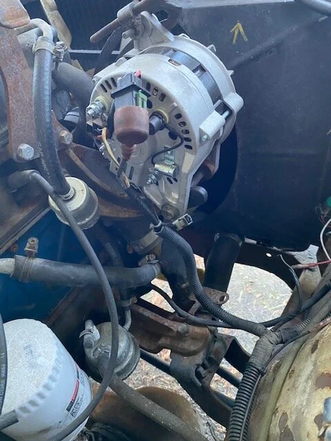

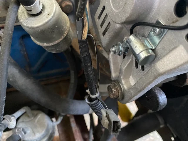

your above photos are very good ! this is how to approach any future tech topics you may have , introduce your thread post description of what ever topic is at play and then post any and all on-topic photos below that
then you will have given the best possible starting point for fellow members to help you help your Most Excellent
POLUX OARNGE FJ55 :D
we still need the up close and personal ones of your starter motor top side and bottom to see clearly all electrical connections

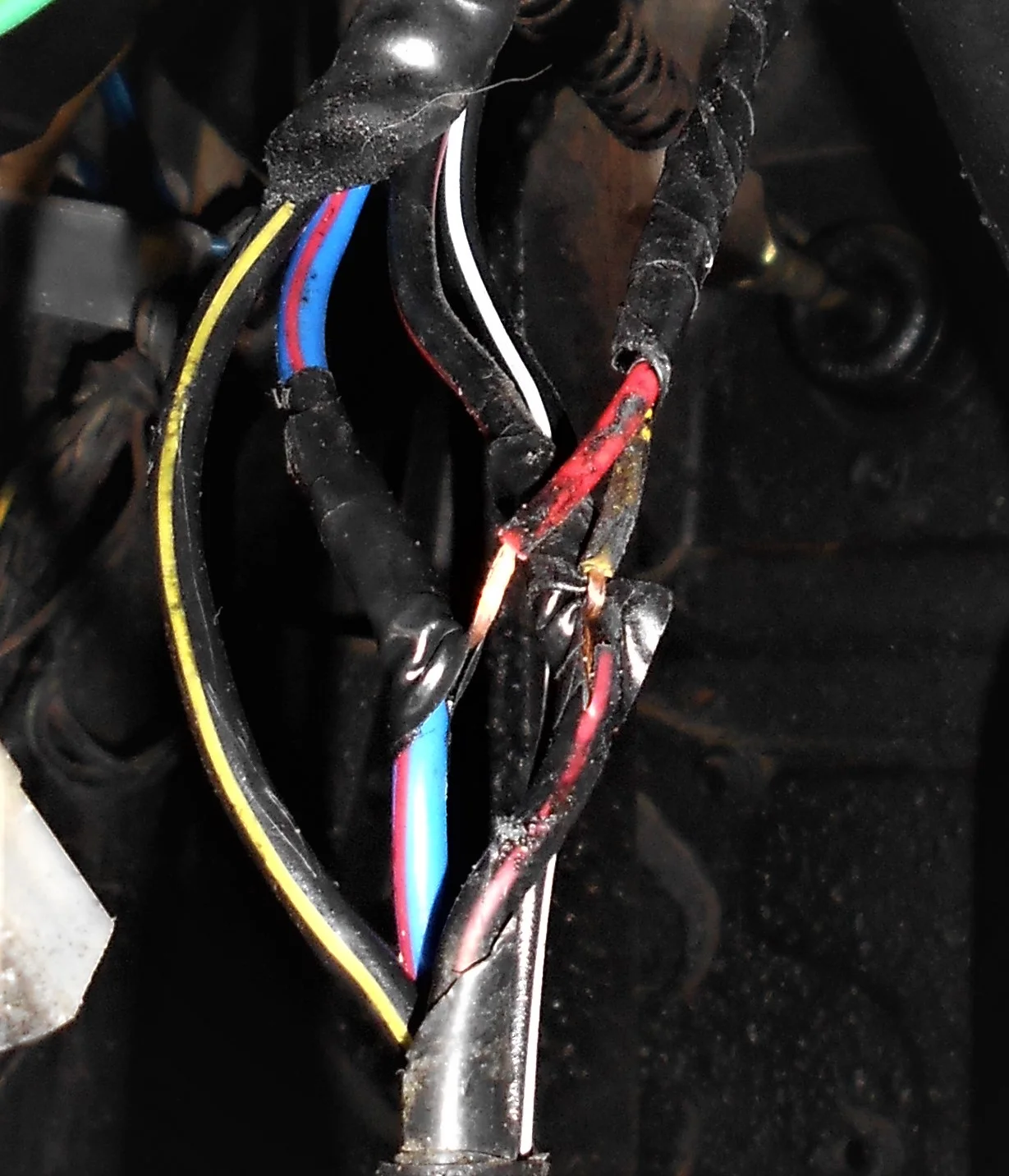

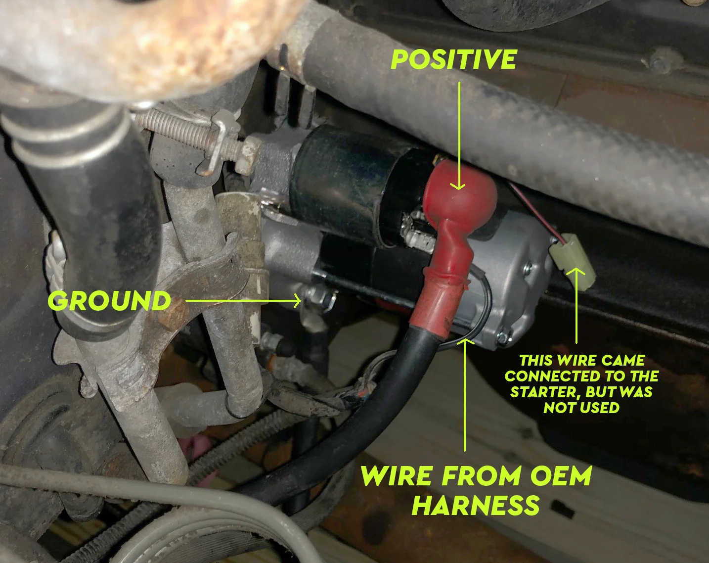

see my additional example same in exact kind tech photos below 3

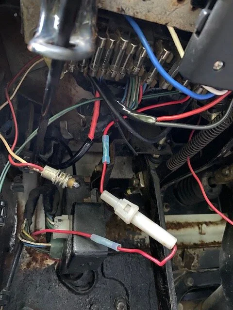

Whats going on with these extra fuses?
Am I seeing things, or are there a bunch of extra fuses squeezed in between each pair of holders??
Id start by checking that you have 12v at the fuse box, and at the ignition switch connector, and at the coil when switched on.
Download the correct electrical diagram for your year (search it here somewhere), buy a multimeter if you don't have one, and start hunting for the broken connection.
Good eye. That would complicate things, but would also explain a weak battery.
