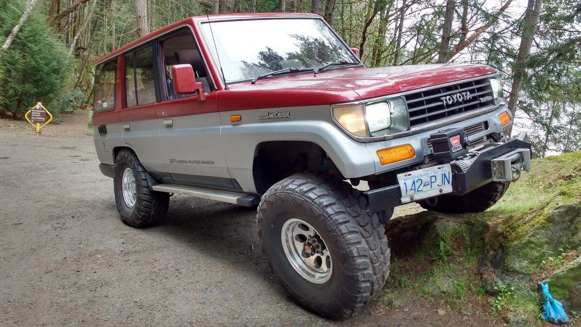

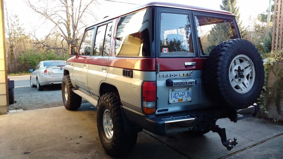

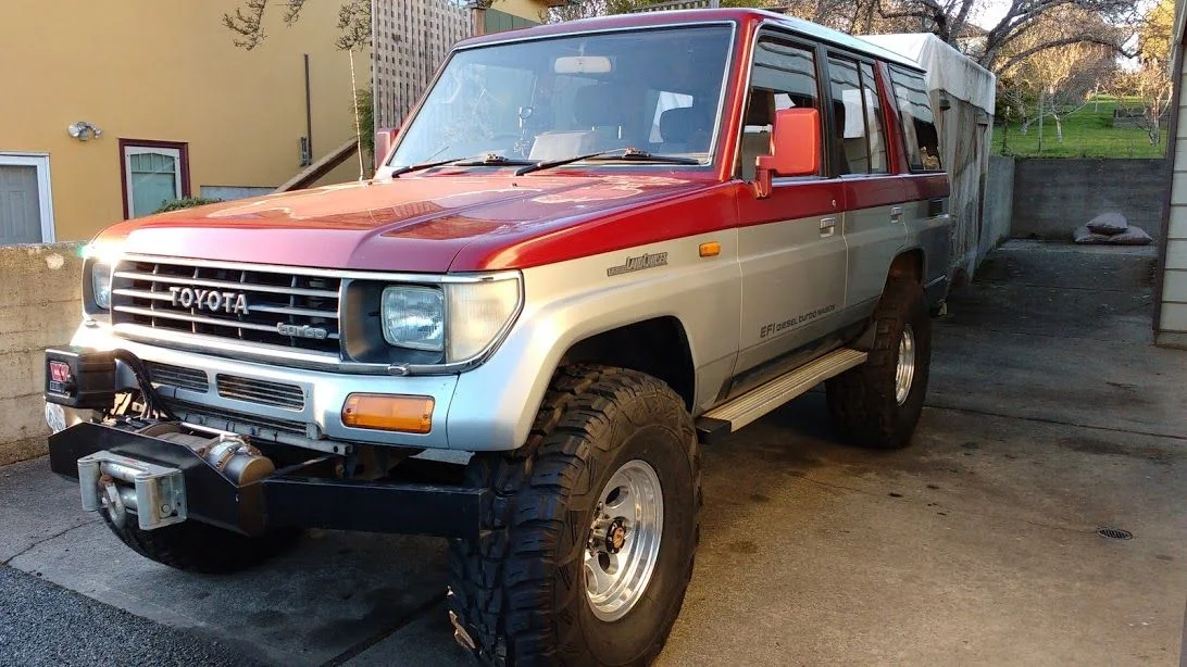

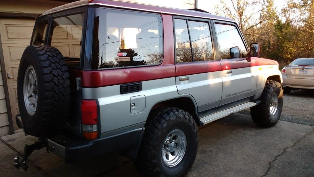

Picked up those Kumho MT 35x12.5R15 that were on used vic. They were on 15x8 alloys with -27mm offset. With some helpful input from a fellow in NZ who owned the same rim size and tire, I discovered this is the perfect rim size for running 35s an LJ7x or KZJ7x. I probably would have been better off with 33s, but where's the fun in that?
The tires and rims were literally purchased new and never used. Were in storage for the last 4-5 years. I figure I got them for about 1/2 new price or less. My 235/85R16 Duratracs are getting around 50-60%, so new tires were on the menu in the next year or so anyhow. Running these will extend my use of the Duratracs, which I'll keep for camper trailer towing duty and snow. Kumho MT maybe not my first pick, but seem to have generally ok reviews. Beggars can't be choosers, lol.

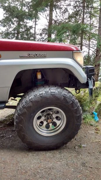

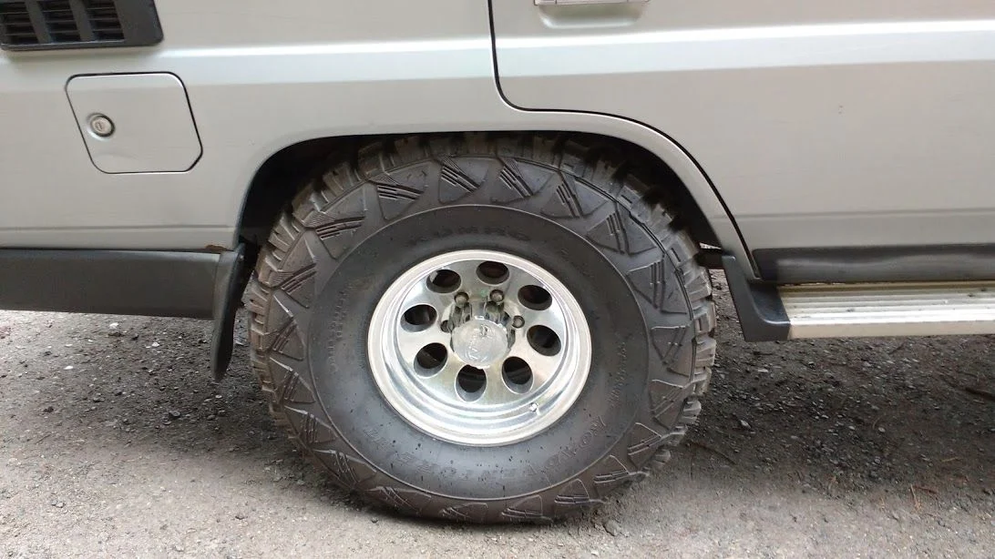

I had to put in some 1" coil spacers on top of my 2" Dobinson front coils. The rear OME's were already tall enough. Tires clear the radius arms perfectly. I had to 'massage' the inner fender liner at the back of each front wheel well to prevent rubbing at full lock. Also had to remove the front mud flaps. No rubbing now, but will see how it is when wheeling at full flex while turning. May need more lift yet to get the tire to tuck under the fender at full articulation.... Might also have to come up with some fender flares or rubber strip to keep the tires from flinging mud. I'm at about 3" of lift right now; but I think 4" would be more ideal.

Rims are an old school design, but pretty commonly available these days. They were bought new at the same time as the tires.
Wife is embarrassed to be in or drive my cruiser now. Something about "extender"....:lol: She doesn't seem to appreciate that these brand new condition tires and rims cost less than my last set of 32" duratracs on sale. Can't win, haha. Maybe I should paint the rims black.
Oh dear. Im not sure black paint will make things better but what's there to lose at this point?
Did some urban wheeling to make sure the tires actually tuck in ok without rubbing (before I embarrass myself on an actual wheeling run). My front radius arm caster correction bushings limit front flex a lot....which might be a good thing, as they may prevent rubbing under these conditions. Still would like to try some 80 radius arms at some point - as they have naturally more caster correction, so could run the much more flexible OEM bushings. Anyhow, definitely no issues. Rears tuck in nicely.
