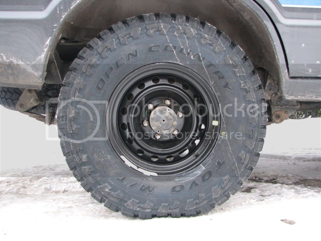

I had a blow out one of my Yokohama Geolander A/T just before Christmas. Now most people would be upset getting a flat in a snowstorm when it's -10 but I was pumped! as it gave me an excuss to order the tires I have been eyein for some time!
I got a set of Toyo M/T 255/85/16 mounted on 16X7 Factory Toyota steel wheels they are Tacoma and Sequoia spare wheel rims. I ordered them from my local yota dealer $80 each! can't beat that! and I got the tires for $245 each Canadian of course guys!
I tired them on the truck but the rims where just touching the Tie Rods so I bit the bullet and got a set of Mr. Gasket 1/4 wheel spacers. I dislike wheel spacers.
The Tires arrived and I got them all mounted up and so far so good no rubbing when driving around town and they seem to be as smooth and quiet as my A/T's I will try to flex it out sometime to see if I am going to have contact anywhere.
I was a little nervous not sure what the Black rims would look like on the Blue truck but I am very happy with the way it looks! I think the truck looks so much better now! I always felt the 32X11X15 looked too fat for the truck ( they came on it)
I like the rims.:D

Nice Rims/wheels..do you happen to have the part number for them?

can you let us know the part # and how wide the wheels are in inches? I see that these are 16 inch wheels

The rims are 16" X 7"
The part number of the rim is - 42601-AF010
You will also need the 1/4 Mr Gasket wheel spaces for the front to clear the tie rods can't remember the part number maybe 2376? I am running them just on the front but think I will put a set on the rear to even things up.
