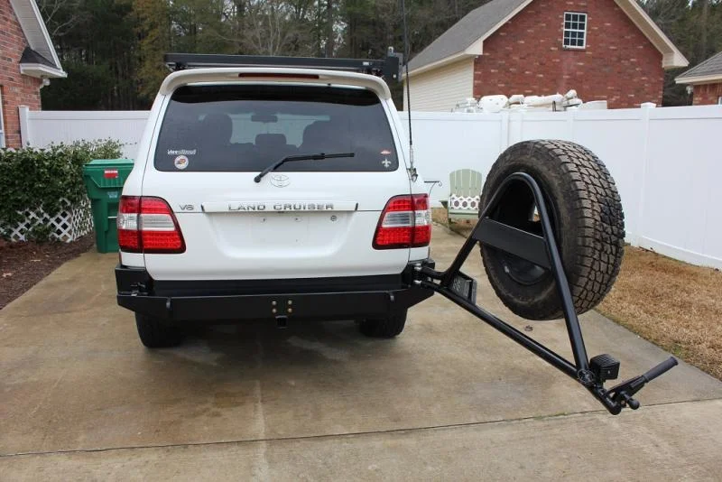

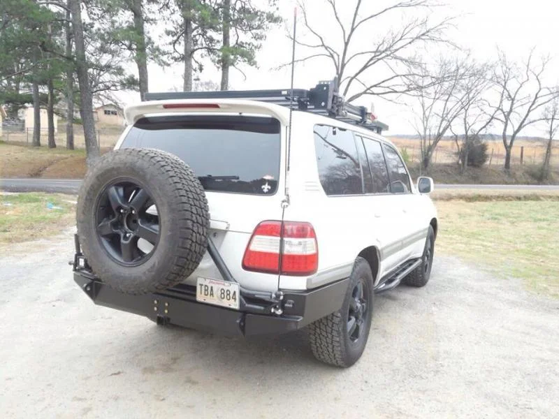

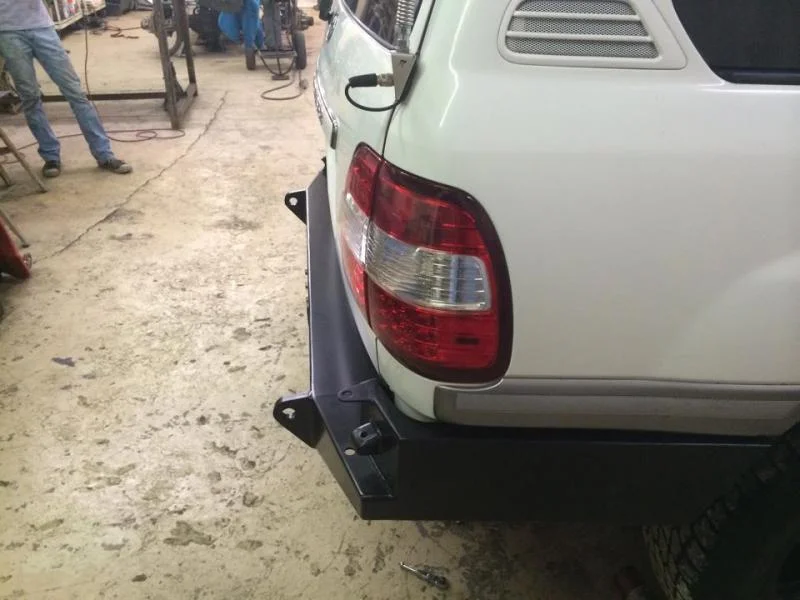

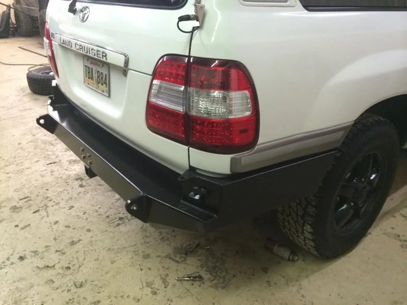

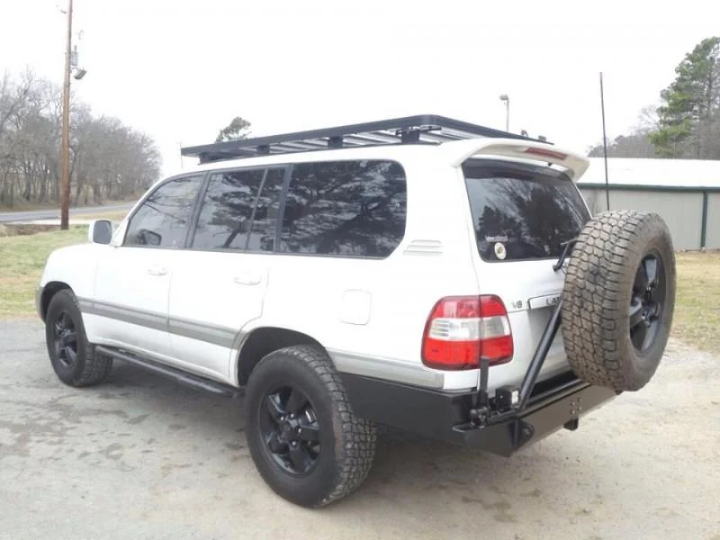

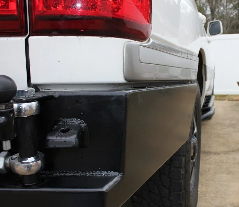

First off with the bumper only, no swingout. I really like how close it hugs the body. Departure angle is really good.

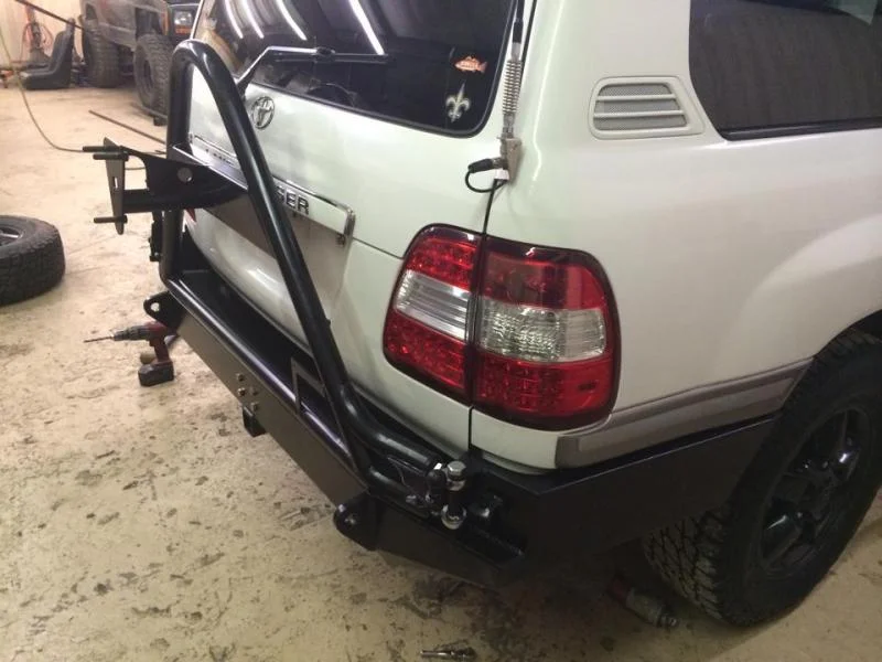

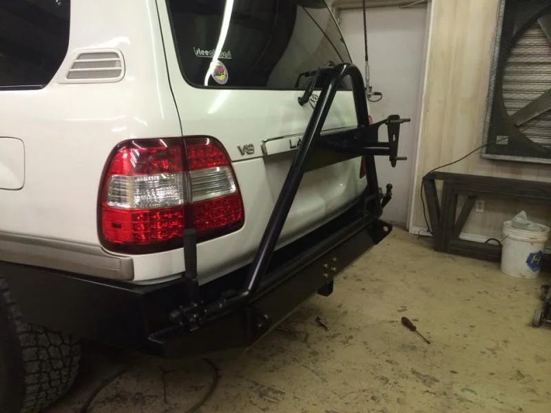

Also a couple with the swingout sans tire.

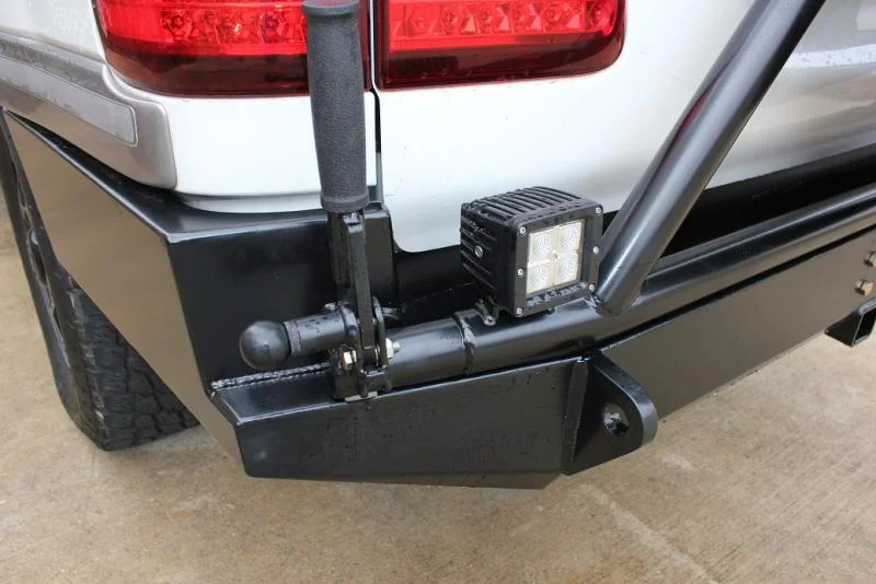

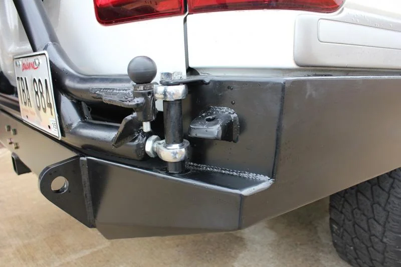

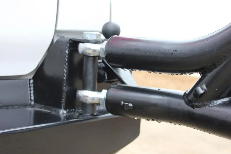

Couple of the latch and pivot hardware.
Latch is really slick...opens easily, and can be closed with one hand.
Swingout arm is long, but glides open and closed with no issue. There is a locking pin on the backside that locks it open when fully extended. You can easily unlock the pin and close the arm without walking around to the passenger side of the truck, which I really like.

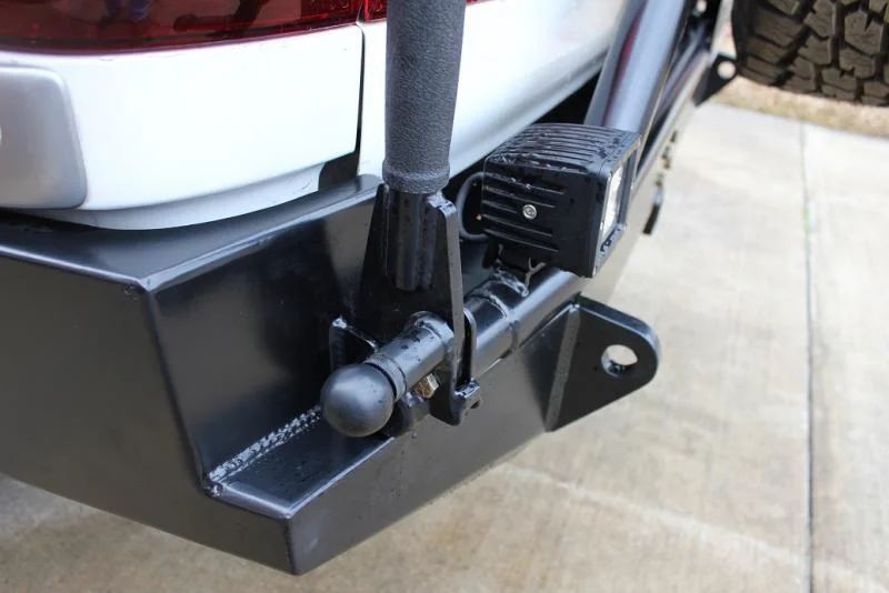

Couple things that I asked Chris to add in along the way that I'm real happy with are below. Tabs running the full length of the swing arm, so that when I run my wire loom to the AUX light, backup camera, and license plate light, I'll have a lot of tie-wrap points to keep things clean.

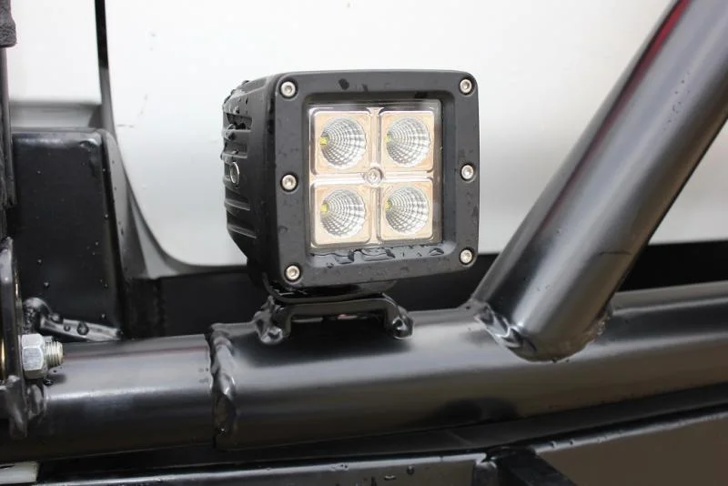

Second is a mounting point for one of Nick's Cube LED's. Going to wire this into my reverse lights, as well as switch it for use on the trail.

That swing out swings wide... get out of the way! Looking at it, I now know why most rear bumpers have split swing arms.
Yeah, it's long, but not as long as it looks in that picture. That's a bad angle.
I actually thought about this a ton over the course of a few months before I decided on the single arm.
I am in and out of my cargo area fairly often, and wasn't too excited about having to work two swing outs every time I needed access. So the convenience of a single arm outweighed the shorter swing for me.
Yeah, unlatching one arm is better than two.

Sweet lookin' bumper man, seriously. :grinpimp: You must not pull any trailers then, as the other side to that single arm coin is access to the back when one is hooked up. There's no way that would clear my camper battery, or utility storage box, or motorcycles... but I don't plan on you borrowing either any time soon so I guess we'll be ok. :cheers::popcorn:
Ha, you're right. The arm actually clears the top rail of my trailer when it's hooked up, but won't clear anything that's loaded on the trailer and higher than the rail. Oh well...
