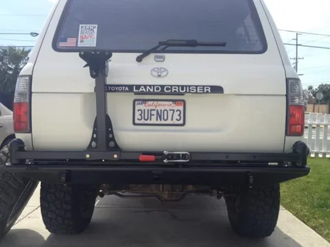

Attempted to install the tire carrier but the holes on the carrier wouldn't line up with the holes on the swingout. It looks like some welding slag combined with thick powder cote is keeping the bolts from passing through the swing out. It looks like the bracket for the tire carrier may have distorted slightly during welding compounding the misalignment.:mad::mad:
That stopped me for today. Tomorrow I'll have to regroup and start fresh.

I started with an expensive carbide sawzall blade and it seemed to cut very slowly. It smoked a bit and seemed to be melting its way through rather than cutting.
I switched to a standard metal blade and it cut great! I think I used five blades total; four long and one short.
Then I used a grinder to clean up where the cross bracing of the rear member was cut off and then a flapper wheel to smooth out the grinds and remove some rust.

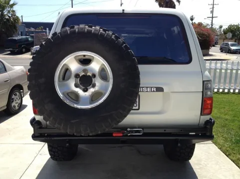

Had to drill out the holes in both swing outs and had to enlarge the holes on the tire support but I got it to work :-)
Now I have to find my spare lug nuts and get the tire mounted!
Sent from my iPhone using IH8MUD
Damn that 35" looks big on the carrier. Was going to respond the previous post telling you that the spare lug nuts were in storage! :flipoff2:
