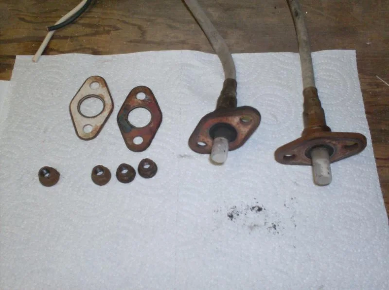

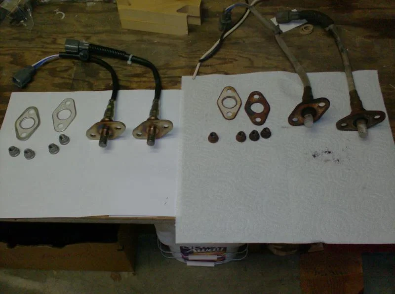

Pictures of old sensors:
O2 Sensor Replacement - a photoset on Flickr
