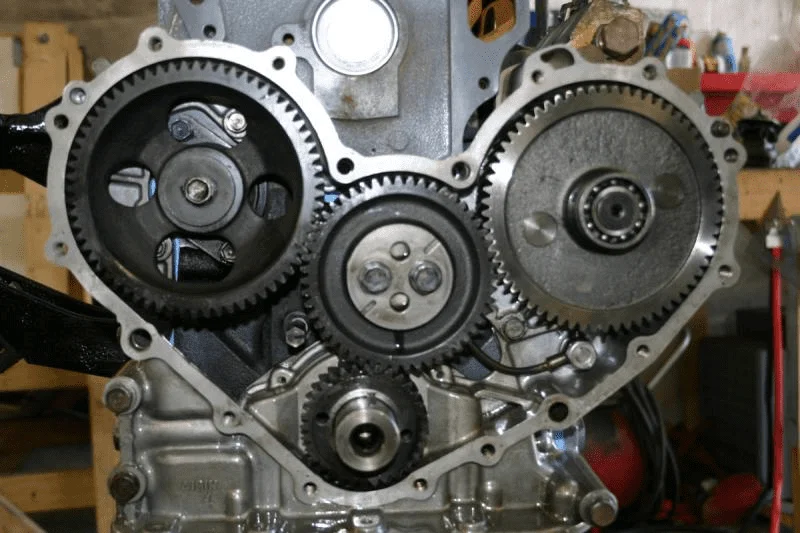

Hi Rosco,
Thanks for the info, one more question about the diesel engine, does it have a timing belt or a chain? I read somewhere that these engines have timing gears, which do not require maintenance. Can you confirm this is true or false.
On a side note I took a look at the engine oil level today, the level is in the middle but the oil is so black. The previous owner must have ignored oil change and I drove 600 miles on that black oil. Going to the shop to have the oil changed tomorrow and fix the original a/c unit which it came with.
Im prety sure the 2B has iming gears. 3B gears below. On these kind of diesels the oil goes black in about 10 minutes, so the PO may have well done the oil changes.
:bounce: @roscoFJ73 Thanks again you're very knowledgeable with this, makes me feel better about the black oil. I'll see what it's like after the oil change and driving it around for a little while. And so happy to hear about the timing gears, this is so awesome that I don't need to worry about that.
