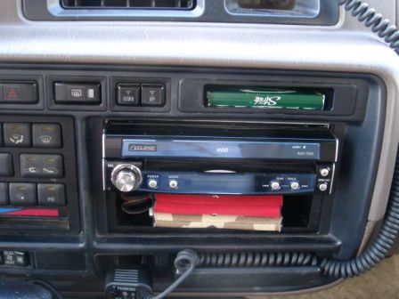

Is is normal for your head unit to stick out like that or was that something you did to make it stand out? I am in the process of installing a head unit that works in the same way and I'm kinda worried that when the head unit is fully installed that it won't clear the dash properly! That's why I asked if you did this on purpose and if you did then what exactly did you do!
It does stick out that far on purpose, I can't go into to much detail on the installation as I had someone do it for me as I had the navigation, speakers, amp and alarm system all installed at the same time. I can tell you that when it is open there is room for it to tilt back towards the dash so it is a little easier to see. I will take a look at it a little better and try and get some pictures for you.
