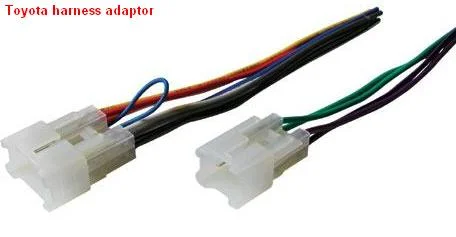

For those who have done it, did you get a specific wiring harness or did you just cut and splice into speaker wires?
Thanks
Looks great BTW:beer:
subscribed
There was no splicing the OE harness at all. There is a Toyota harness adaptor (sold seperately) that will plug into two empty unused speaker connections behind the factory radio. Also make sure to unplug the factory amp that is just to the right of the glovebox. I forgot to to this and the new headunit wouldn't work until the amp was disconnected.
The harness adaptors are all over ebay and very cheap.

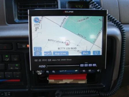

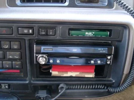

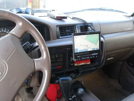

Here we go I think I have it now... I have have the AVN 7000 I had someone else install back in May 07 I love it. I went with the 7000 so that the screen would sit a little higher in the veh little easier to see I think at least. How do you get the screen to night mode? I have been looking but can't find anything.
