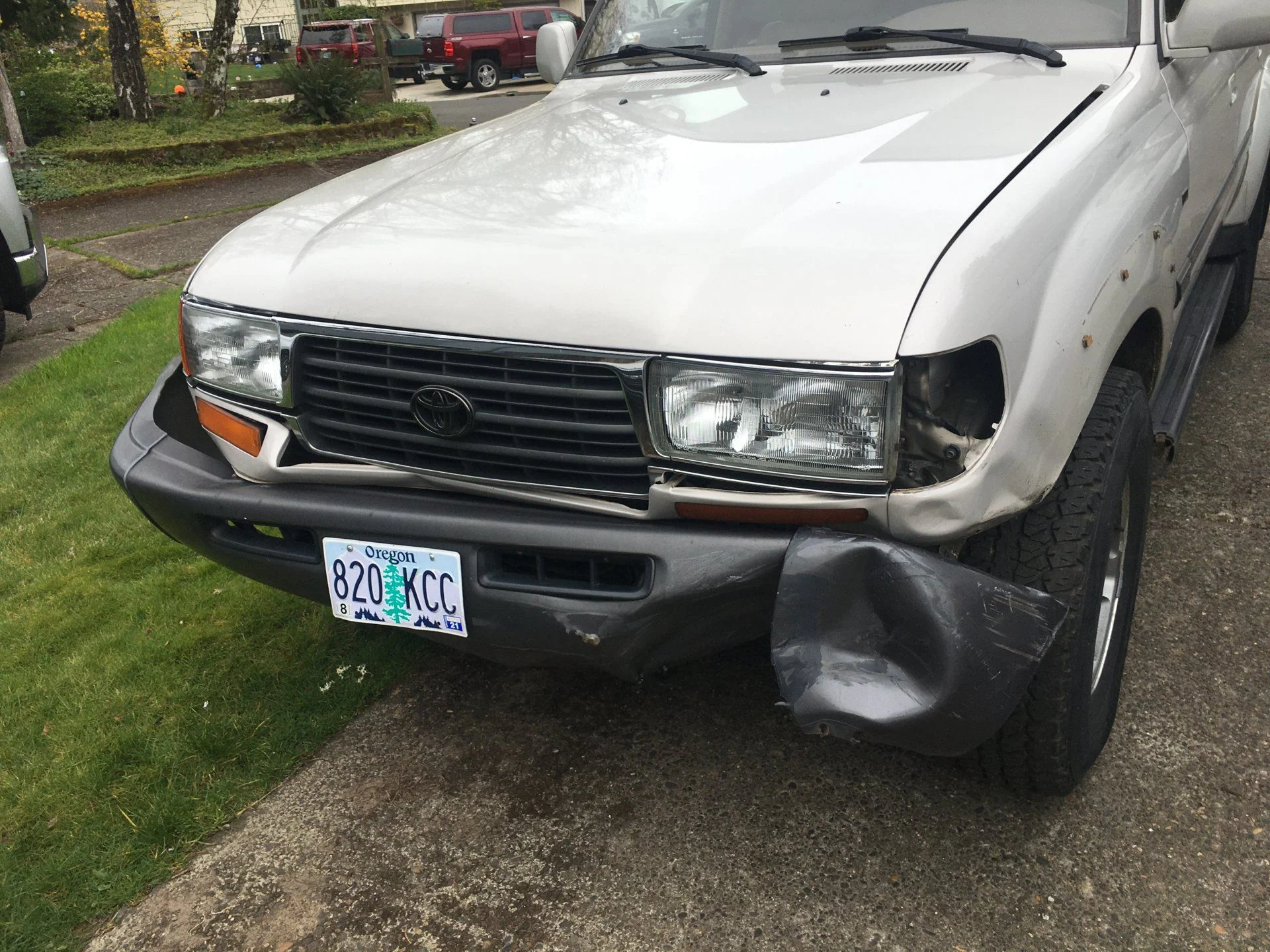

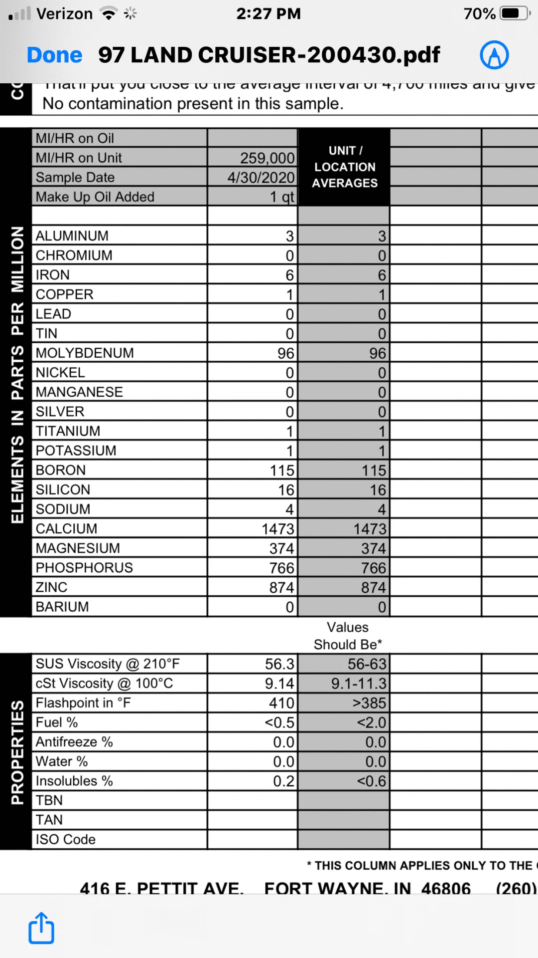

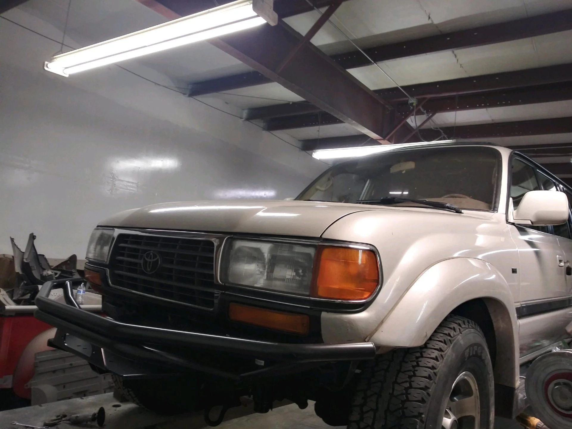

Just picked up a 97 collectors edition with 259,000 that was in a front in collision. It’s got decent service history, no head gasket paperwork and it does not look to be worked on that deep. I have a oil sample sent out to Blackstone have not received results yet. It is a factory triple locker vehicle in what appears to be awesome shape. Got it for a good price and was able to fix for pretty cheep with a body guy on the side. Going through the baseline stuff, cooling system, basic tune up, phh, belts and fluids. Anything I am missing?? Thanks for any input.

Really now Comet, do you have to scare the new guy like that? We don't all change our oil every 1K miles or polish our trucks to a mirror shine--ok, maybe some do--Al from Long Island :p What we do share is a a passion for our vehicles, and sometimes, that means our priorities do get mixed up. The OP is already baselining his rig, and did you see his original bumper? I think that front bumper install was a smart idea. I would even argue that new meats is super important depending on how he will use his vehicle (admittedly it appears that his Firestones have plenty of life in them).

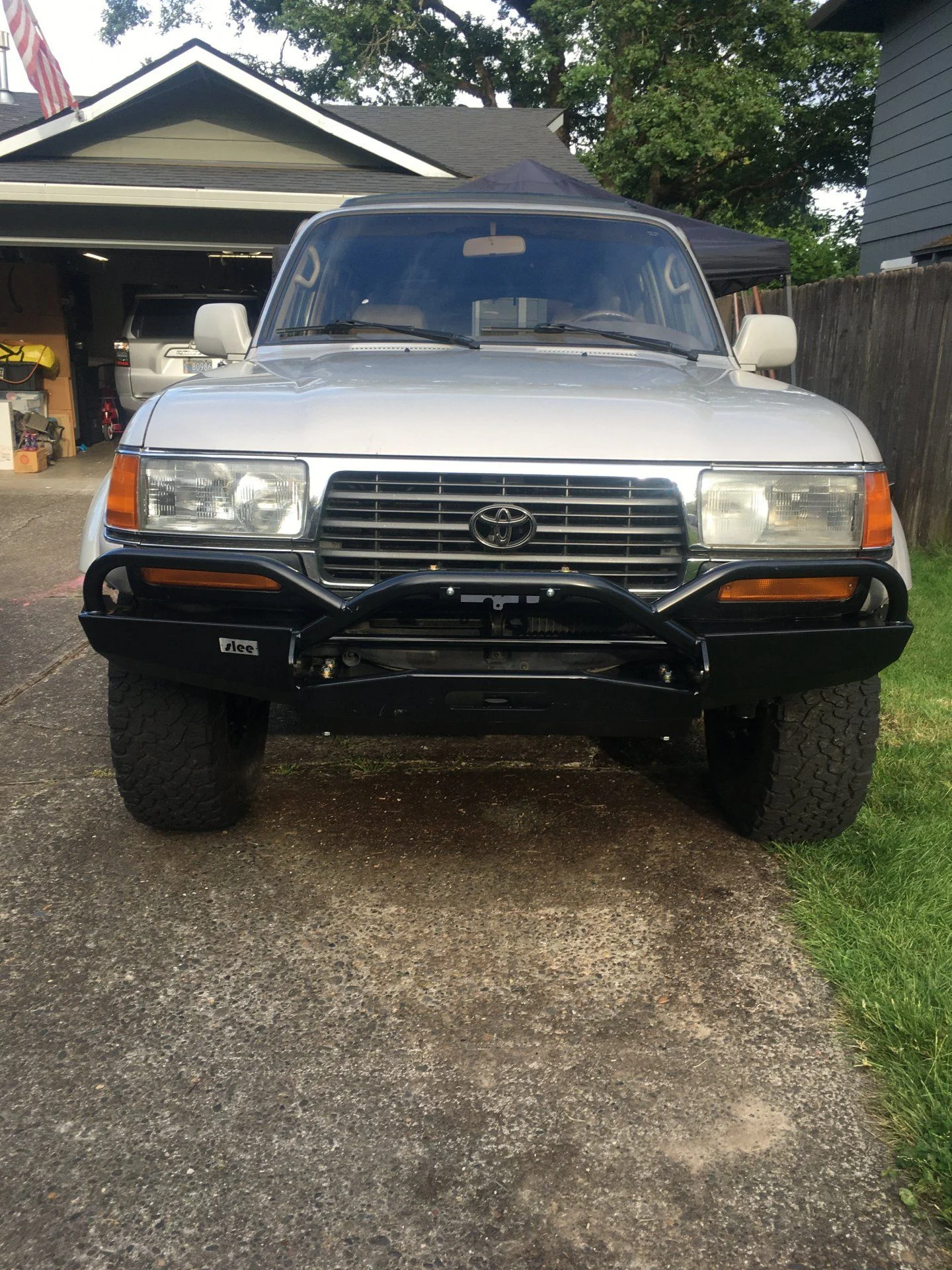

I missed the bumper at first glance. Agreed that it looks good there.

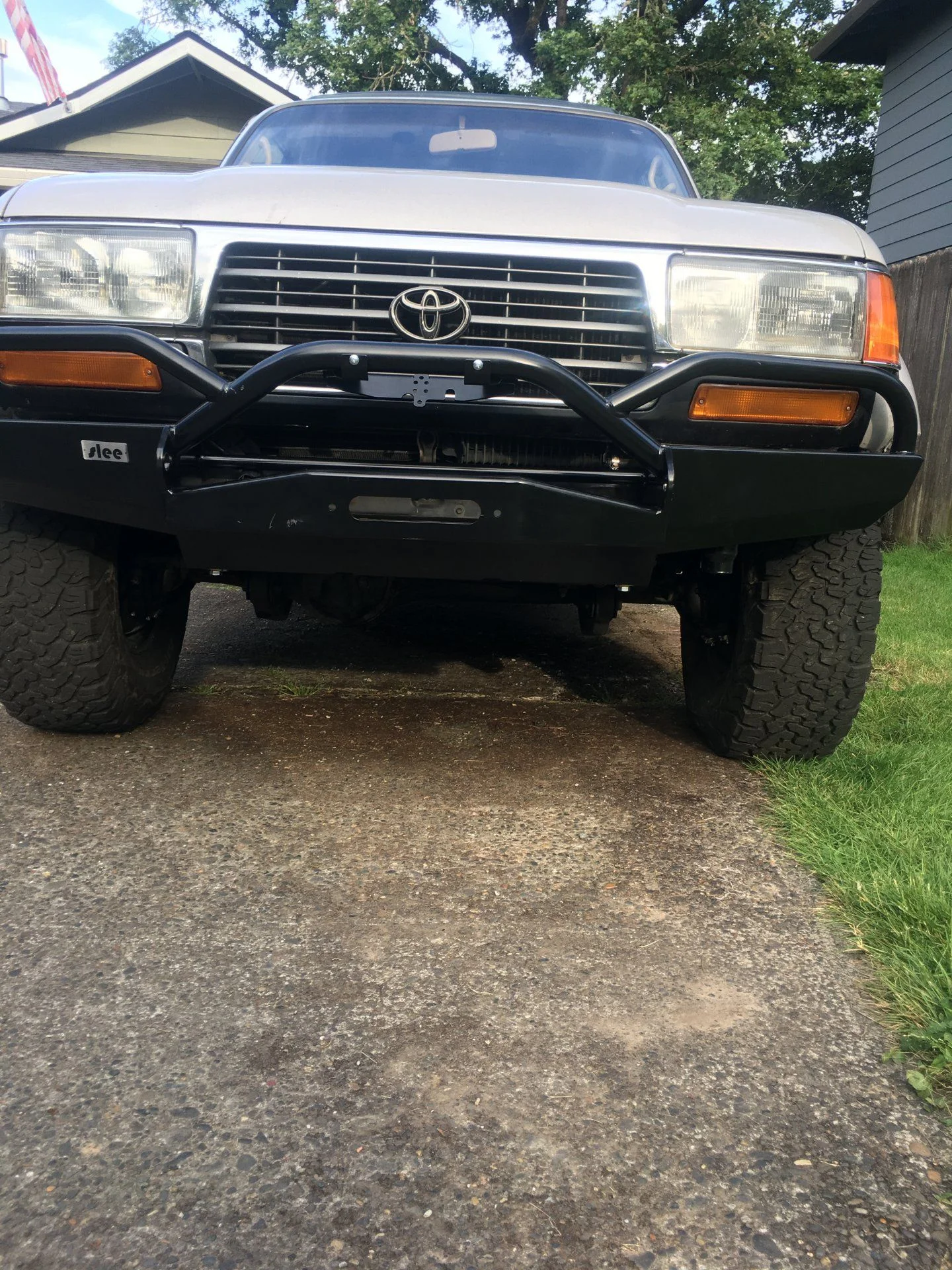

thanks everybody for the fast response, the trail gear bumper isn’t my fav but for 450 it can’t be beat. Witts end just got $300 of my cash for baseline stuff. And there will be much more I already have some nice 2019 trd pro rims with 33bfg that I’m gonna slap on. I’ll keep the pics coming. It’s gonna be a slow process with work and two young ones. Now I have something to bury my money in besides guns. 😁 witts end prices seemed decent for oem parts and I like supporting a local guy (Oregon) is there a vendor with oem better prices? Thanks again

So great news got my oil analysis back with a clean bill of health. No need to sweat the head gasket unless I don’t maintain cooling system.

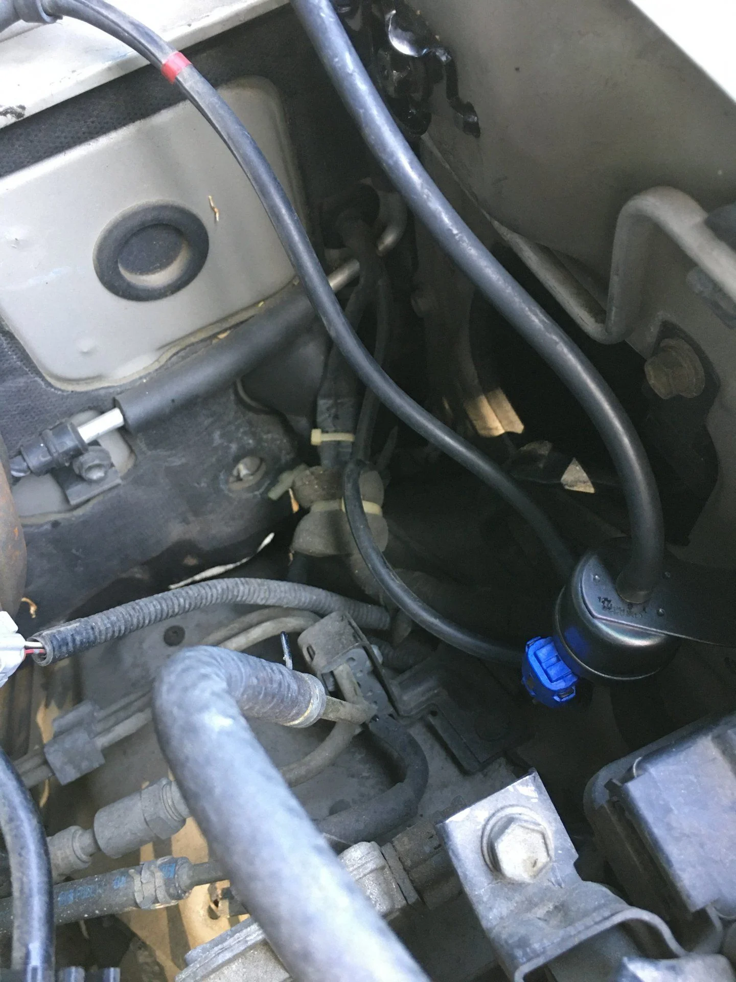

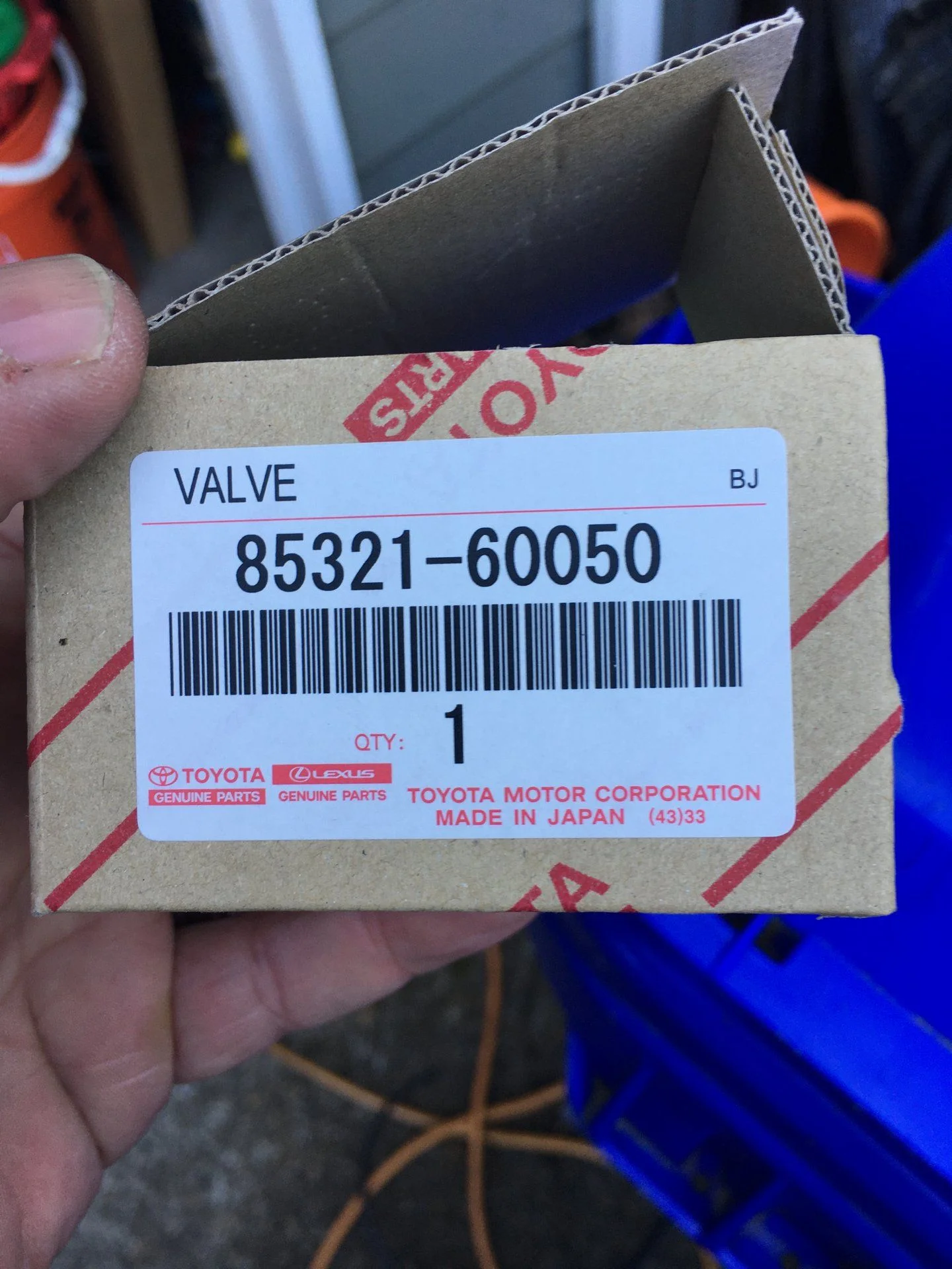

Also fixed a silly problem that was driving me nuts every time I used windshield washer I soaked the bottom of engine and firewall and did not get any water to the windows. So I did some mud searches and found it’s the diverter valve picture with part number will be posted. Easy 5 min fix and a little bit of coin.

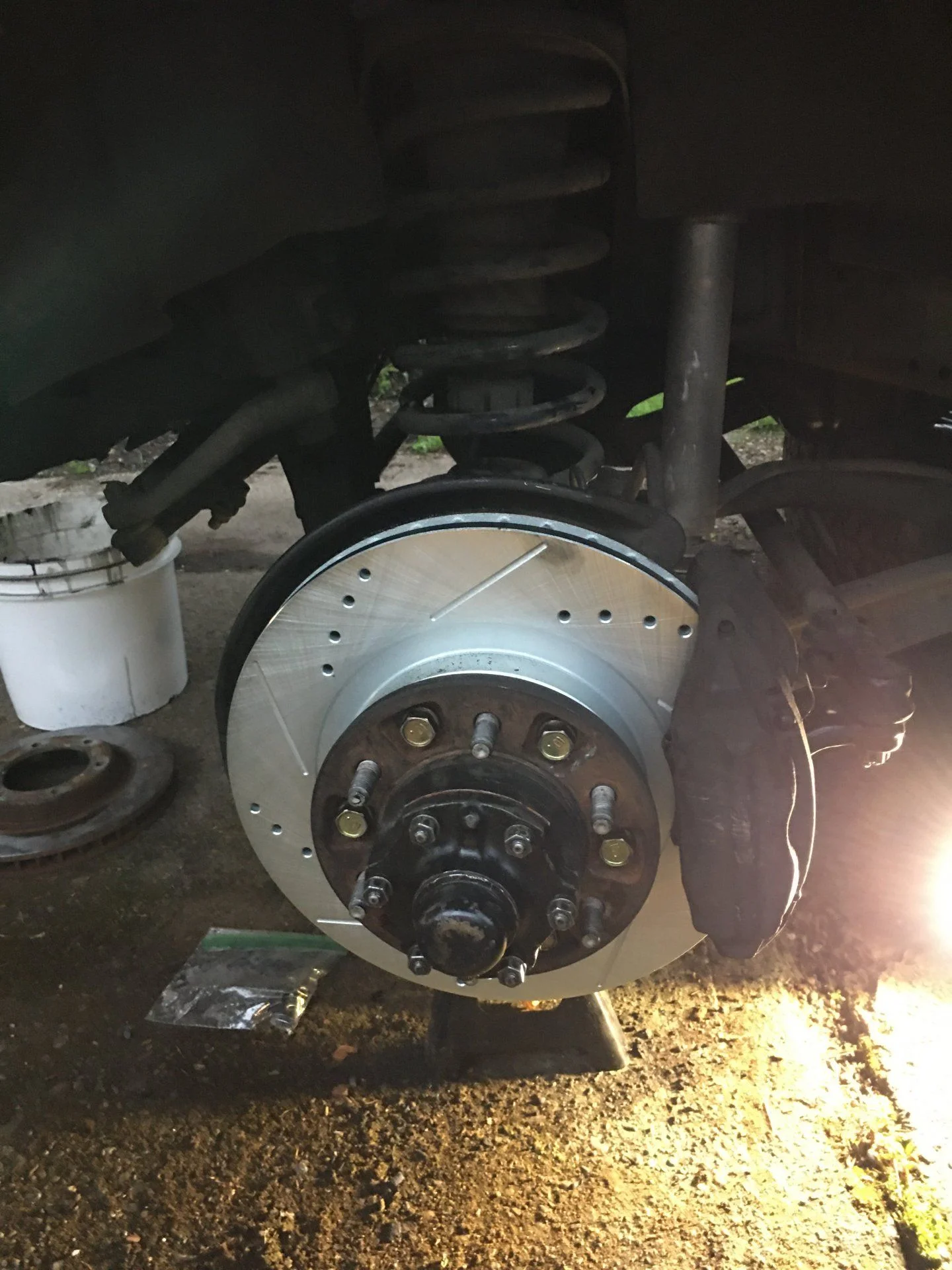

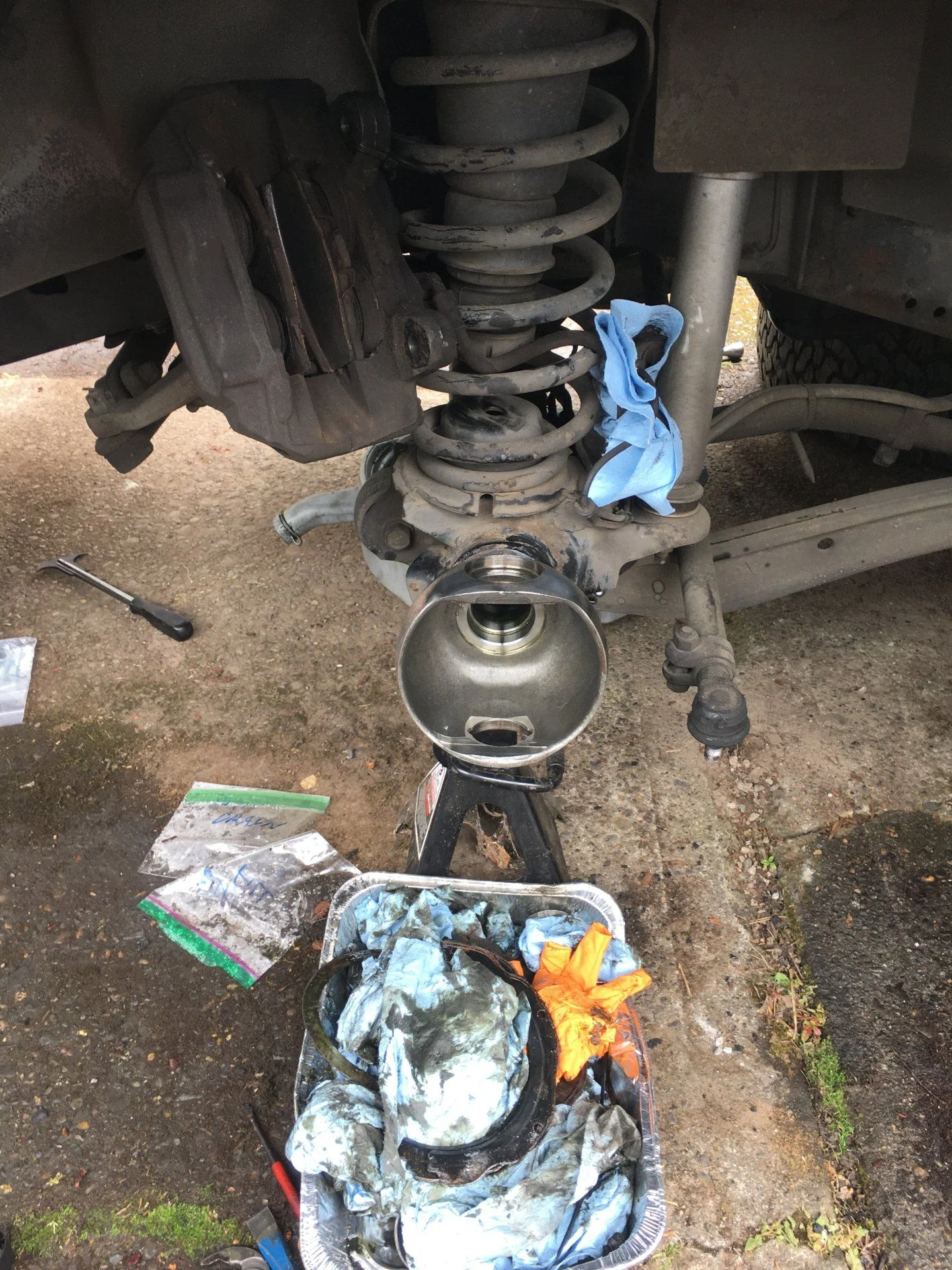

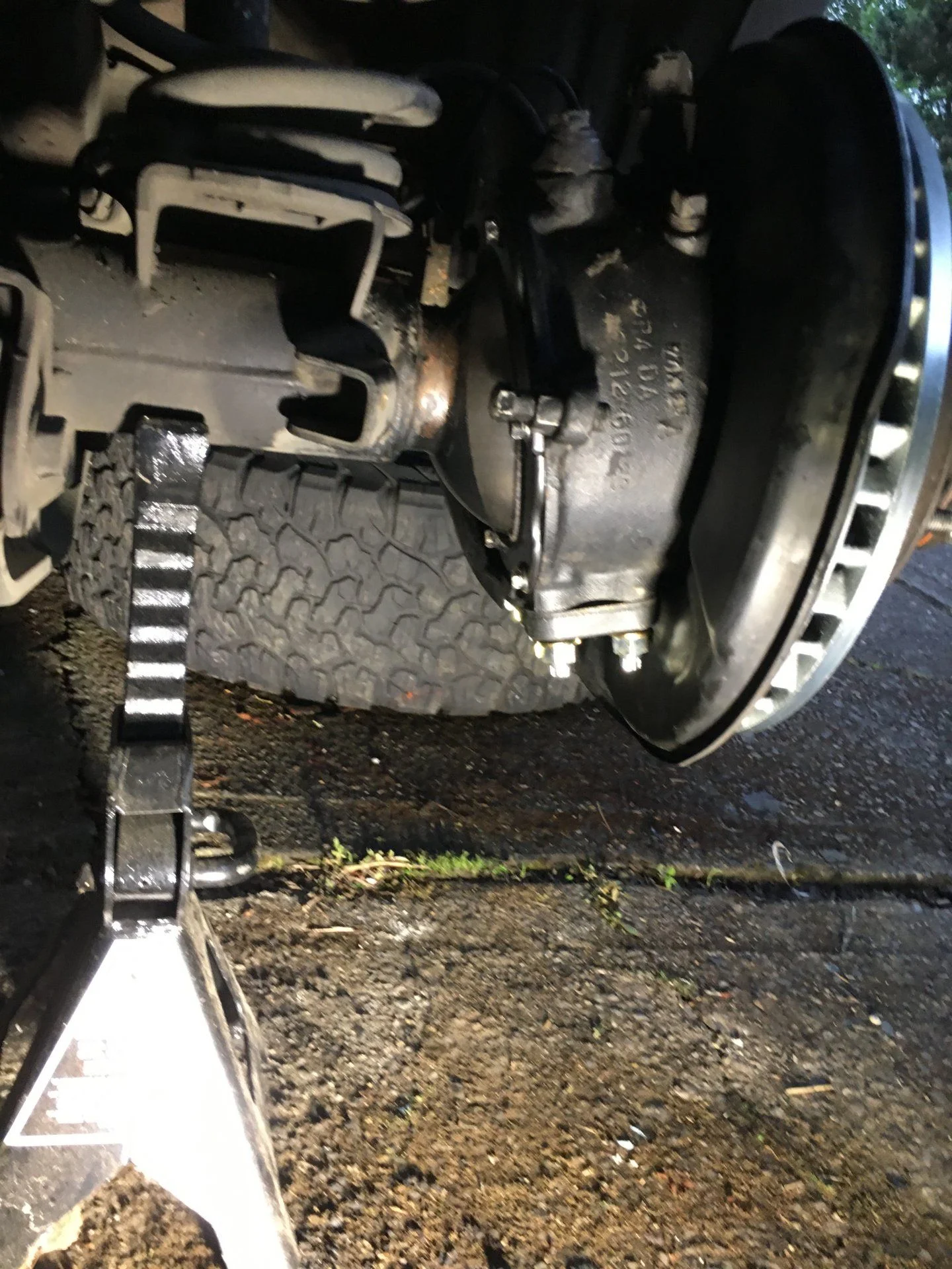

So still chugging along with baseline got the knuckles rebuilt, new fluid front rear and transfer case, new rotors pads front and rear, new bumper. Going to tackle cooling this weekend along with phh. What are the thought on water pump? Replace ? Looks stock do they wear out or have a way to test?
