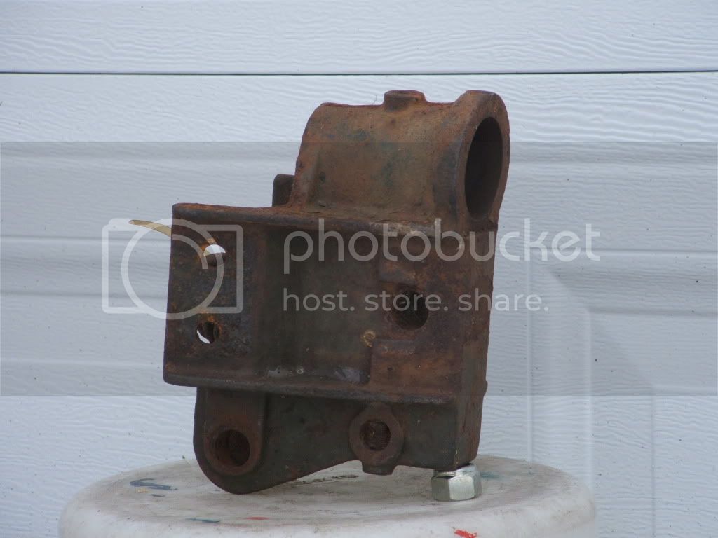

By the way have some stock trailer parts for sale if anyone is interested. $100 for either set of fenders and $150 for casting......
Hello boots Can you tell me the history behind this casting. I have a 1953 Strick M100 with a ball hitch and I want to restore it to original equipment Thanks. CJSL
I don't have the link on my work computer :bang: I do know I ordered them from a big trailer place in Texas. I got hubs and rings from them and it wasn't that expensive for the shipping. If any one knows the place im talking about please post up if not ill look tonight and let you know.
