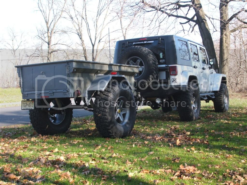

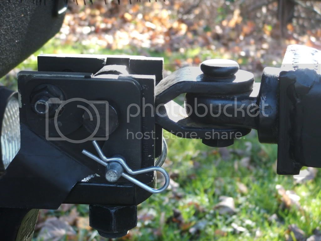

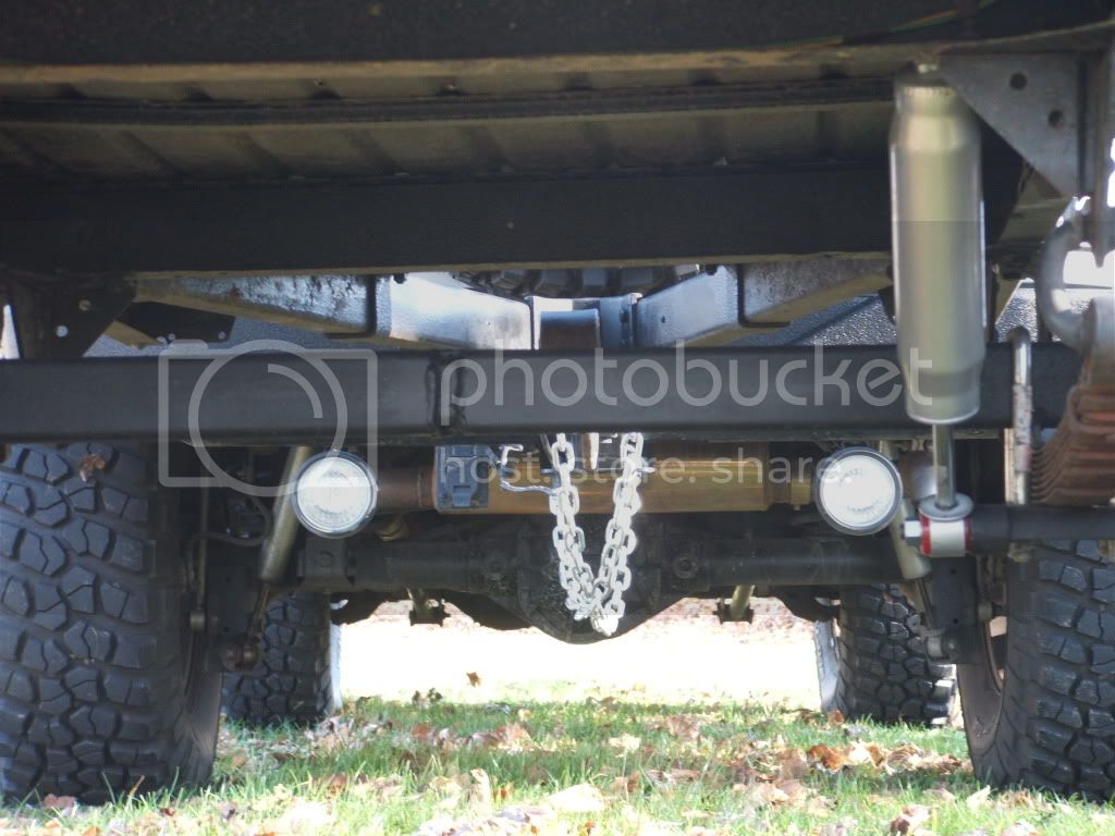

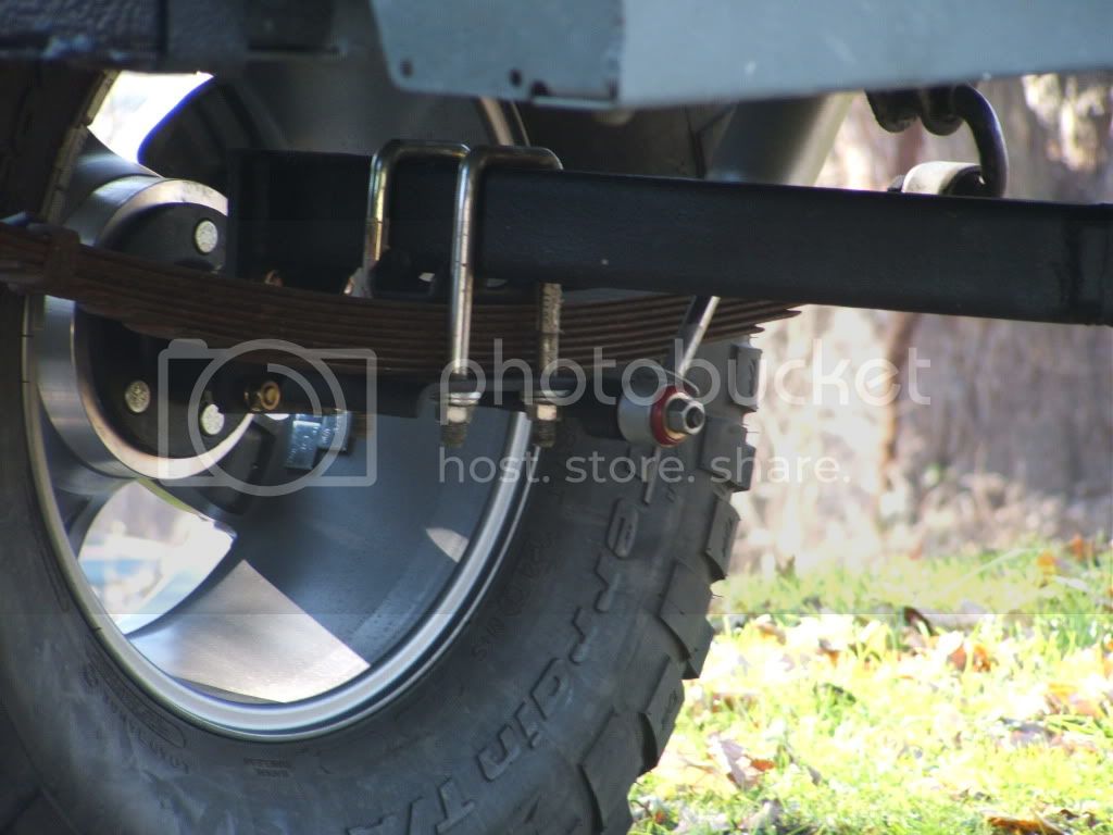

Thought I would update some things on this post. Alot has been done over the last few months.
Took a 4" droped 4500lb axle out of a car trailer, narrowed it by about 2 foot re-welded it back together, rebuilt the hubs and had spacers made to go from 5-5.5 to 5.5, then fliped it upside down and mounted it above the springs. Made a set of steel fenders at work out of 16ga steel.
Added shocks, a Lock-N-Roll hitch, 37" tires and AEV 17" wheels. Then re-wired the trailer with new Jeep style tail lights (not shown with the photo's posted) and fender marker lights. Also added a Jeep style tailgate that the posted photo's don't show.
Now I want to add heavy duty shackles to the rear of the springs. Just need to find out where to get some and what model jeep runs the same shackle.
Then it's off to the sandblaster befor paint and tonneau cover.

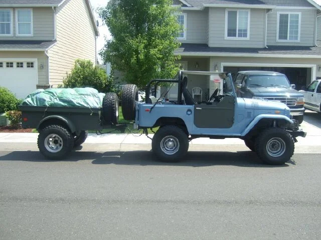

Trailer looks good. I like the color. I sprung mine over with 32x11.50x15s. It turned out pretty well. The matching lug pattern would be nice since you would only have to carry one spare, but to me, it really isn't that big of deal to carry a spare for the trailer. I still need to suspend my spare under the trailer. That's a project for this winter.

Congrats on the trailer! :cheers:

Wow, now that looks good. Would have thought by the photo that you had 35's on the trailer.
I am going to do the flip for certain, just don't know if Iam going to run 33's or 35's on the trailer. most likely 33's (running 37's on my JK).

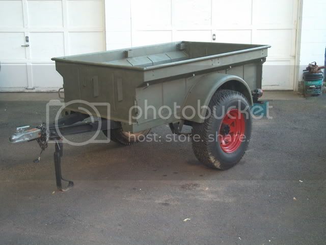

This is my M100 with new springs, shocks and 33 BFG's. Rides just a bit high in the back end when the truck is fully loaded. Rides perfectly flat when the truck is not under load. No spring over. I did some pretty heavy off road stuff in the last few weeks and it rode flawlessly. I have 200# - 300# of stuff in the trailer and I never know it's there. A couple of photos after the tung extension and with the BFG's.
