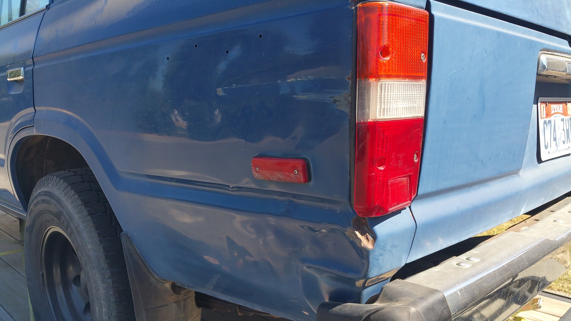

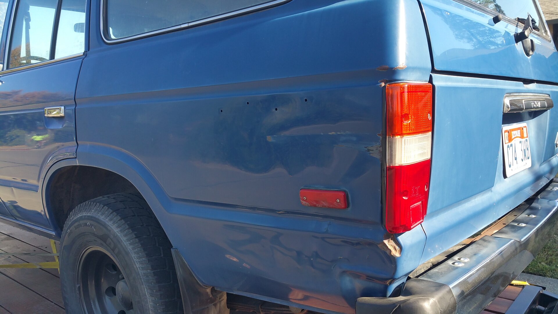

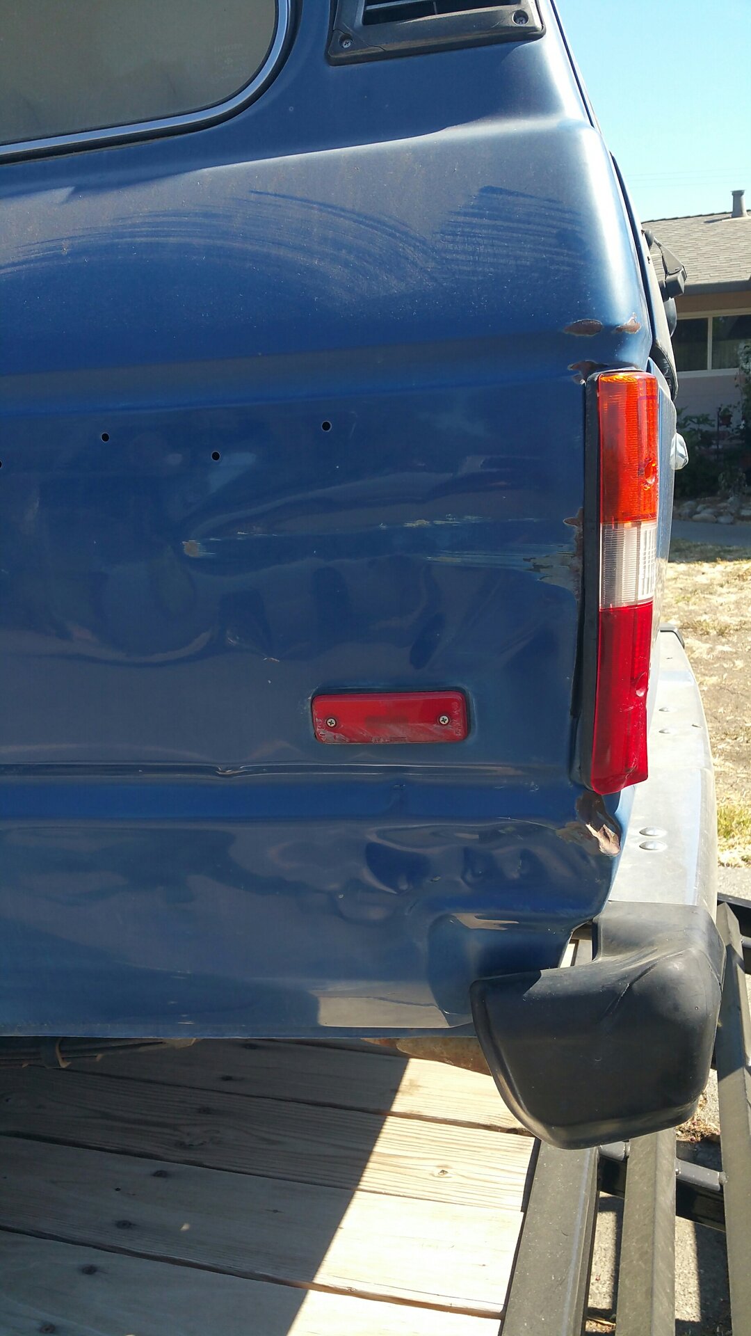

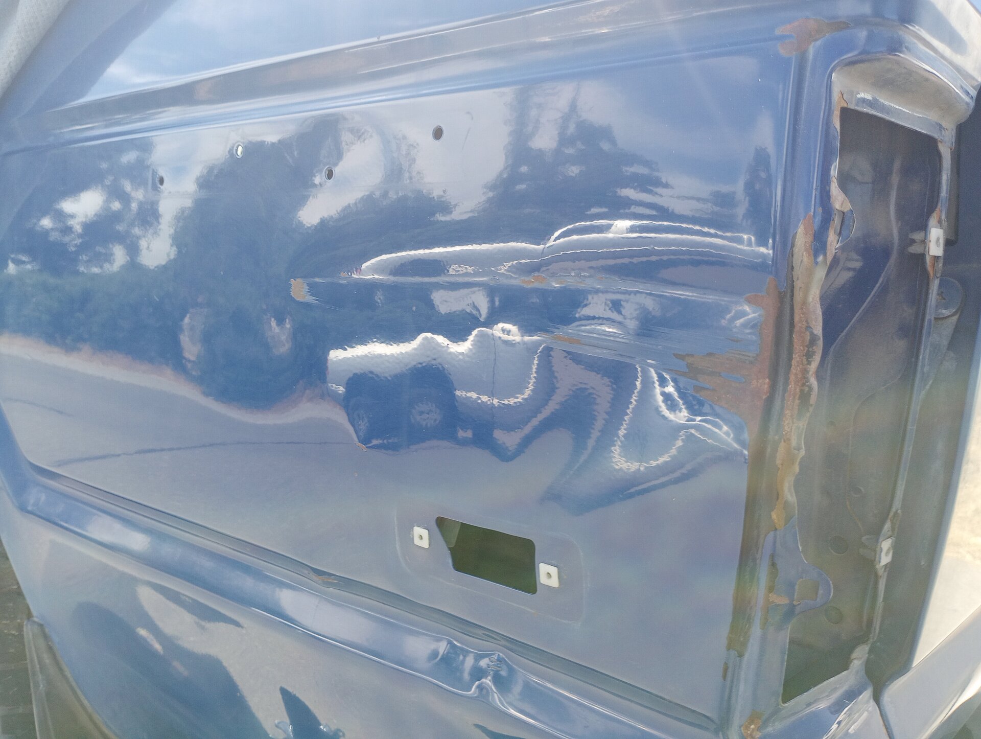

I have a question. The rear driver side panel is dented (Original Owner damaged). Should I have dent repaired or replace the panel? I have donor panel.

That’s not bad as far as dents go. Any collision shop should be and to fix that with minimal damage to the paint, or paint to match, depending on which technique they use. Nice color btw!
If the rest of the panel is in relatively good rust free condition better to repair the original panel. 60's have a nice gauge metal to work on.

Your panel looks like it's in good shape overall with no serious penetrating rust or creases from the denting. I would have it repaired by a good body shop and run with it. Someone who's even just decent with sheet metal can repair that damage easily.
My sheet metal skills are minimal and I'm confident I could do a great repair job on that myself even. No sweat for a professional. The 6x series body sheet metal is about equivalent to 22 gauge sheet, so pretty decent for an 80s era vehicle and worth preserving.
I'm also in the "leave the battle scars intact" camp, but if you really want it fixed then I would suggest as others have already that you find a shop that is willing to massage the dents out. Cutting it out, welding in the patch panel, and all the subsequent body work and paint to make it look right is more invasive and will wind up being more expensive. Plus you might find some rust behind there, and that's way easier to live with if you don't know it exists. lol

Ok makes sense with the explanation. Showed my body and paint guy dent, he agreed leave the panel and remove dent.
