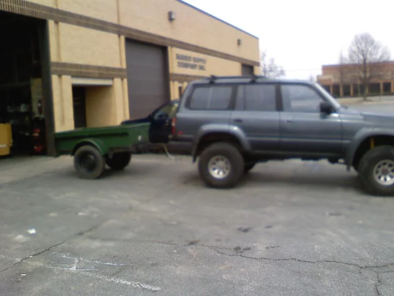

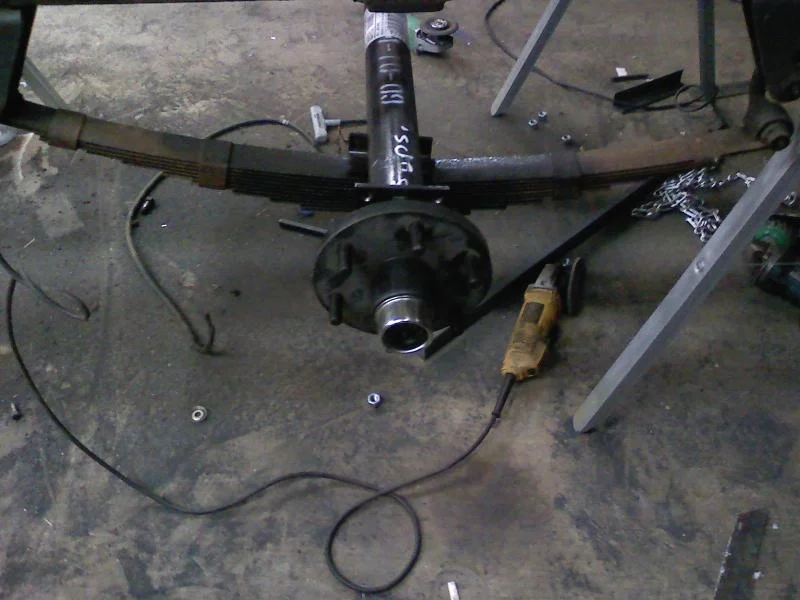

Well me and a buddy decided to build a tow behind camping trailer based off of what I have been showing him here on MUD. Well after scouring Craiglist, we came across a M100 up in Delaware. So we snatched it up. First thing was to address what did we want-Hot water tank for showers/fresh water. Dual battery, rack for RTT, 35" tires, 3500lb axel with Toyota bolt pattern, extend the front end and so on. Well we started on this a few months ago. I'll post some pics of what is done so far.

Here it is with new shocks and mounts ready for the new floor to go on!
We wanted ito lengthen it to have more space for junk on the front(battery box, coolers,ect..) also it makes it easier to tow. The trailer is mainly gonna be used for fishing trips and camping in the Outer Banks, driving on the beach ect..
More Pics of M100
Here are some pics, we cut out the old floor and we measured what size we wanted and had a sheetmetal shop make a new floor taht you can see. We then started on the rack. Next we sanded down to bare metal and Rhino Lined in the bed and on bottom of trailer. The top of trailer is painted with a Rust Bullet type stuff. Oh we are not done with paint yet. All the pics arent really in order because Im pulling the pics from 2 different computers.

And this is it till I can find my camera. I have a couple pics of its maiden voyage, just have to find the camera:doh:. Well it towed awesome, straight as hell, no wobbles, shakes ect...
