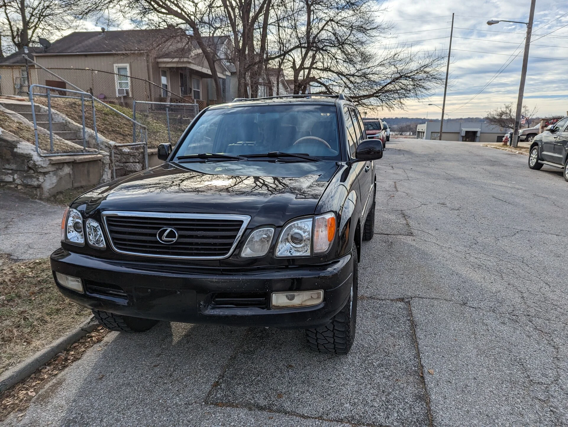

I posted a thread last week with questions on what to look out for regarding an LX 470 I found, and then passed on. However, last week on Friday I test drove a different LX 470 and got what I think was a good deal on it. Paid the owner today and brought her home this evening. Hoping to get more and better photos tomorrow morning in the Sun, and pending title & tags.
She's a 2000 LX 470 with 270k miles, and a maintained transmission/engine, with a couple minor battle scars from some prior accidents from the two most recent owners.

Here's two photos from this morning following the title transfer and registration.

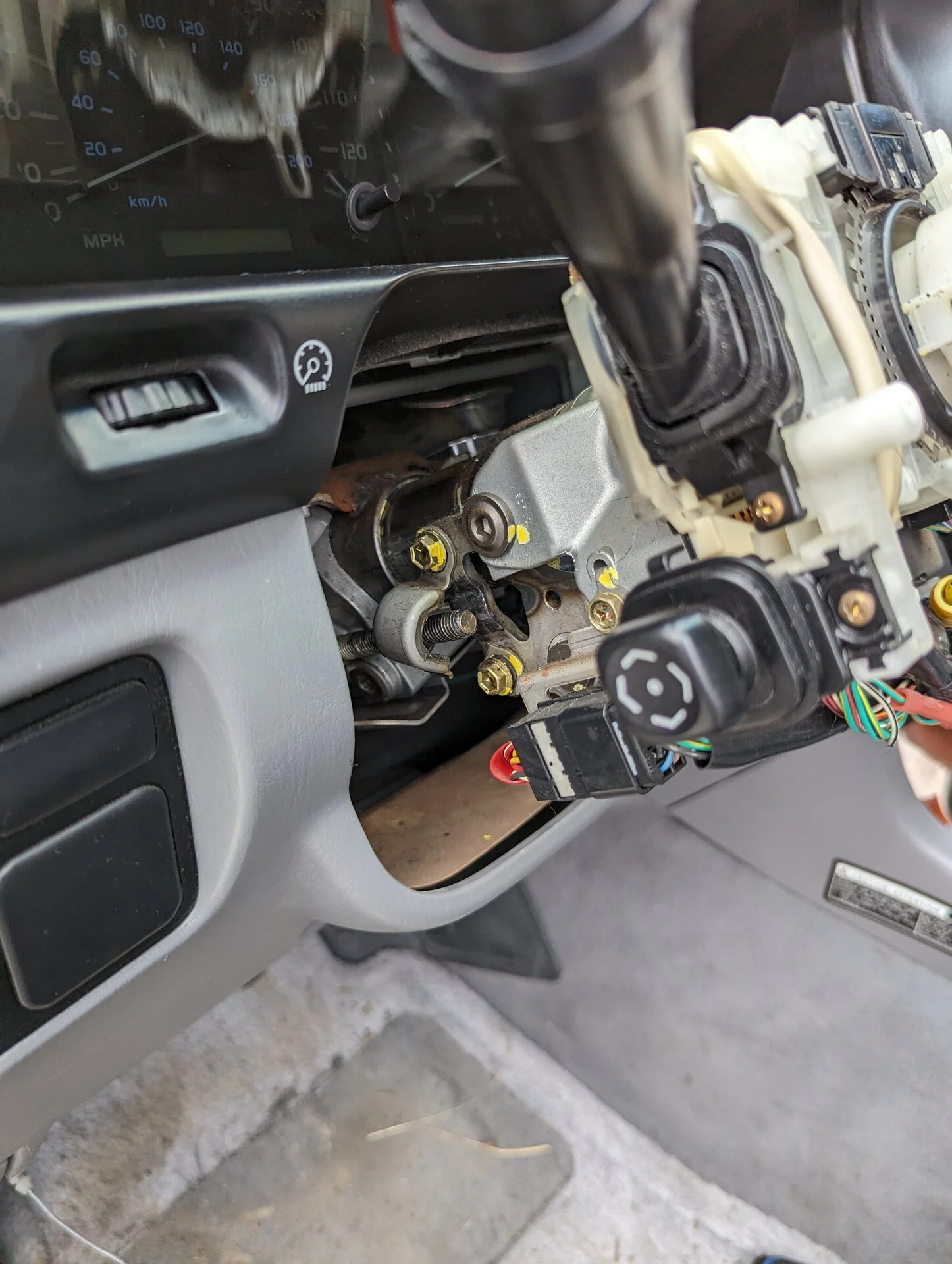

Airbag clock spring replaced. Also got the column opened up, and found the true cause of my non-functional telescoping wheel:
Motor and screw work great, just the retainer and bushing are likely going to need to be replaced and greased.
Great looking truck, i think the color matched front and rear bumpers were rare on these, most LX470s i see are two-tone, which really dates them. This truck looks so much younger than 23 years old. Great find! Sounds like you 've got a good list to work from.

Received the bushing and nut for the telescoping wheel, but still waiting for the strap that holds the two to the column.

Telescoping wheel fixed! I replaced the bushing, the slider, and the bracket. Took about 25-30 minutes. Probably would've been a bit quicker if it wasn't so dang cold outside.
Added a bit of general purpose grease along the threaded rod before initially screwing the slider on, since it looks like the old bracket broke somewhere in the middle of the telescoping range. Very happy with the result.
