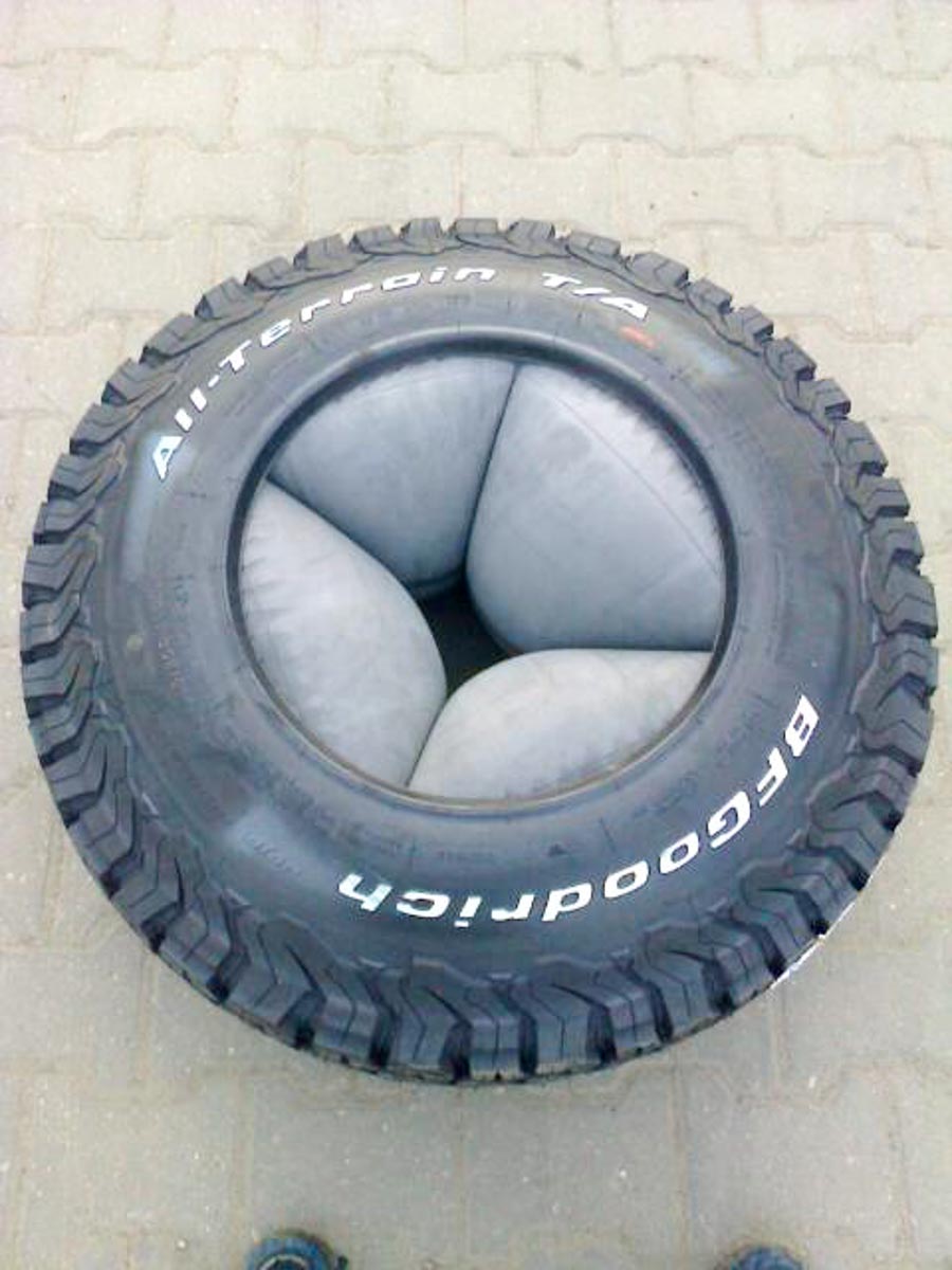

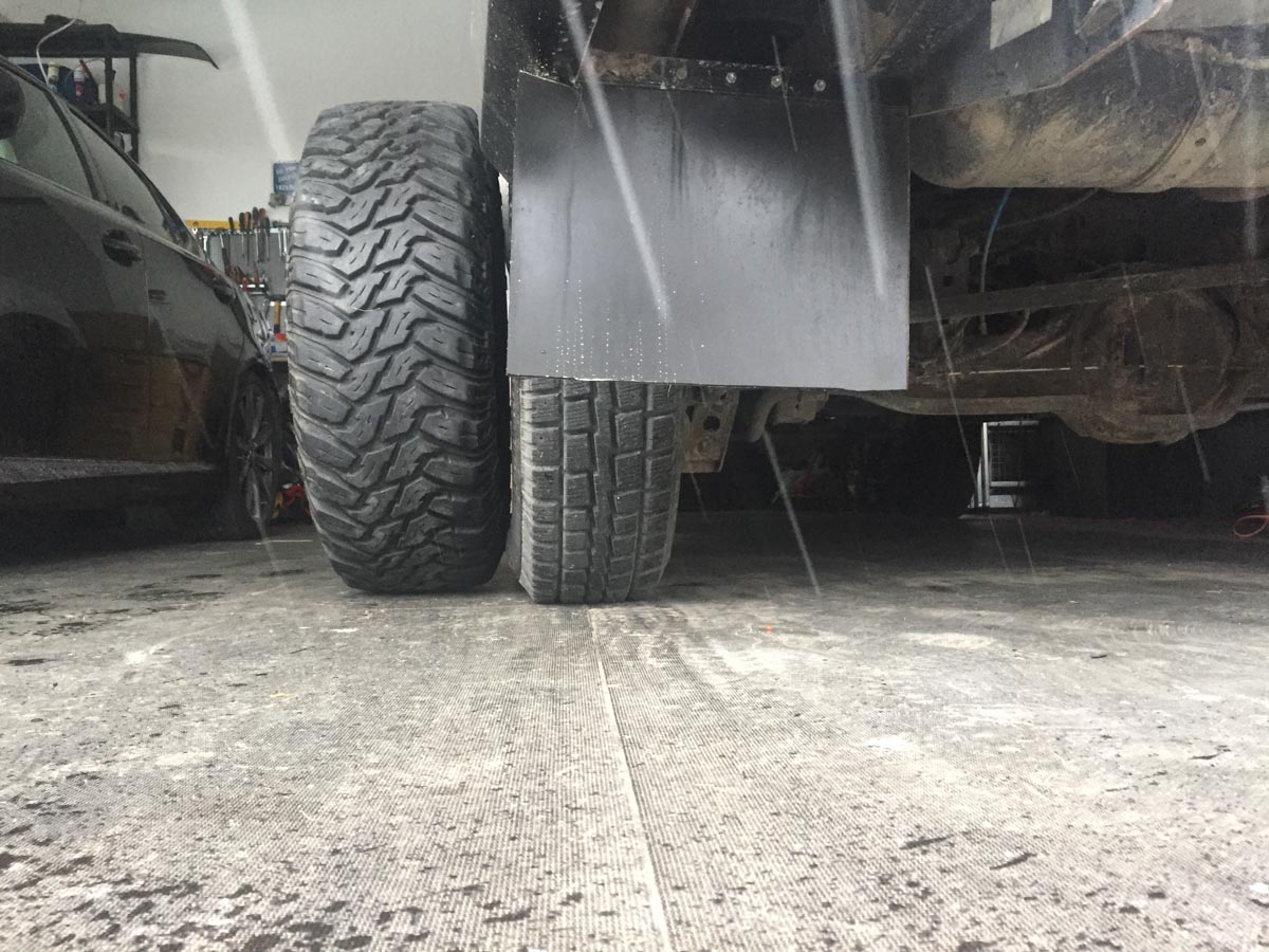

i the meantime tires (235/85/16) landed on the factory rims - it was not easy to install them as those tires are extremely narrow
We test different solutions including inflator (hope it is correct name - special tool that produces huge pressure at once), some other ideas were tested
finally we installed 15inch heavy duty tube inside, now i can do 2mpg more than before

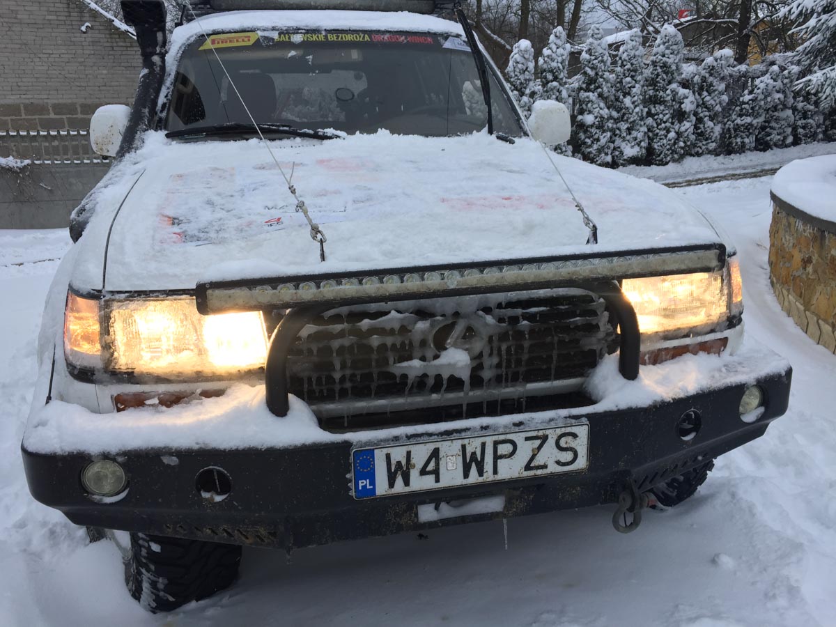

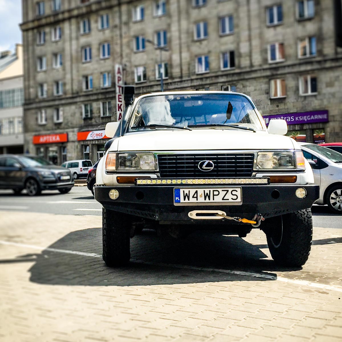

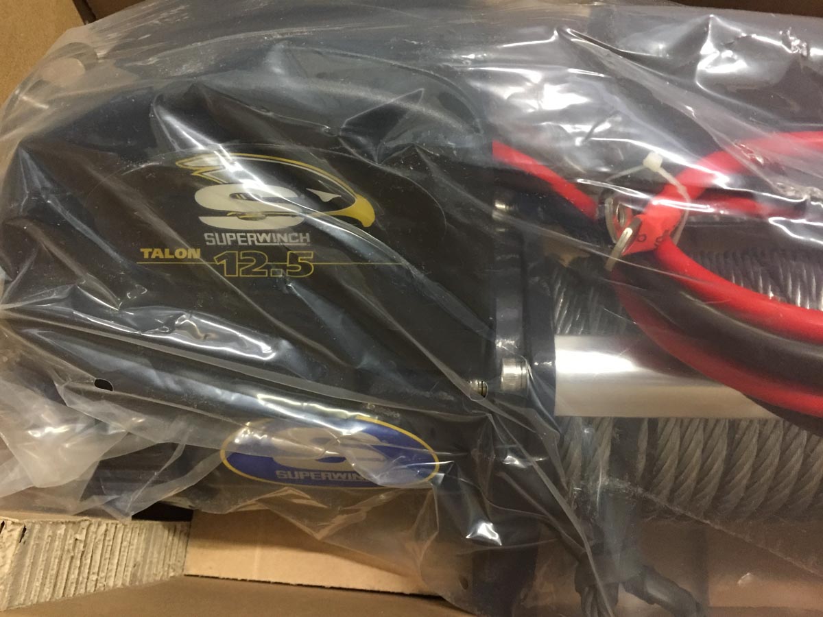

new 10000lbs winch in the bumper :)

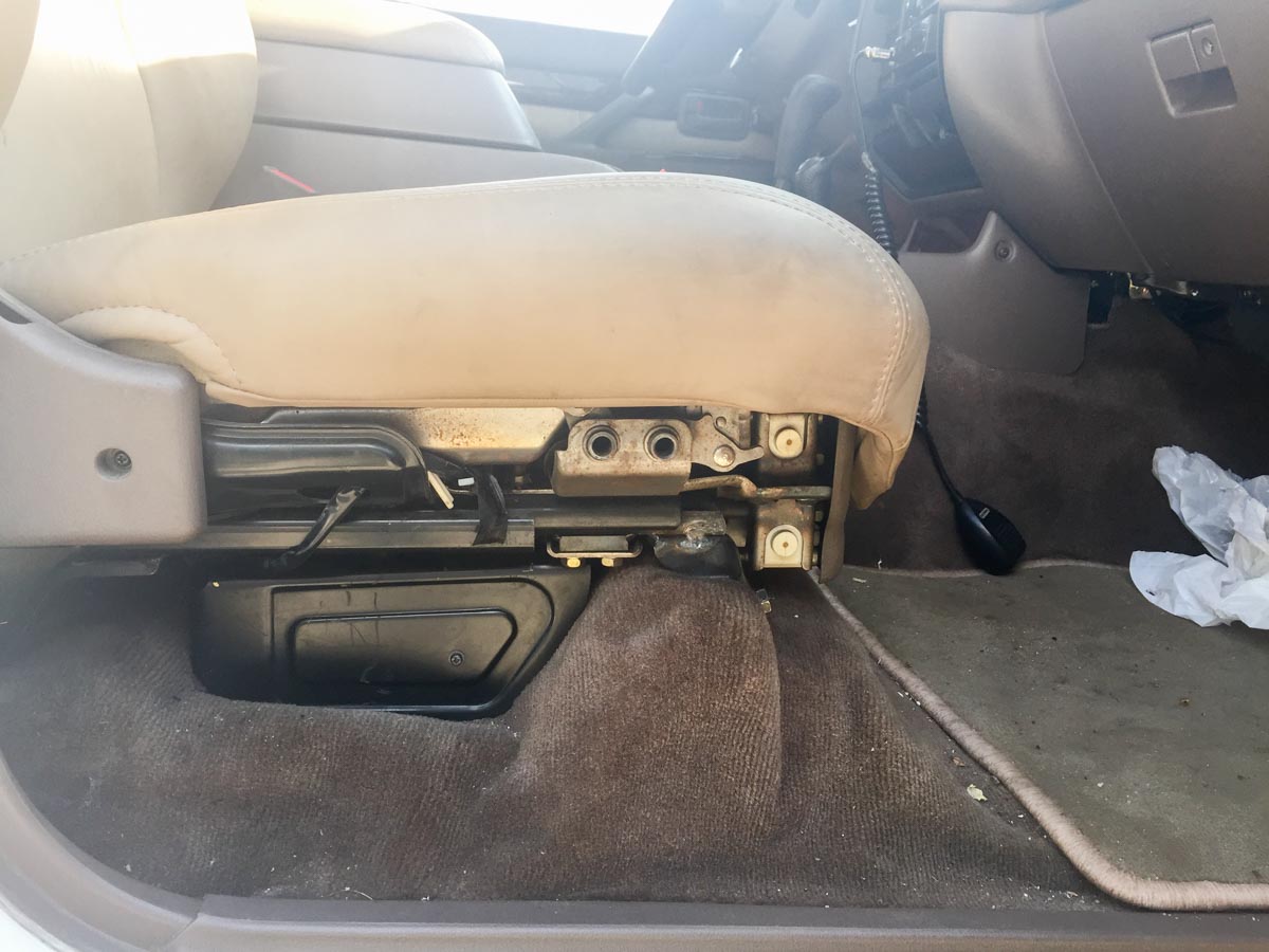

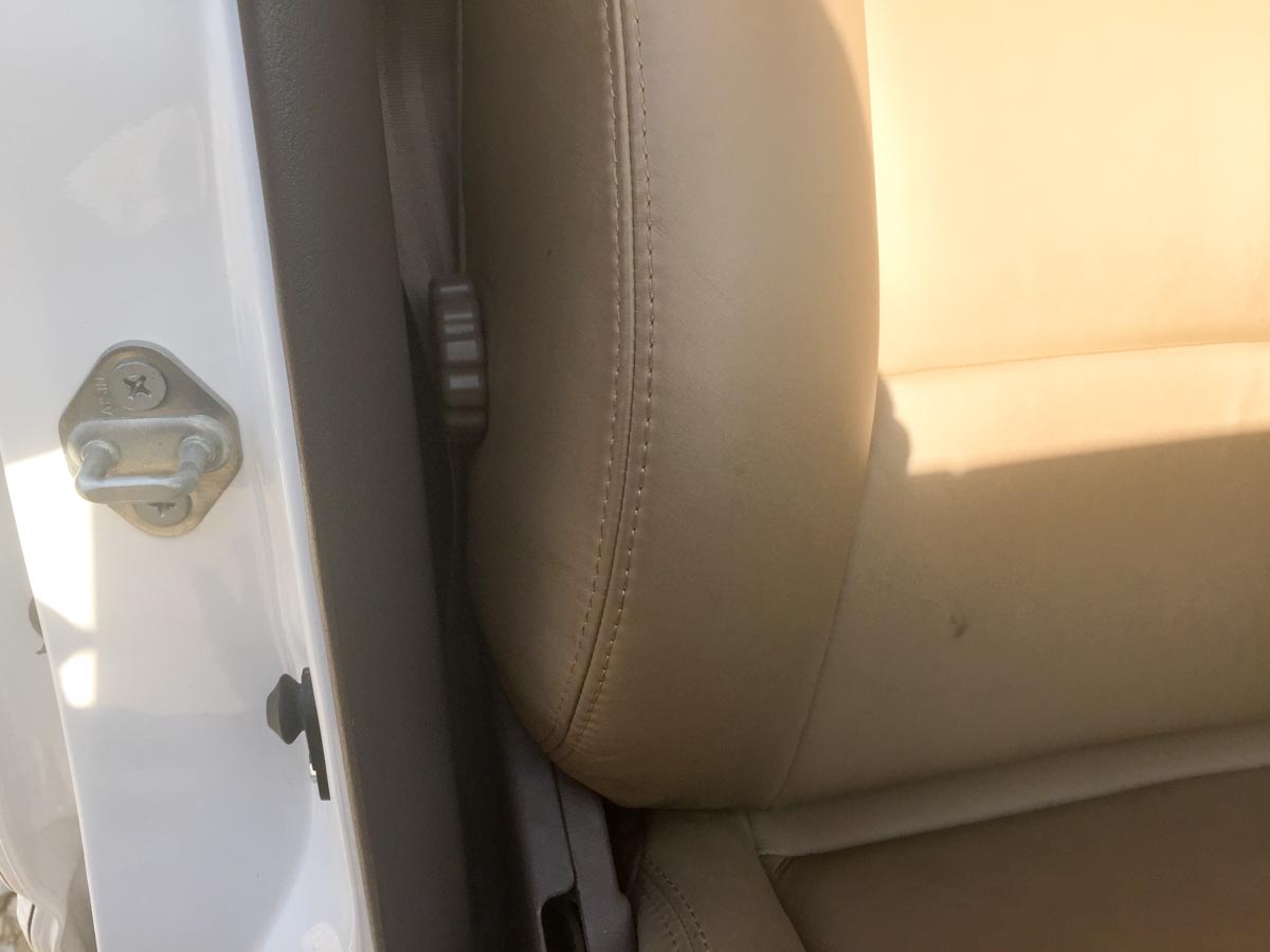

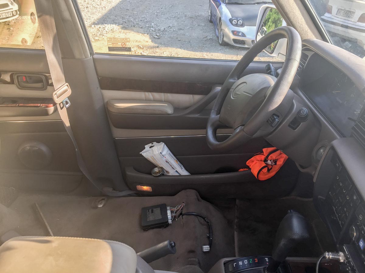

and driver seat installed in passenger place
control is still available - not as comfy as it was on the left side o car but still usable
I have to find solution to cover this mess

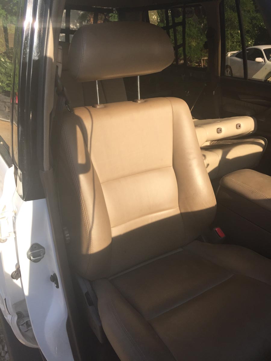

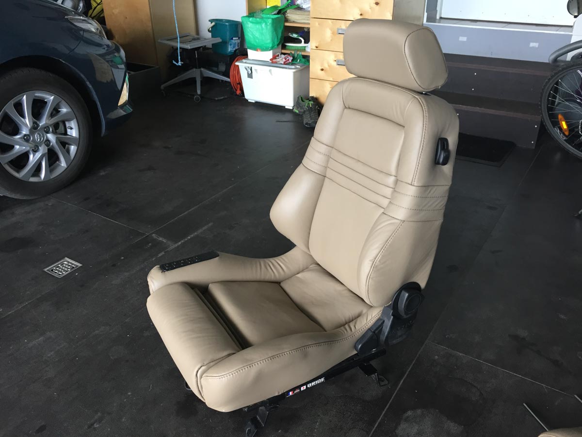

Now will have better control in this seat (lumbar and width of the back) plus there is new high quality nappa leather.
for driver seat I'm waiting for...

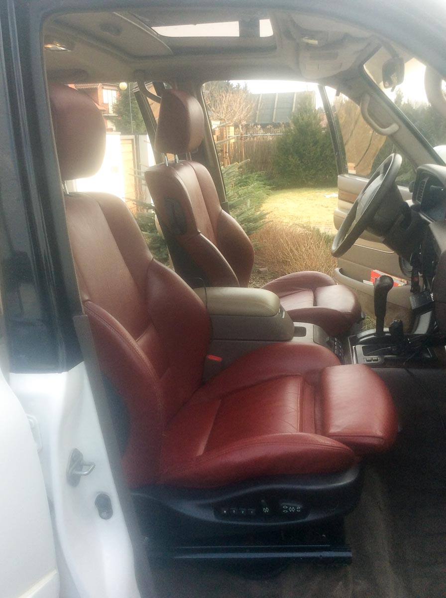

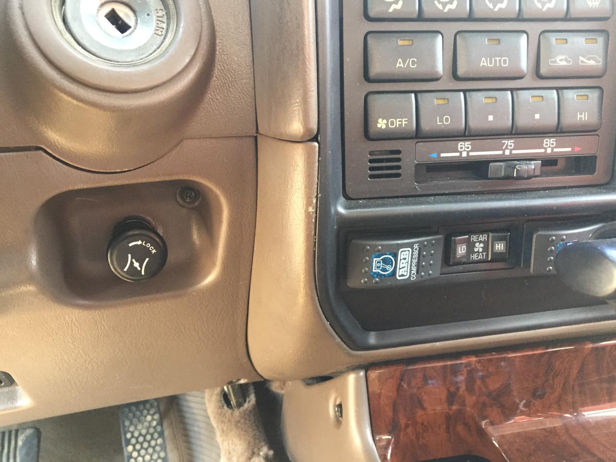

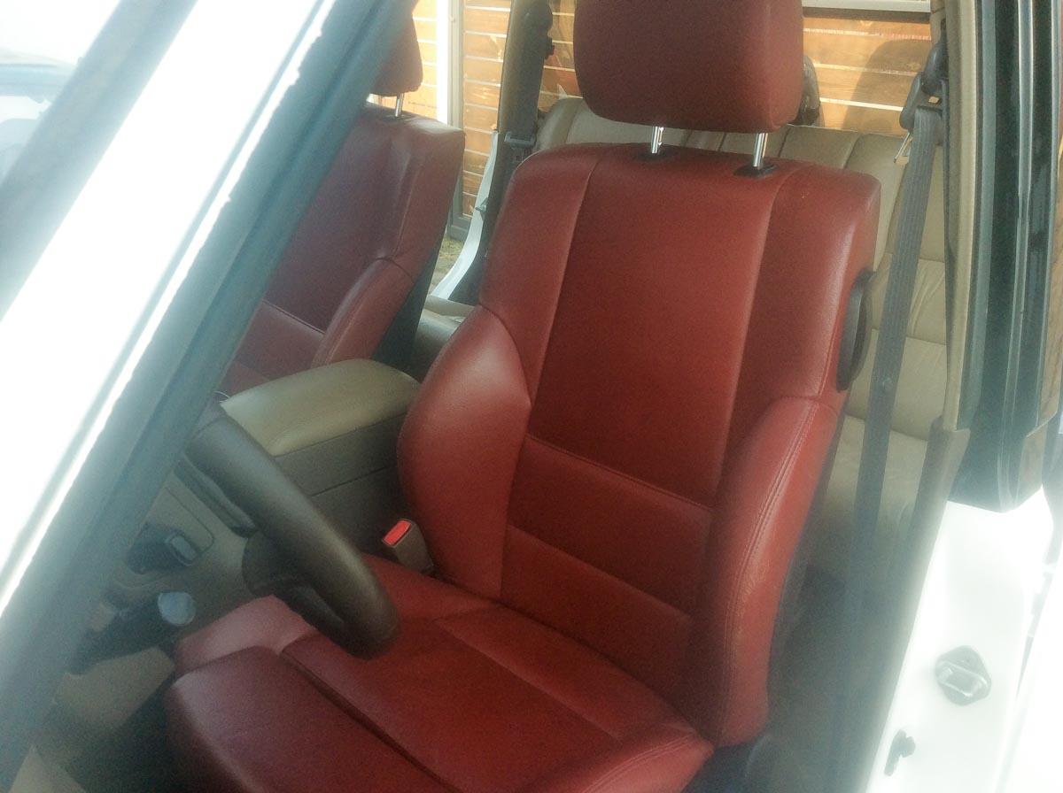

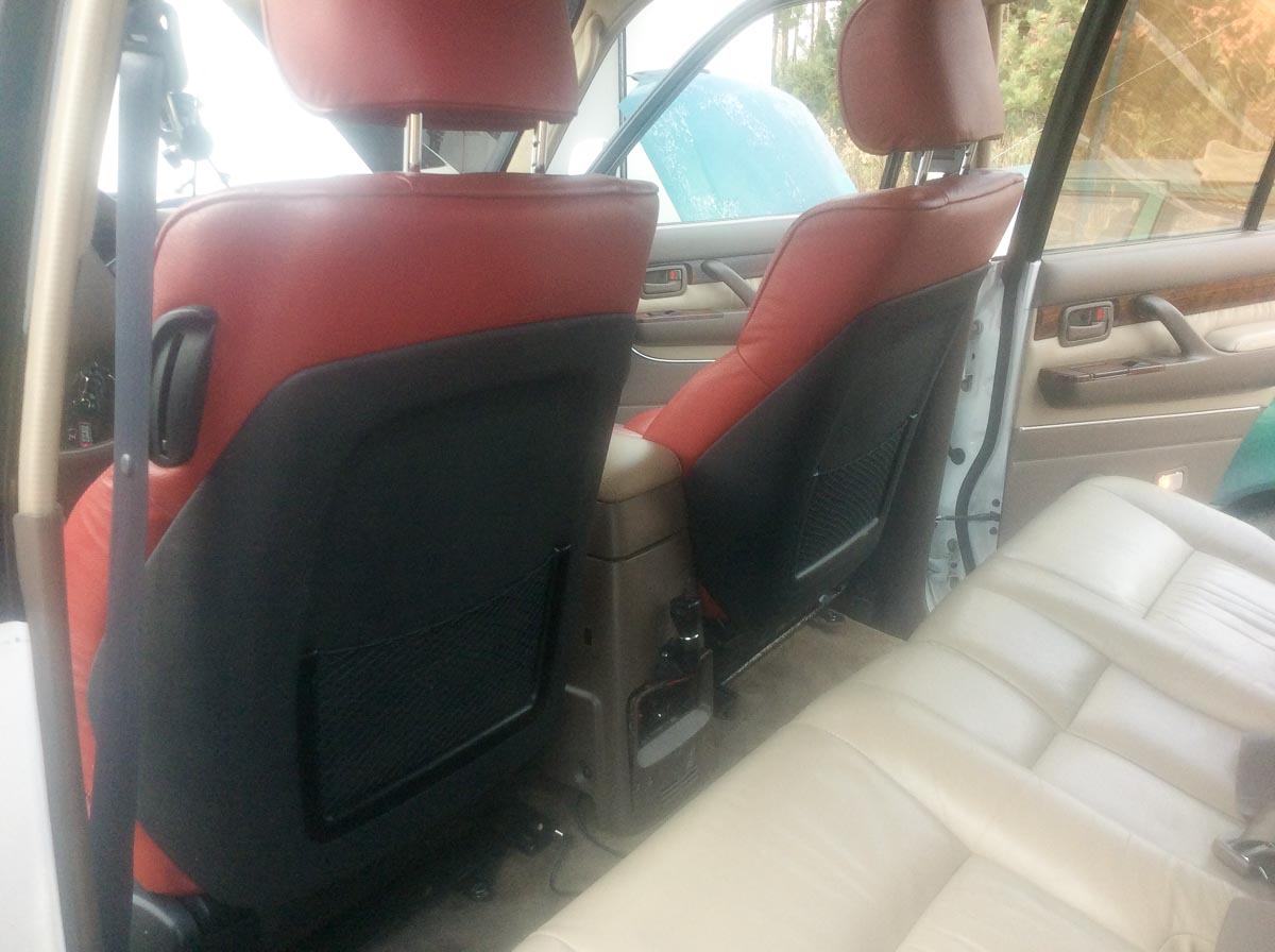

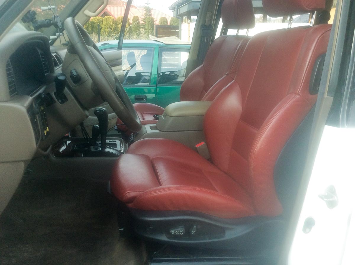

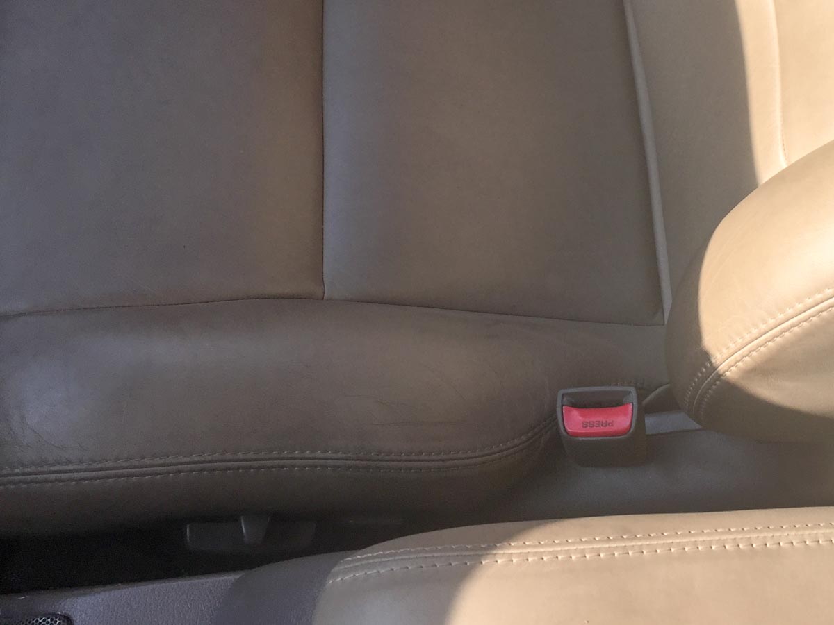

Recaro was a mistake - maybe mine was broken (but looks very good) but I could not find a comfortable position. So decided to install set of BMW E46 M-Paket seats in red leather :) definitely great comfort. In the meantime I dismantled back heater as a potential trouble maker (condition of water lines shows that it was the last moment to do it), so the switch of rear heater is used as the switch for heating in front seats. Lo is for left, Hi for right - not perfect but works without huge cable works and searching for switch.
The only potential issue with M-power seats is - those are not as low as the OEM, so people over 6ft3inch could meet roof pretty often. I am 6ft 2in and it is OK when seat in the lower position.

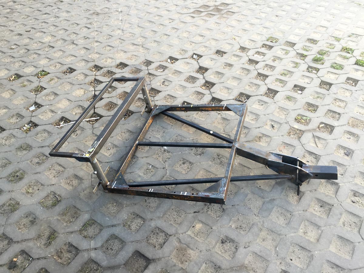

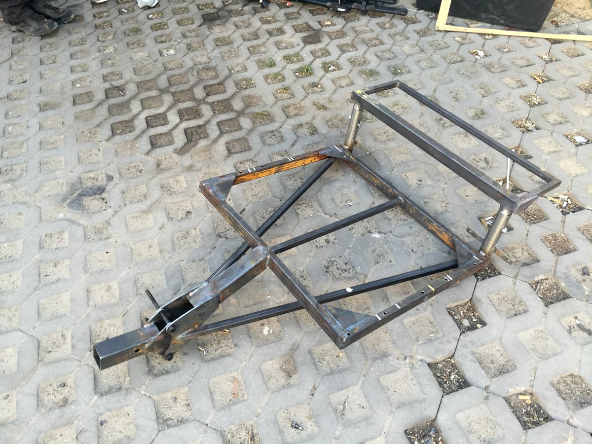

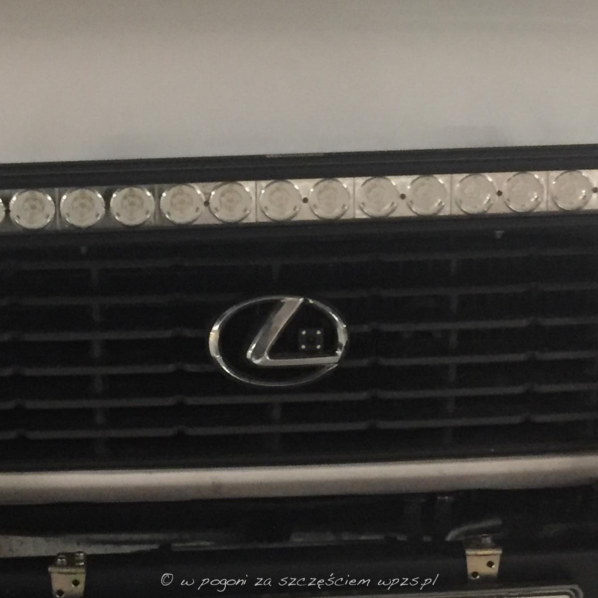

next change is the small bullbar to hang led bar and allow better access to winch.
I've also install couple cameras - but it is still "work in progress"

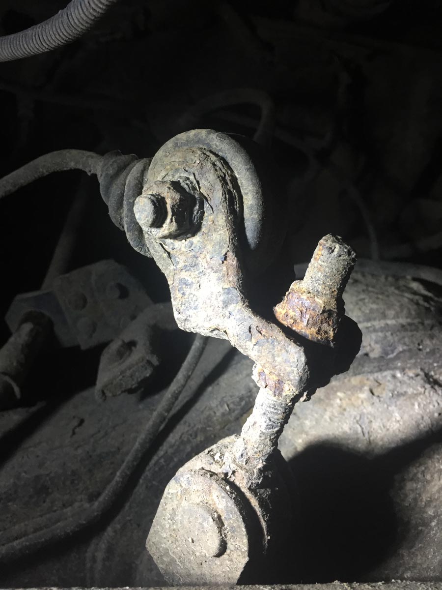

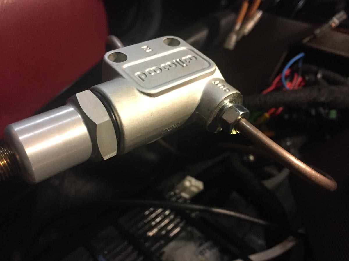

condition of rear brake controller (proportional valve) not ideal

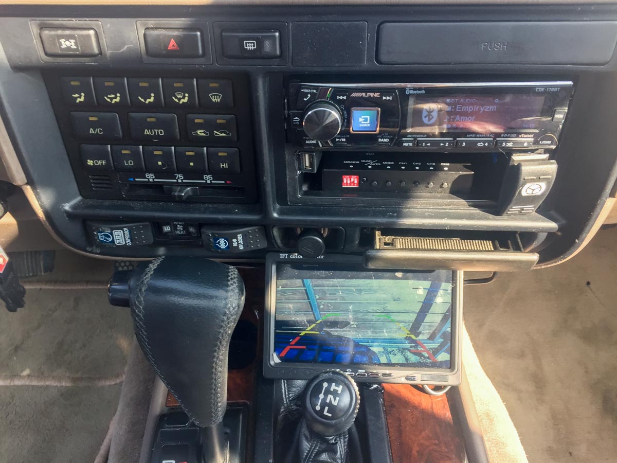

so installed Wilwood brake controller, it is hide in the central console (armrest), finally my rear brakes work as should. Still not happy with my brake pads setup (Hawk SD on front and LTS on rear axle), after installing wilwood i feel the rig stops much faster - but SD need some heat to operate - what is not perfect. Together with proportional valve, all brake lines were replaced. Carbotech XP-8 are waiting for replacement but disk and pads are still in good condition (over 50%).

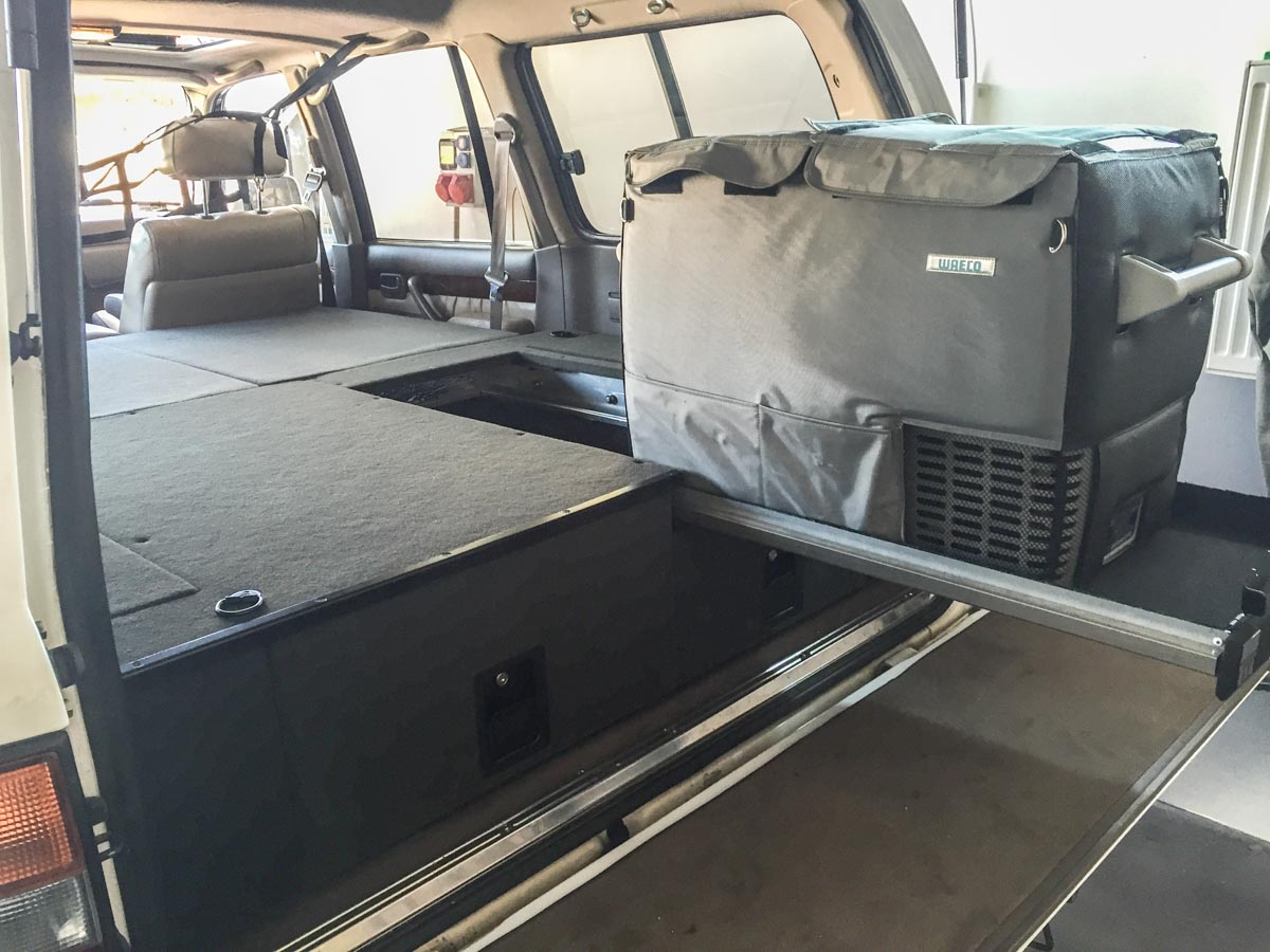

and there is a sleeping platform ready to use (195cmx 127cm)

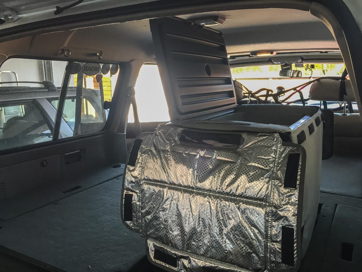

frigde
it was very important to have possibility to open fridge when in the car

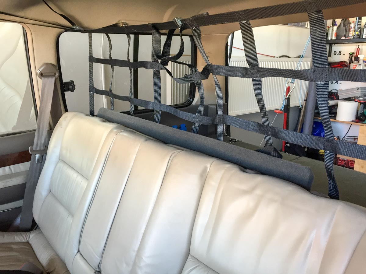

and net to divide trunk and passenger area

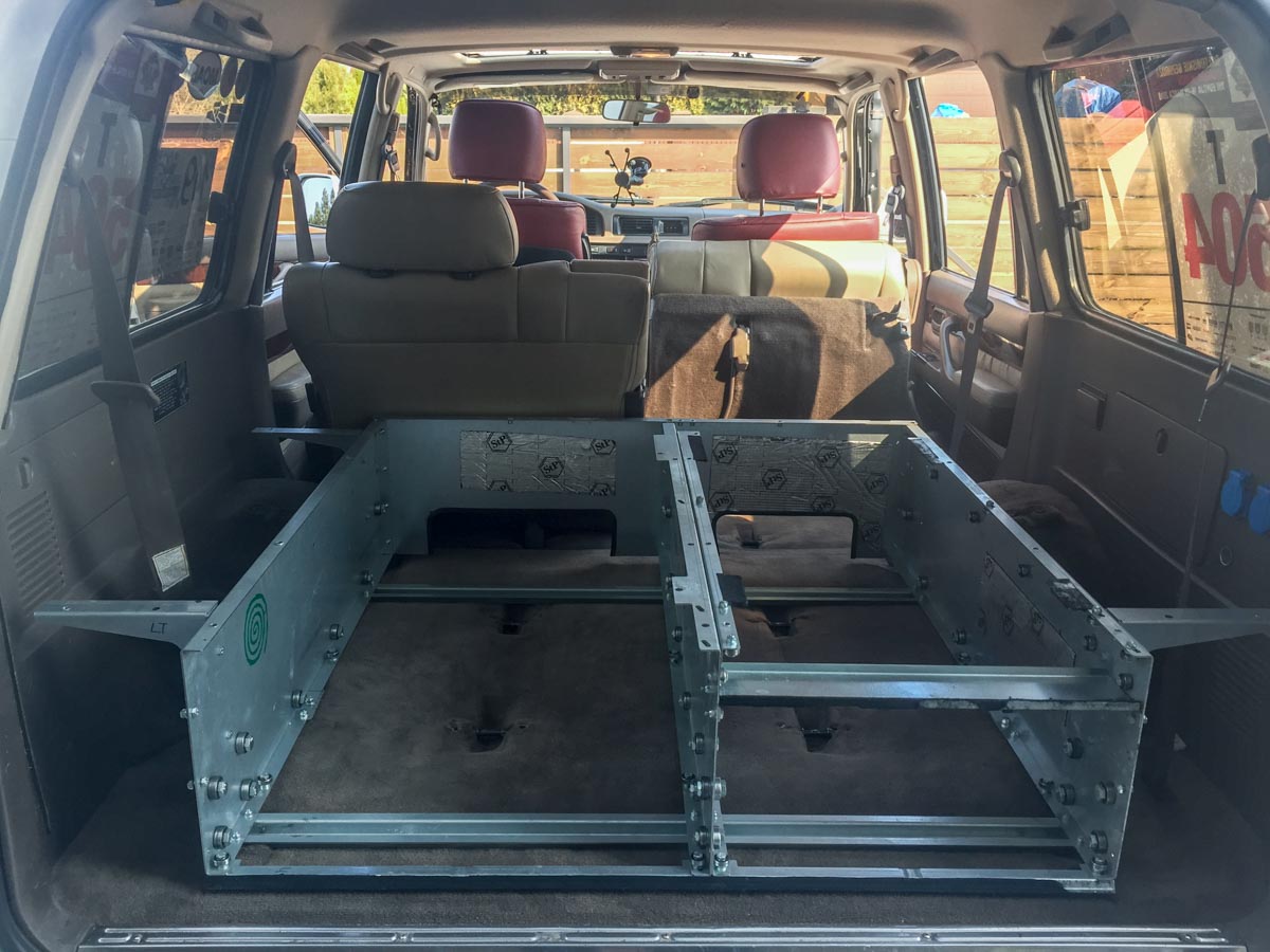

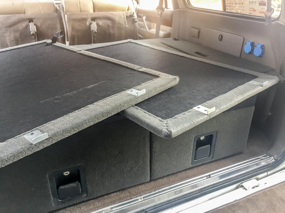

How is the platform attached to the rear seats? Could you post some more pictures of this? I really like this sleeping platform but have struggled finding something similar therefore I'm planning to build my own.
@Sirlongrod - no it is not mine I don't like Mazda's reliability, prefer Lexus IS-F,
@EP977 I have to check, you mean on second row?
@EP977 platform lies on folded backrest of second row seats. It has small bracket on one end that is fixed to the drawer system in the trunk. Currently drawers are dismantled coz i need third row in the car, but in next 3-4 weeks I will install it again - will prepare photo-documentary for you.

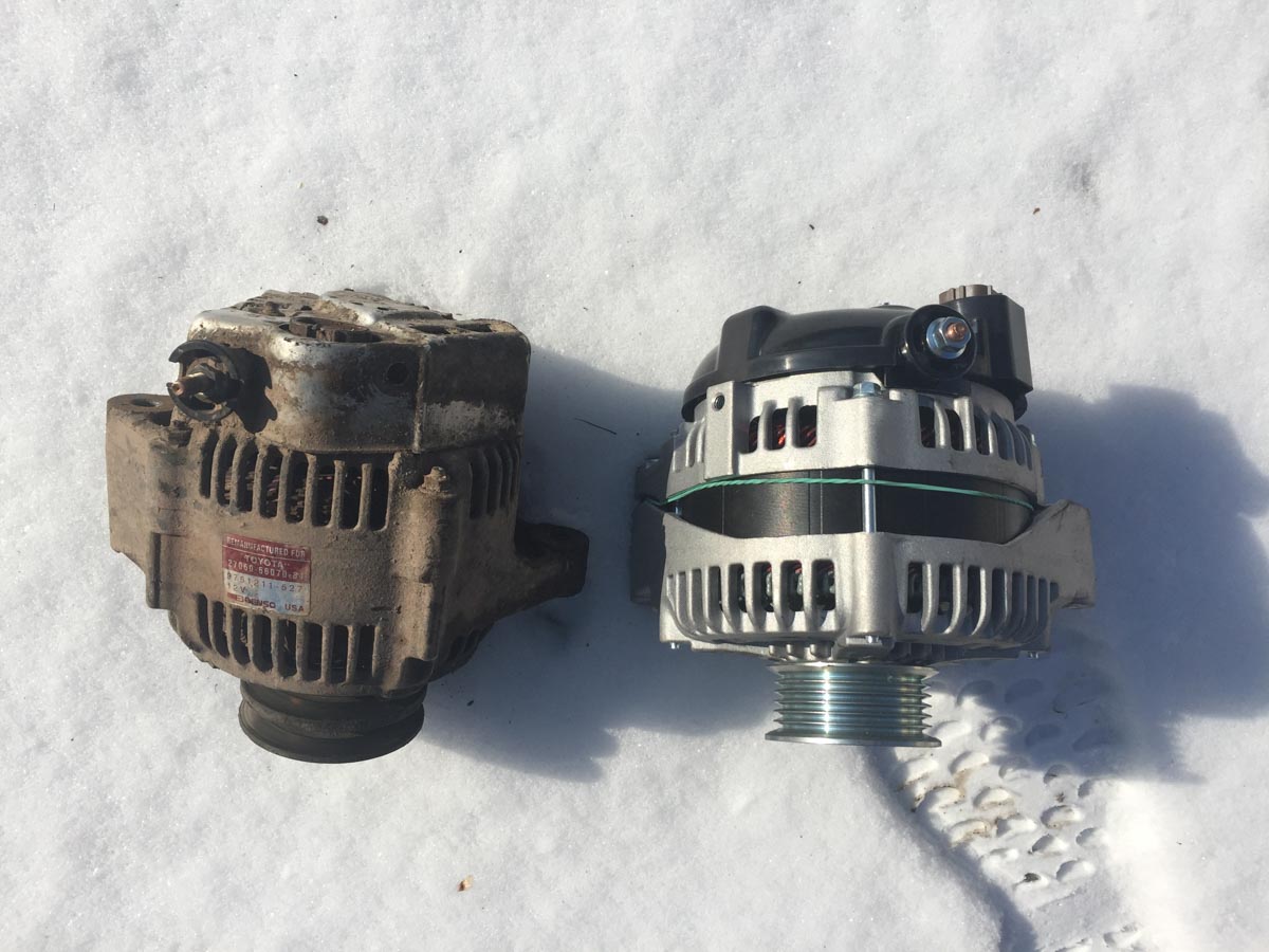

thanks to Bill I installed new alternator (replacement of Tundra 150A) + manual throttle, Hope now will be easier to winch in the mud, if not will have to buy Optima battery.

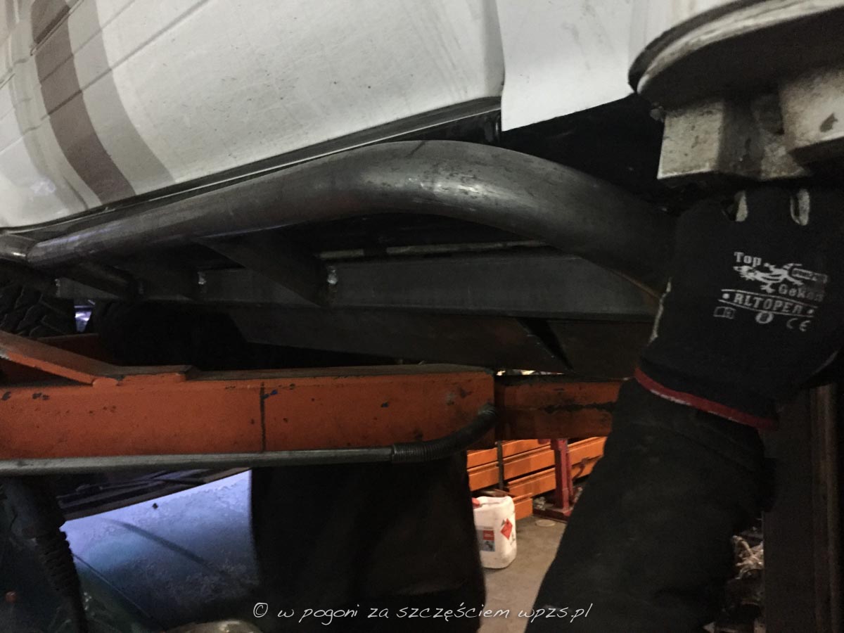

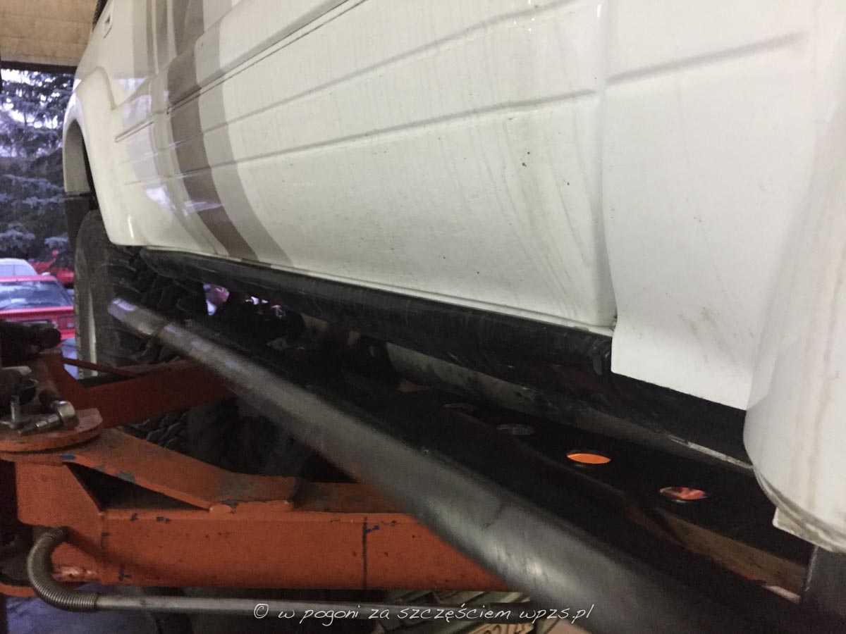

and it is time for better sliders :)

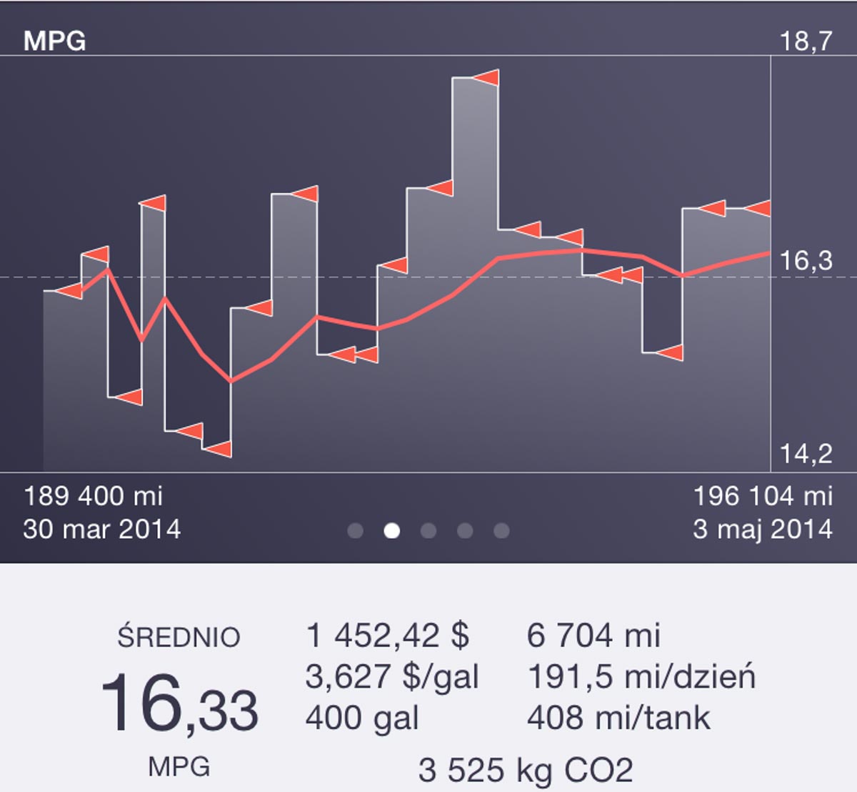

@hsoliday - after 15000 miles behind the wheel of I know the magic barrier of 60mph, with roof top tent, snorkel and couple bikes behind above this speed fuel efficiency fall down dramatically (to 12 mpg or even less).
with OEM size tires (street Michelin), no rack on the roof and just 2+2 family in (and some baggage) we did easy an average 16,3mpg on distance of 6700miles - mostly highway and slow offroad trips around Moab

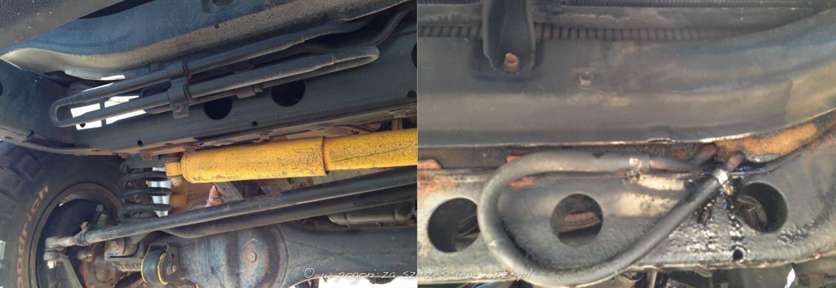

I bought as well an universal power steering fluid cooler (dedicated for F150) as the Lexus had something like that (right side of the picture):
orginal cooler is expensive - much more expensive than I expected.
temporary fixed:

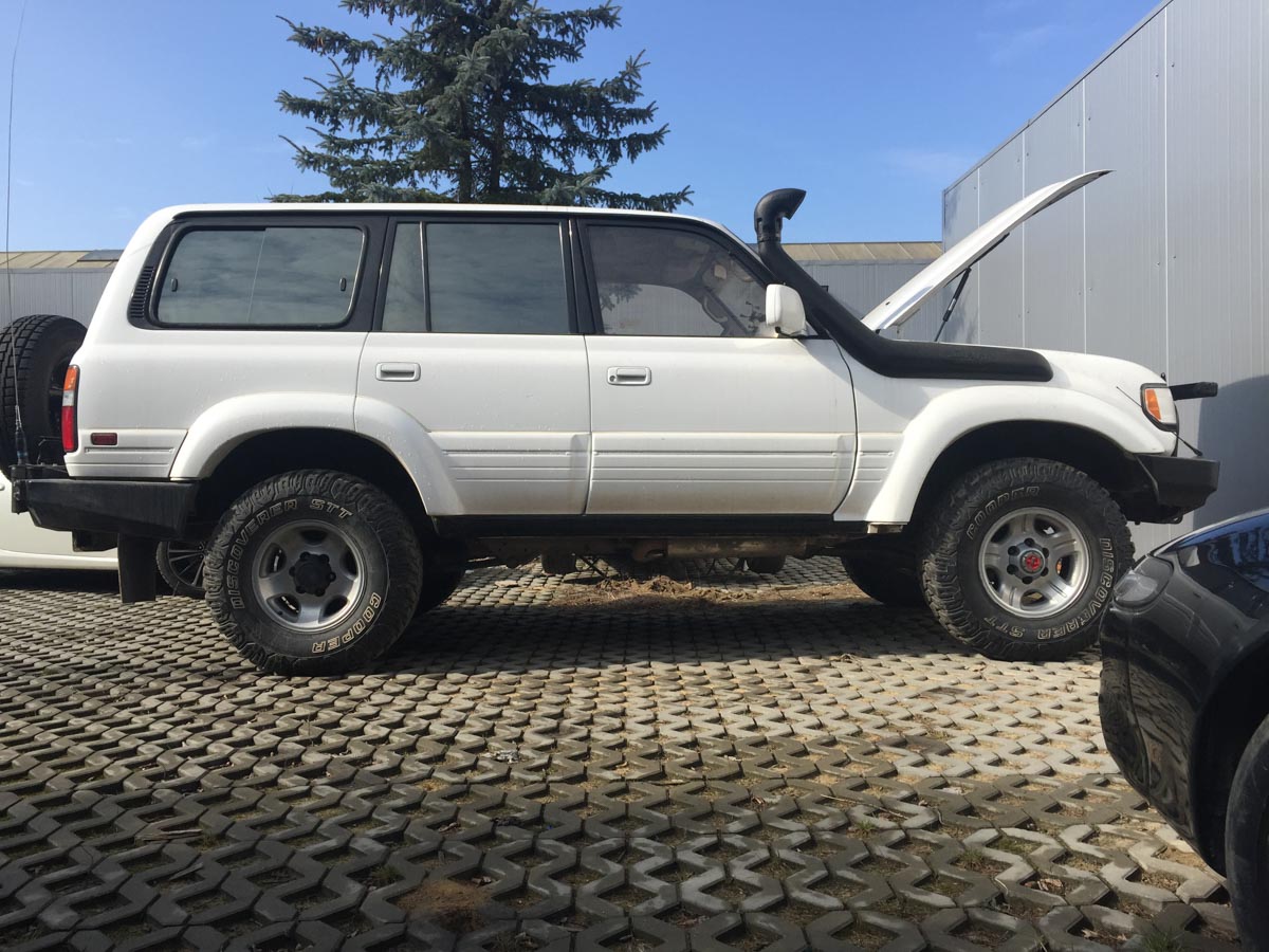

When we came back to the US exhaust was repaired, Old Man Emu installed and new set of BFG AT 33" so the clearance were more suitable for our destination.
I ask my friend to install trailer hitch because the system used in the US is much more universal than our european fixed ball. Choice of Uhaul hitch was very good, I've just limited offroad capability of the car :(

I did not present my new front seats :)
Seats came from E46 coupe M-paket, very comfortable and sporty, but are taller than OEM - so not for very tall people - I am 187cm and it is just fine.

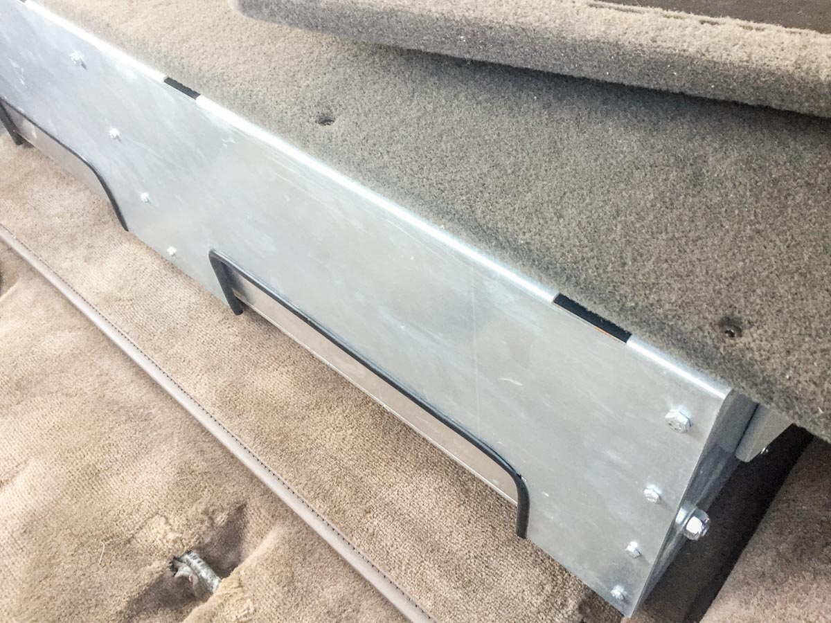

@EP977 I have reinstalled drawers, and have taken couple pictures:
here you have sleep platform:
behind the second row of seats drawer system got this:
platform is supported in 2/3rd of the length by seats
as the front seats are moved max to the front, all luggage are located behind front seats, and work as additional point of support.
dimension of the platform:
length - 76in (193cm)
width - 50/59in (128/150cm) front/rear
distance to the roof - 29,3/27in (745/68,5cm) (rear/front)
and finally install monitor for cameras (F/R)
Thanks for the pictures. I really like that setup. I don't think I've asked yet, what company makes it?
it is made be small local company, I am pretty sure it is not available outside Poland. But it is made as bulletproof as possible - big industrial bearings, solid structure (but heavy - i think it is around 150lbs in total)
