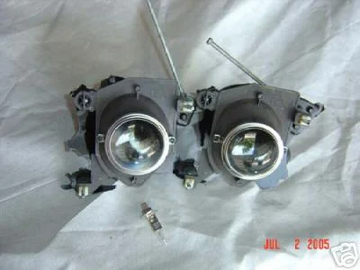

My 80 lamps do suckaroo!
Here's what you are need. ;)
Btw, Are the 80 and the 100 JD bulbs, the same?
Although you can get HID bulb/ballast kits for both the 100 and LX, you'd probably get a better pattern w/ the LX since its headlamps are projector lamps. I believe on true HID vehicles, the HID beam projects straight ahead rather than relying on a reflector dish (can anyone confirm?). While one still can install an HID bulb kit w/ the 100's reflector lamps, the bulb isn't likely to be positioned in the correct spot to take advantage of all that light, causing it to spray all over (and ticking off other drivers...probably the reason why those HID kits were banned for on-road use!).
On the 80, if you're willing to shell out the $$$, you can get JDM four lamp kit ($1K in Japan, four equally-sized rectangular lamps) and replace them with Cibie or Hella e-codes for $40/ea. And if you rig them up illegally (eg, four H4 lamps), you can put a lot of wattage on the road and have a good pattern. I put Hella e-code H4's on my Toyota truck...that was like night and day! I then upgraded the harness...that didn't make as much of a difference, but it was still 40% brighter (measure w/ a photography meter that measures 10% differences).
