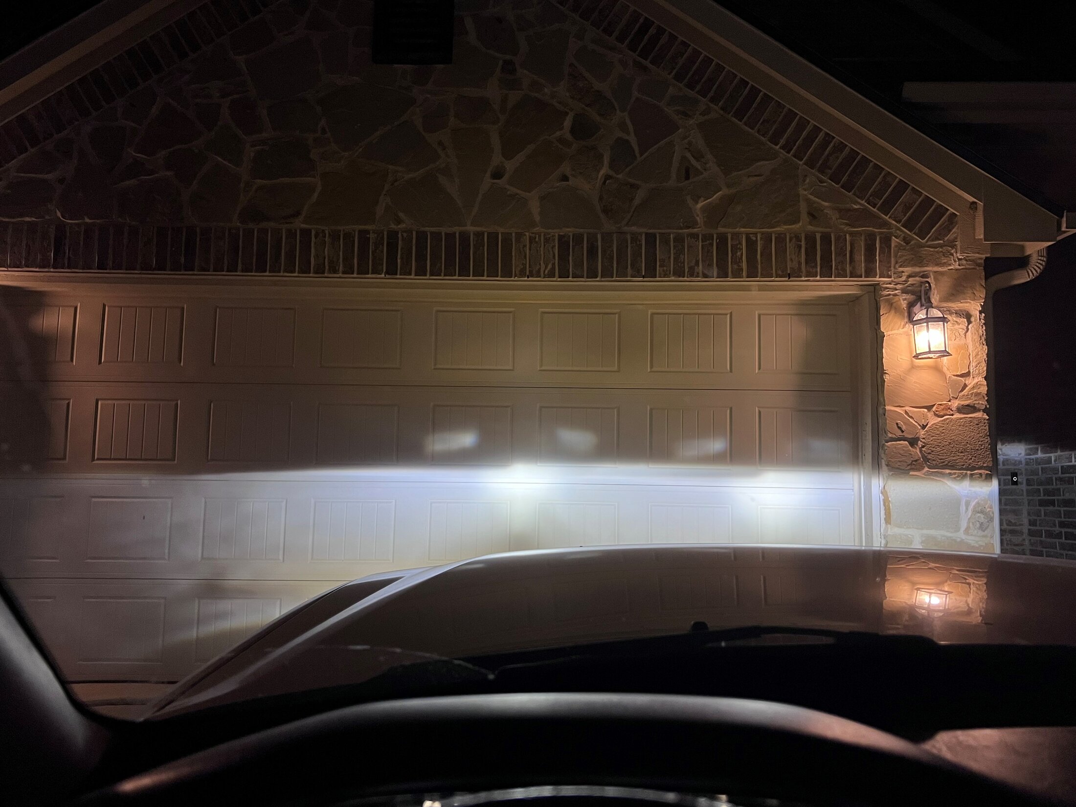

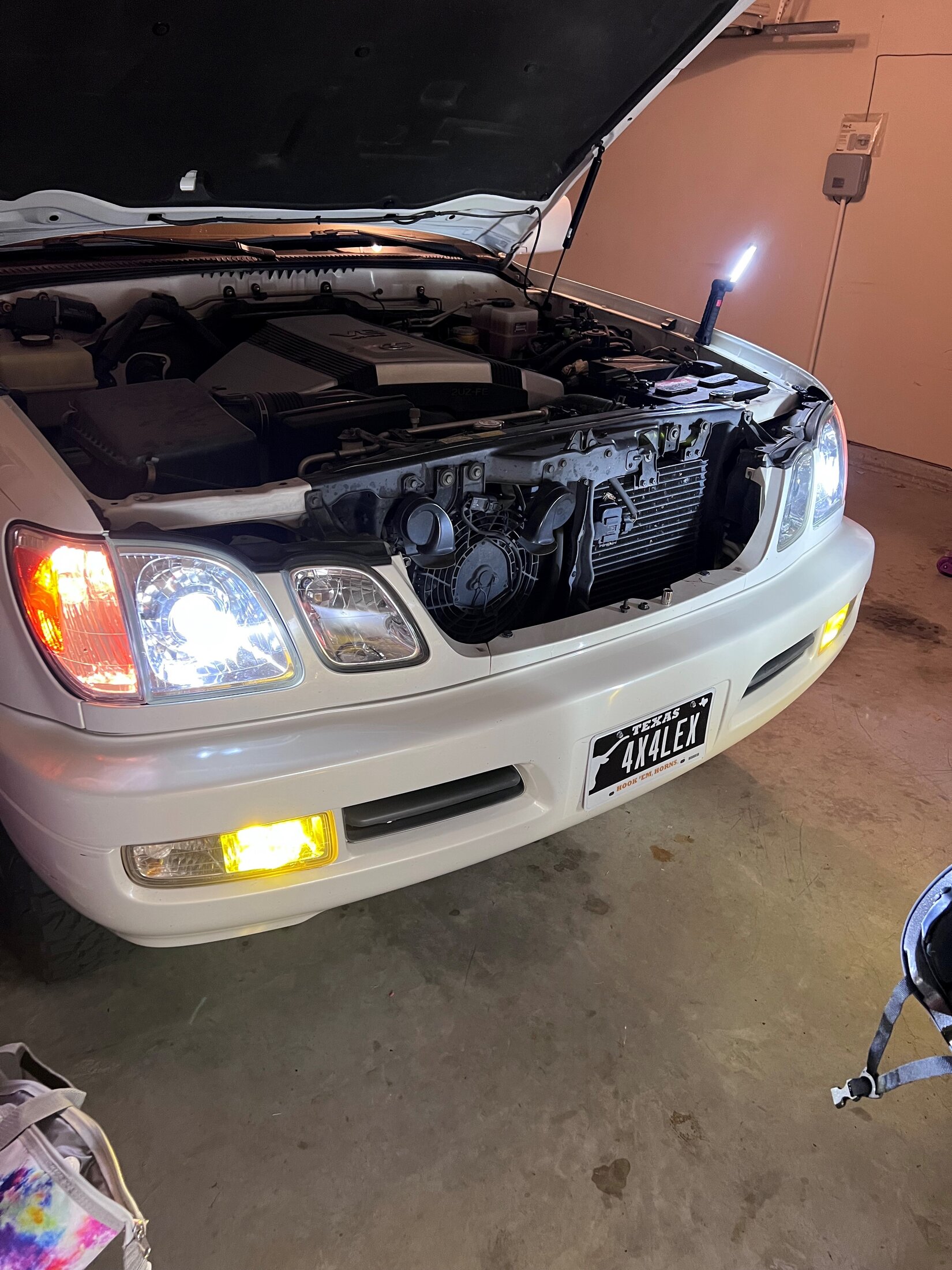

Finally found a set of H1 LED bulbs that are a direct swap and fit with the factory dust covers. I know what everyone will say. The factory projectors aren't meant for LEDs but oh well. I think the cut off is decent and I can finally see! After going from driving cars with HIDs for the past 10+ years I hated the factory headlights on the LX. Makes a huge difference to me, and I'd recommend them to anyone wanting a really good/inexpensive lighting upgrade.
While LED's are super attractive to me for the light output and easy of install, service writer where I take my other Toyotas has mentioned a few times they had big issues with aftermarket LEDs causing all kinds of electrical problems upstream in the wiring.
They look pretty good, keep us posed on whether or not they get too hot!
The bulbs do have a tiny fan on them, but being inside the dust covers not sure how well it actually works haha. I'll take a look at them this weekend and see if I notice anything out of the ordinary.

Nice. I put LASFITs on my LX back in March, but then used the LASFIT deeper dust cap. Nice the bulb has gotten smaller. I haven't had an issue. I also have them in the high beams. I gave up daytime running lights, but they definitely light up the countryside at night.

Any flickering for you in the high beams when the lights are NOT on. My wife was following me and I saw the inside headlights / hi beams faintly flickering. I knew I was giving up DRL but thought it would be all or nothing

No flickering. I did disconnect the wiring from the module on the passenger fender.

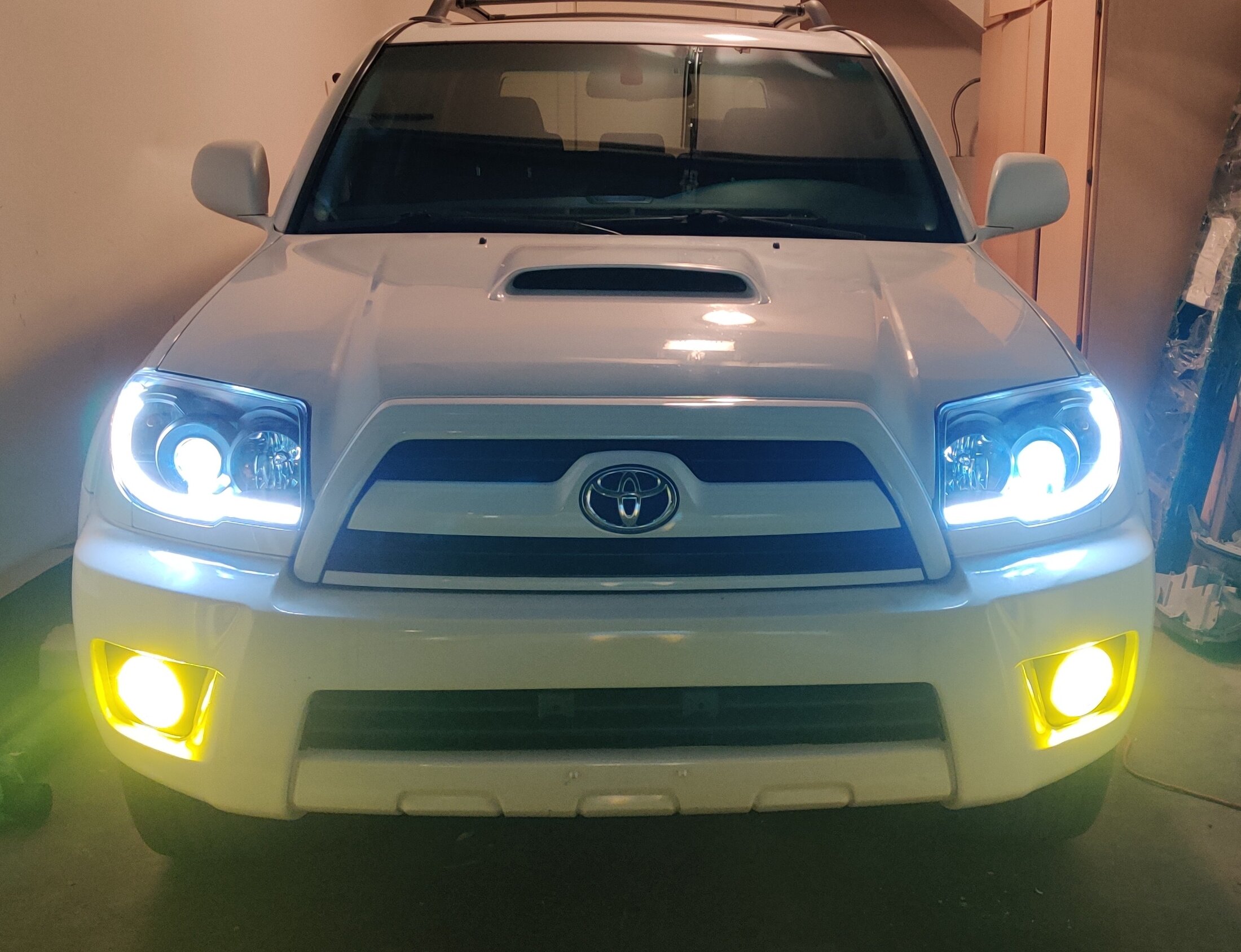

For the fogs I grabbed these off Amazon. Took literally no time to install and for $35 work perfectly. https://www.amazon.com/gp/aw/d/B0B2NZ8Z1H?tag=ihco-20
