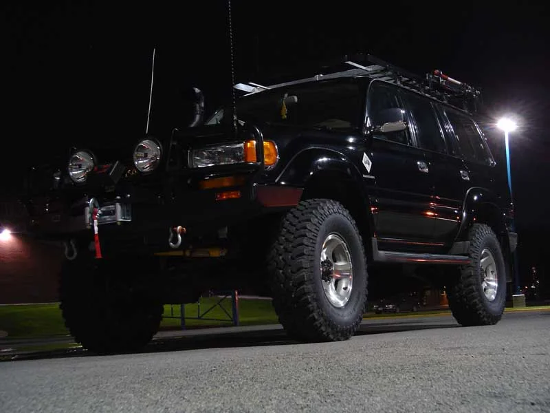

As some of you know, I purchased my 80 a few weeks ago, here is the latest shot of her, I have been going nuts on it with mods! Stay tuned for more on it as well. :beer:
I'll post up some pics of my light tabs I made too....They are drying as we speak and I will mount the four Hellas tomorrow!
