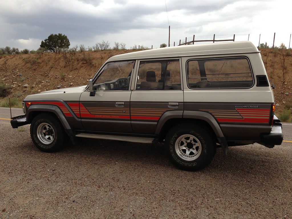

Well after seven 80 Series, one 60 and one 40, I am an HJ61 owner. I bought this truck:
https://forum.ih8mud.com/fj60-fj62-bj60-hj61/760683-1988-hj61vx-12ht-pto-winch-clean-co.html
I made a risky decision to herd it home without doing any thorough checkup (did check the lug nuts, ha) and it had only been off the boat a week. Seller changed the oil, we checked all fluid levels and I set sail from Colorado to Houston. It made it with only some weirdness in the tranny shifting and a broken AC belt (which I should have cut off before starting because I knew it was on its last leg.)
Truck seemed a bit sluggish leaving Durango (though I have no point of reference) so I kept it down around 55-60 mph. I rolled into Albuquerque about 8PM and refueled and added some Howe's. As the outdoor nighttime temps dropped I began to increase speed and by the time I reached Amarillo it was running smooth and effortless at 70. I averaged 26 mpg from Durango to Amarillo at that speed. The run home to Houston yesterday was around 70-75mph and it was 100F outside. Added a small amount of Howe's at each refuel 1100 miles, 47 gallons, 23 mpg. No oil consumption noticed.
