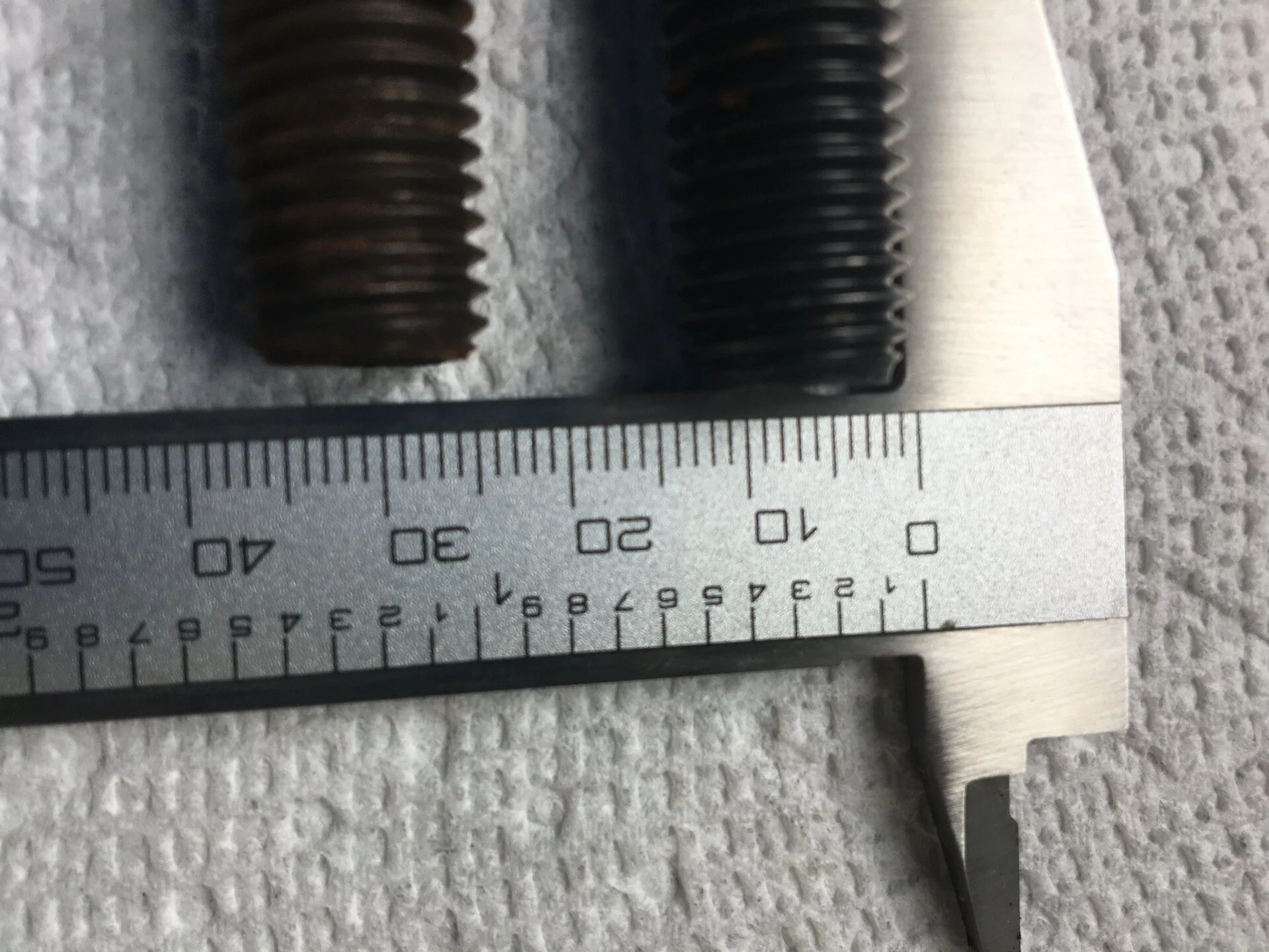

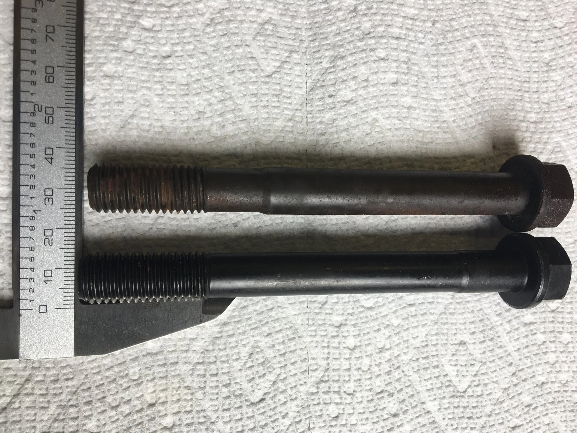

I'm in the process of having my head on my 82 FJ 60 rebuilt. I ordered new headbolts from Toyotapartsdeal.com . Before I ordered them I checked the parts # with my local dealership. The bolts are about 1/8" longer than the ones I removed . Is this ok ?

Not sure what you mean by flipping them 180 degrees . I laid them side by side and lined up the head so they were even on the contact surface and they were definitely longer .

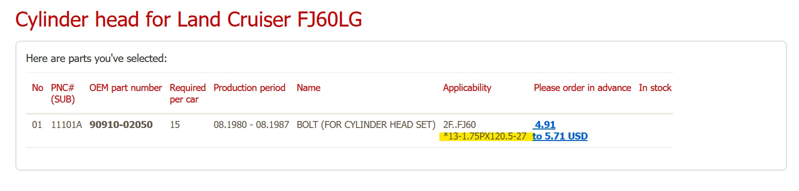

It looks like all the 2F head bolts (1980 to 1987 FJ60) were the same. The part description even gives the size I think: 13mm diameter with 1.75 mm thread pitch. Length from the bottom of the head to the end of the bolt is 120.5mm. I'm not sure what the "-27" refers to, though.
F engine original head bolts are shown a little longer (1.5mm which is 1/16"). The 1.5 F engine has head bolts that are much longer (by 1 1/2") so those won't work. for the F engine parts, the early model year part number superceedes to the part number for the 2F, even though the specification shows a slightly different lenght.

These are the ones I ordered. I’m the third owner so it’s very possible the head has been pulled before and shorter head bolts were used.
Head bolts should be 120.5 mm.

The bolt that's tapered near the thread is from an early F engine. The new bolt is the correct one for your 2F, though both will work.
