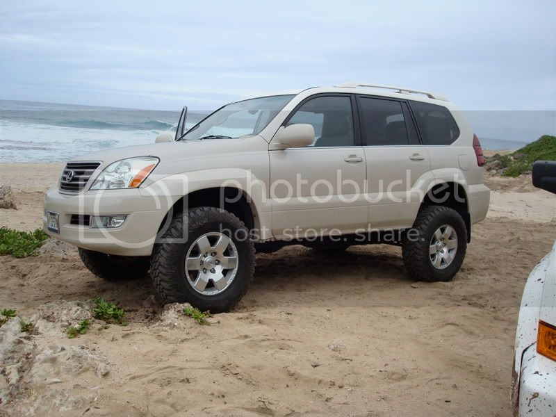

I, my brother (ObsessMuch) and several others have swapped to coils. I personally have noticed a firmer ride (I got heavy springs due to my offroading). With my aftermarket bumper and gear in the back it is a great ride. If you were to go to a stock or just over stock lift it won't be a huge sacrifice and it certainly will eliminate the possible airbag problem!

Dan - I LOVE the ride height of your truck and... Yes, we do have the same year. It looks incredible!
I also like Overacheiver's ride height and his use of FJ wheels?
