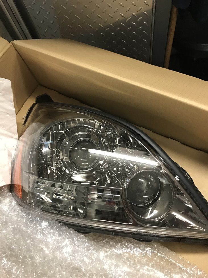

Got the 1st wave of parts for the rebuild! OEM LCA's and cam bolts, driver's side UCA and bolt, front swaybar bushings, and some sport trim headlights!
