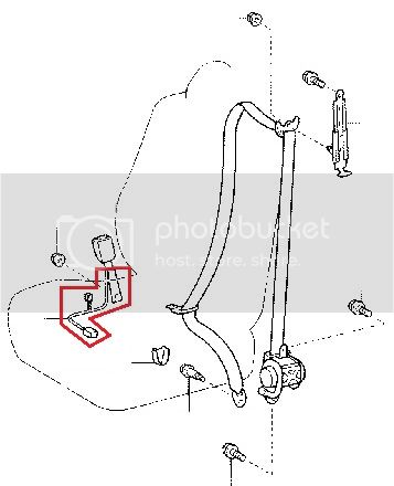

Got some work done on the GX last night. Went over to a buddy's place and repaired the harness under the driver's seat so the SRS dash light doesn't come on anymore
When you say harness, are you referring to the seat belt buckle w/ the attached harness?
http://s140.photobucket.com/user/rrcompton/media/Lexus GX470/7323060420B0.jpg.html
My light recently came on. I removed the buckle and cut away the wire sheathing but I didn't find any damaged wires. I'm tempted to just replace the buckle anyway to see it it fixes the problems since it's cheap.
http://www.oemtoyotascionparts.com/oem-part/oem-lexus/buckle-end-left/7323060420b0
If memory serves me, the broken wire was on the chassis side of the buckle harness, replacing that involves tearing apart the driver side dash. It's from the power seat moving back and forth, fatigues the wire and eventually breaks.

I just pulled the code and got a B0101/14, so more than likely it's the clock spring. I've had problems w/ the volume not working on the steering wheel controls unless I have the steering wheel at full lock...so I'm hoping that's the problem. If not it gets a LOT more expensive if it's the center airbag sensor.
