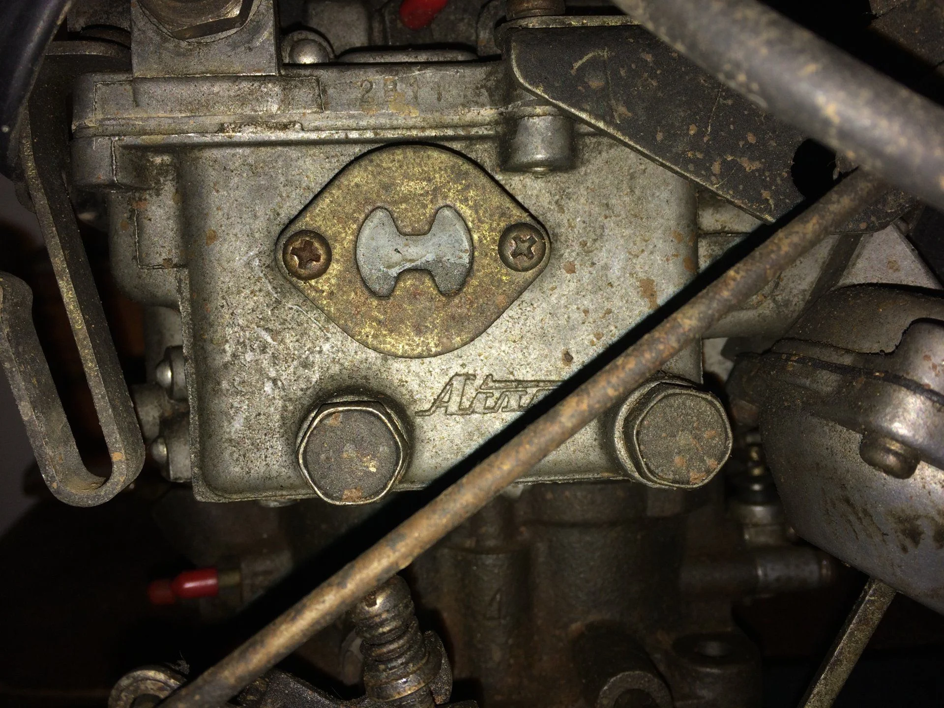

You don’t need to pull the glass cover. Don’t even try. Once you remove the screws and the metal oval the glass is by itself and is pressed in with an o-ring under it. The risk of breaking the glass is pretty big. It’s tight as hell. I’ve tried and it’s not as easy as it would appear so I left mine alone.

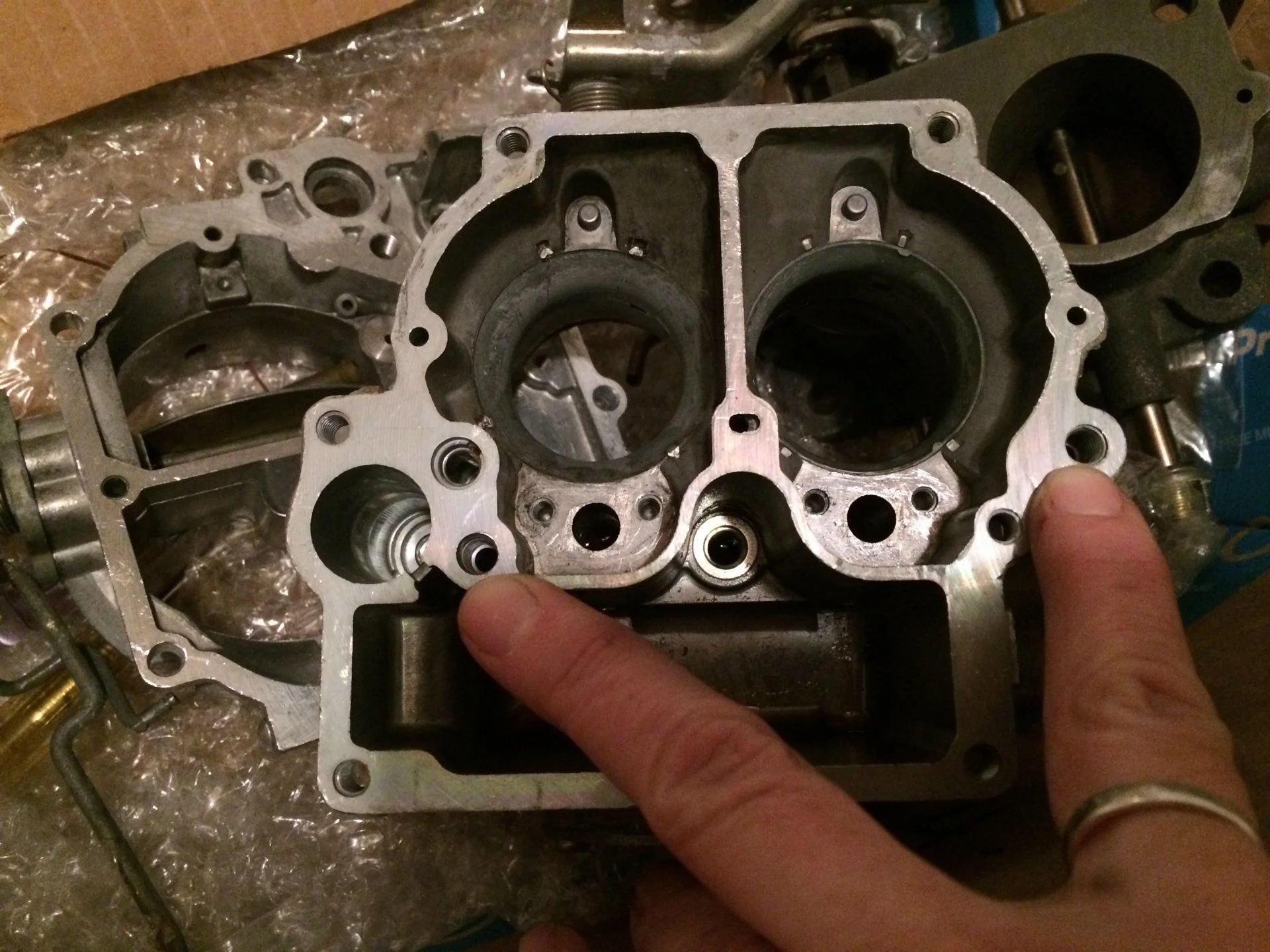

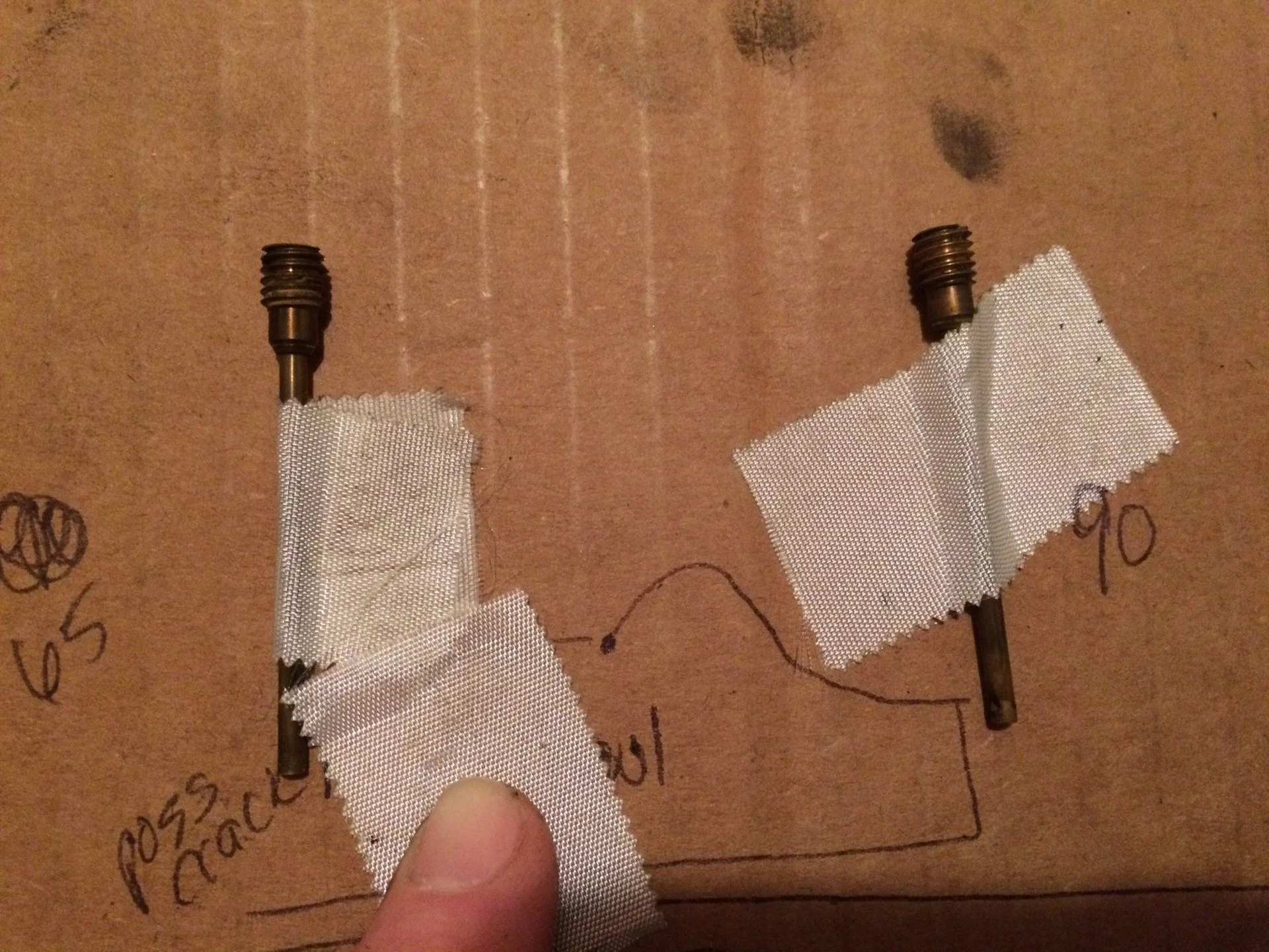

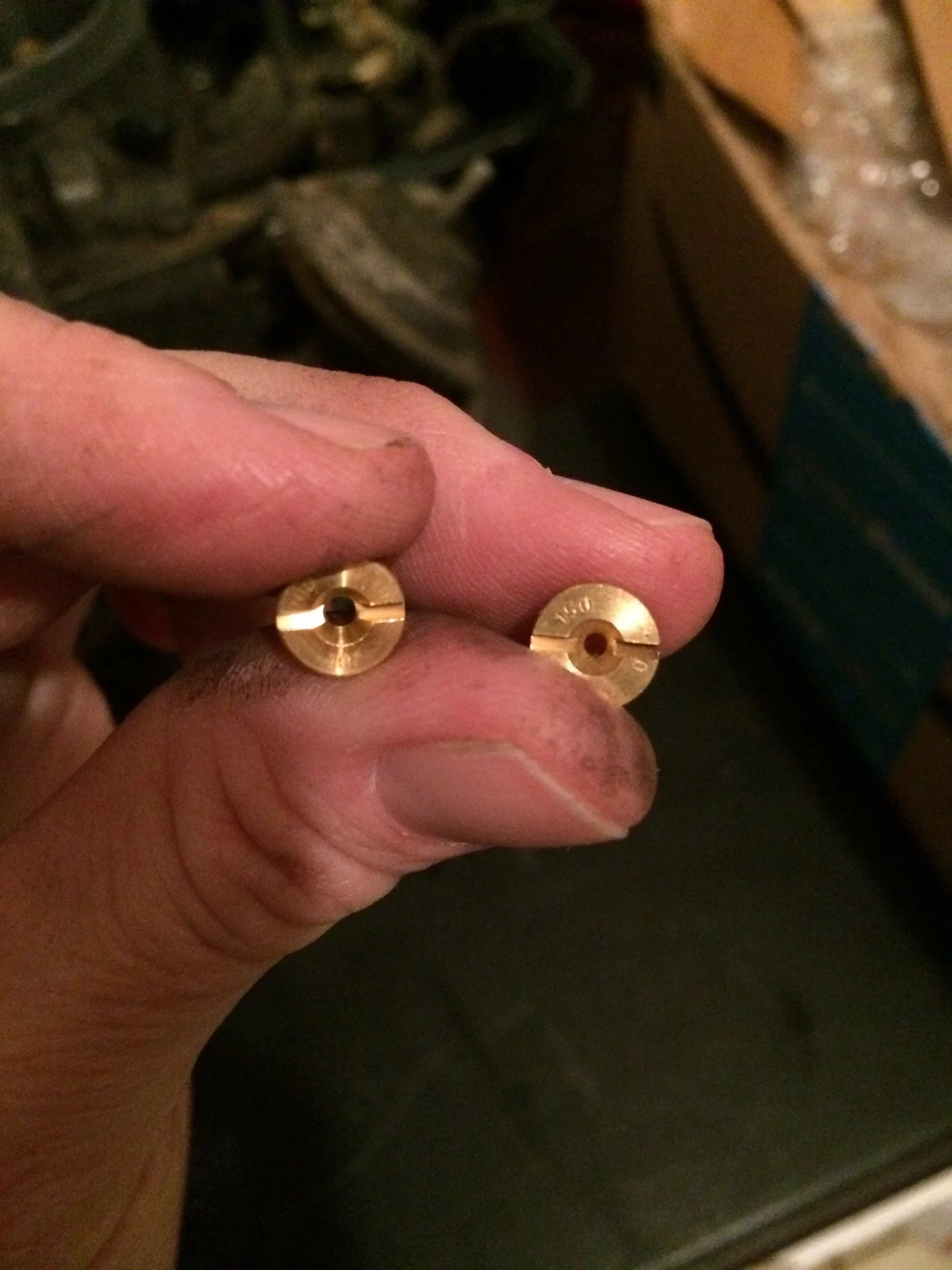

You can very simply open up the two bolts that are at the base of the bowl. (This is how you can access the two main jets). Fuel will spill out. The main jets are the two small brass plugs seen in my last photo that can be removed w/ a flathead. The holes in them are much larger and a bottle of carb spray w/ the straw attached can get a good stream into them.
The slow jets are accessed once you open the air horn of the carb (the top section). Those are the two you can feed a very thin wire into and make sure they don’t have debrie caught inside.

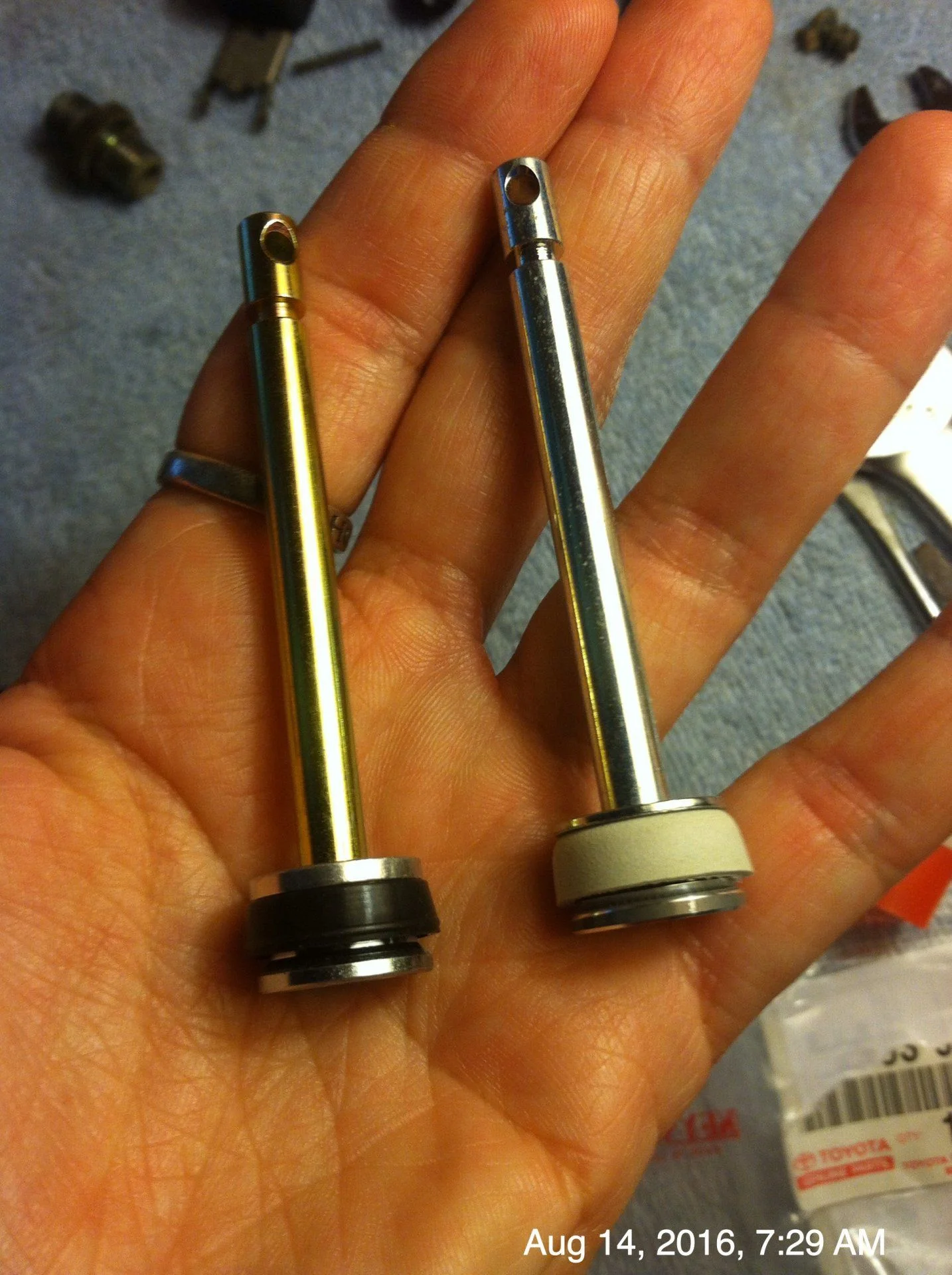

There’s no accelerator pump diaphragm. There’s an accelerator pump... and it might be old and worn out. A new one from your dealership is best over an aftermarket one as the material is leather on the oem one and rubber on the aftermarket. Leather is preferred cuz it slides much smoother. It can easily be swapped out w/ carb on the truck.

Are you indicating that the slow jets are located as shown? I'm interpreting your pics as 65 is on the left and 90 is on the right (if the float bowl is closest to you).
Yes
