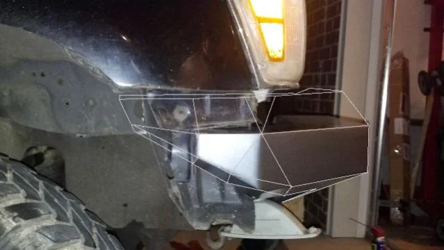

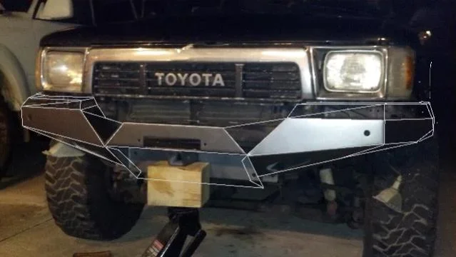

Thanks Meigs, the bumper was $500 plus shipping. I do not have a body lift, that is just the gap that it had when i bolted it on. I really like it other than the gap too, but i won't run it with that gap. I played with paint today here is what I am thinking to take care of the gap.
I am still playing with it, but i am thinking I could use some 1/8" plate to build the upper section since it is more for aesthetics. I am hoping to get my MM211 wired up soon and this will be my first project, and I have been asking around to see where to go for steel stock.

That looks pretty cool, more than I was thinking but it would work.
I was just thinking of a vertical piece of steel along the back edge to cover the gap.
Or add some plate to the bottom and drill new mounting holes to relocate it so it mounts higher. Easiest and cheapest way to do it, you just want to make sure your winch will still fit.
I like your solution however. Add steel to front and top and a couple reinforcing pieces here and there. It would look good and probably help. You would have a one-off bumper then. It will just take more time to make templates and cut out all those pieces with a grinder, unless you have access to a shear, that would speed it up for sure.
If you can find someone with a tube bender you could add a hoop to help protect the front and blinkers, kind of like an ARB.

I think it's still savagable. I would just make a bracket and raise it up a bit. Just make something that is trianglated that ties into the crossmember. Put a coulple of gussests on it and roll with it. If you don't put a winch on it then it should be fine.
Great looking bumper, with a little finesse you should have it.
