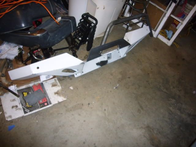

New Front Bumper... Finally Mounted and Removed

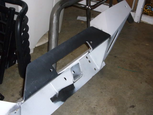

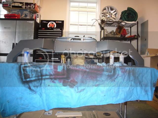

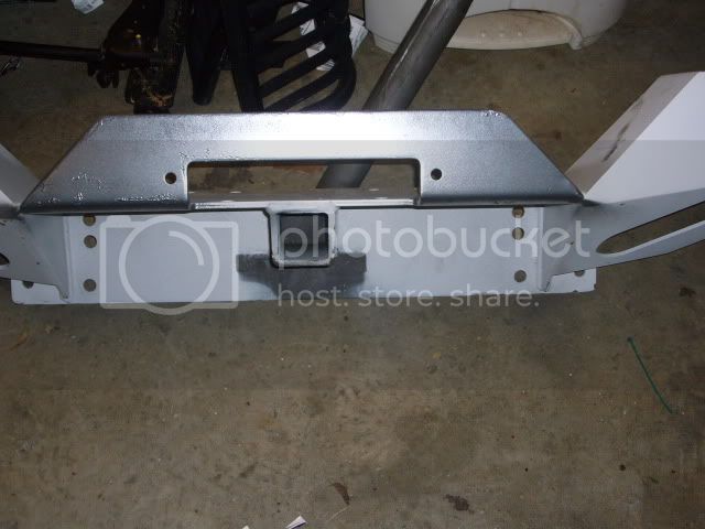

Got my new bumper from Golden State Motorsports.
Sorry for the messy garage in the background.

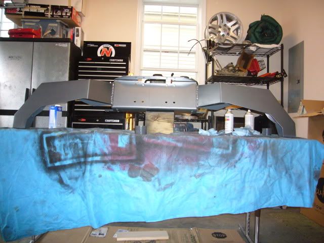

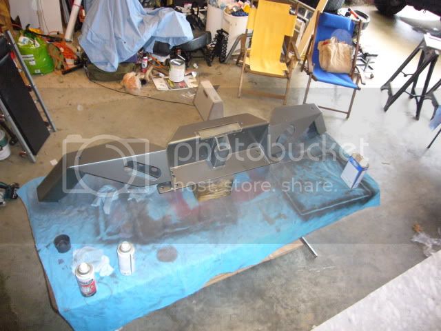

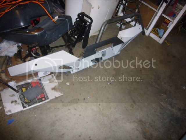

I am playing with paint colors. I have pretty much decided on gunmetal for starters. Sorry for the flash in the center but you get the general idea

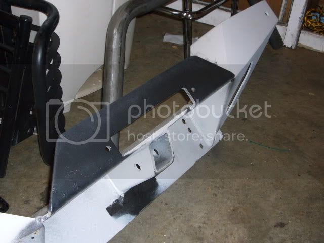

They shipped it primed white and as you can see I will have a little bit of sanding and some touch up priming before I do the entire bumper. I hope to get it cleaned up and painted this weekend. Might even get it mounted if the rain will hold off.
You can also see the hoop in the back ground of the first picture. They shipped it un-welded which will let me place myself (once I get the welder wired) and also saved me freight charges since it was small enough to ship UPS.
It is built off of a Trail Gear winch plate with wings added to it. The wings are gusseted in the back and the bumper is pretty beefy. I will post some pictures of it once I get it all painted and mounted.

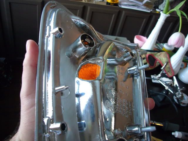

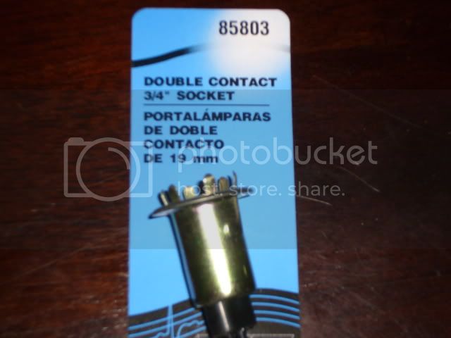

Well, I spent tonight studying the turn signal situation. I have a pair of new corner markers and some 1157 bulbs and sockets that I have been playing with. I have picked a socket that i like because it is very minimalistic, problem is that it was made for a tail light that allowed the lense to be removed to change the bulb, ie. the socket is 1.01" in Dia and the bulb is .99", so to have any room the base wouldn't be able to hold the bulb in place, so I need to make a base for the socket to mount in that can be removed with the socket during bulb changes.
My plan is to get a piece of sheet styrene and make a base to mount the socket to and then drill and tap a couple 3mm holes to mount the base to the modified housing. I need to pick up some sheet styrene at the LHS to play with and start working on modifying the housing to make sure the bulbs won't sit to deep inside.

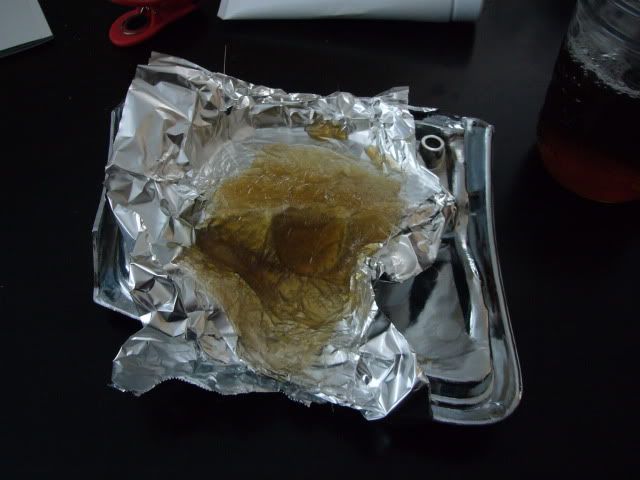

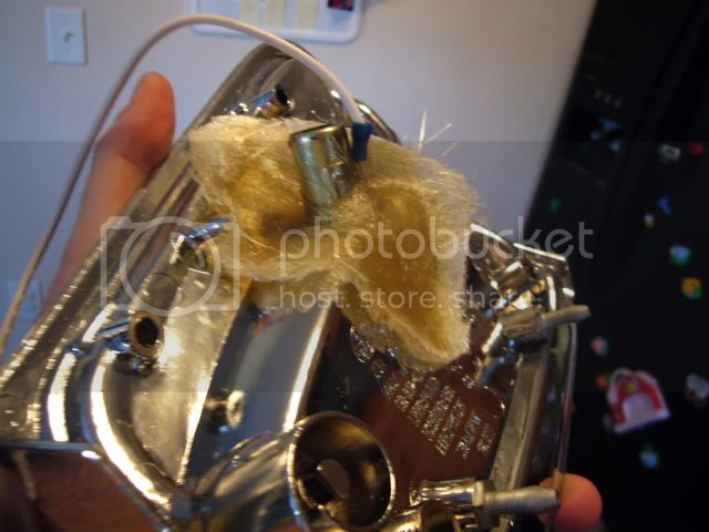

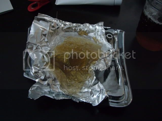

Well, I am still not sorted on the turn signal reworking. I have bought several different kinds of sockets in an effort to get what I am after and I cannot get it trimmed down to fit right, sooo, I think I may try my hand at fiberglass this weekend. Anybody got any pointers. I think I can put some foil on the lamp housing and use that to form against and then glass the socket into it so that I have something that fits snugly and that can be removed.
I know I am way over thinking this, but I just haven't found a fit I like and I have only found one socket that is the size I am looking for, but it isn't big enough to seat properly once the hole is cut out for the 1157 bulb.

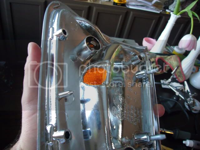

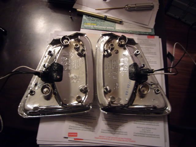

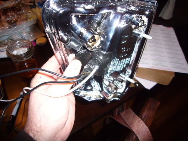

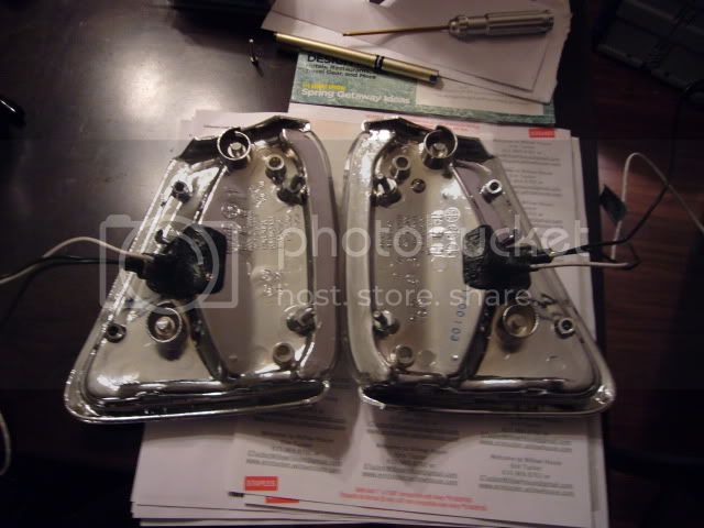

So I picked up some fiberglass and got a test run in on the lights. Once I know everything is going to go together like I want then I will post a how I did it post. Anyway so far I am happy. This one needs the edges cut down and a little paint but so far so good.
housing trimmed

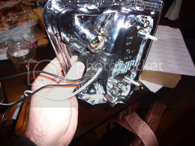

And the glassed in socket. It is removable for replacing the bulbs.

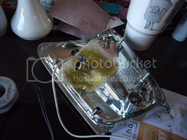

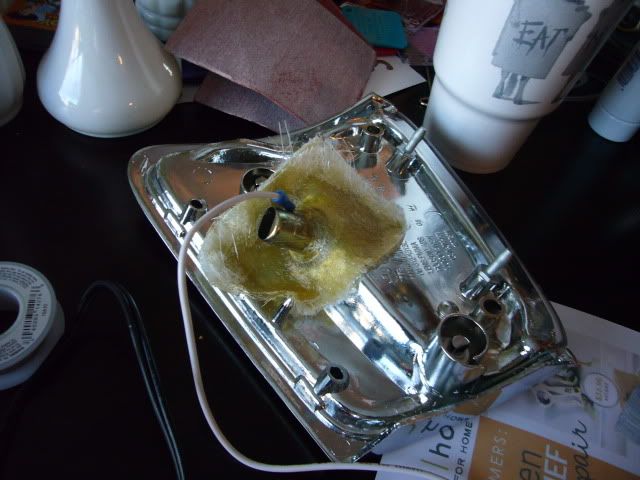

Just for kicks here is the breakdown of my marker light conversion.
First I glassed up the back of the housing.
http://i84.photobucket.com/albums/k8/mrtucker80/P1070416.jpg
While that was drying I got my socket ready
http://i84.photobucket.com/albums/k8/mrtucker80/P1070414.jpg

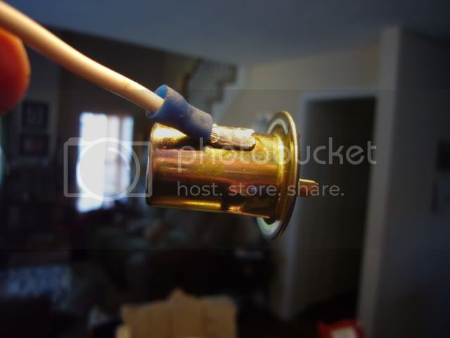

This particular socket is made for a metal housing, so I soldered a ground wire onto the housing.
http://i84.photobucket.com/albums/k8/mrtucker80/P1070428.jpg
Once the glass was dry I used a 3/4" step bit to drill out the hole and glass in the socket.
I used the dremel to open up the hole in housing (see previous post) then trimmed down the rough fiberglass mount and threw on a little duplicolor bed liner to hide the rough shape of the fiberglass and popped them into the housings.
http://i84.photobucket.com/albums/k8/mrtucker80/P1070431.jpg
I used two 3mm screws to hold the new socket housings to the original marker housing and TA-DA.
http://i84.photobucket.com/albums/k8/mrtucker80/P1070434.jpg

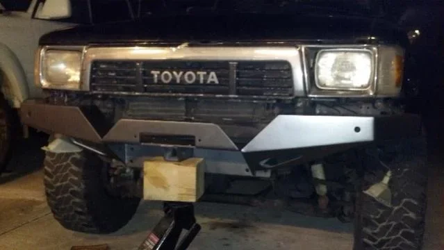

Got home tonight and once the little princess goes to bed I'm going out to get the factory bumper off and make sure i got what i need to wire up the new turn signals. Bumper should be on tomorrow before lunch, unless i get a wild hair and try and bolt it on in the dark tonight. Its pretty mild here tonight so if I have the hardware it may be on before bed....
News not so Good.

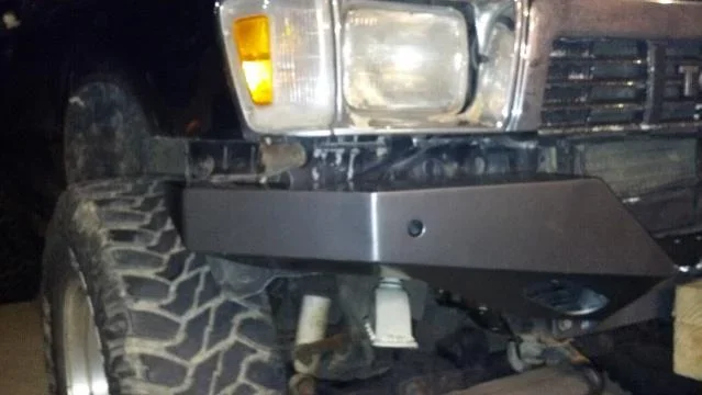

Well, I am kind of bummed out... I got the stock bumper off and got the new GSM into place with one bolt in to make sure it was up to the correct height and it doesn't fit very well, well it would bolt on, but I am not happy.
I am not going to post any pictures right now until I hear back from the guy I ordered it from. Hope you all understand, just don't want to be one of those, "well you should talk to the company before....." Posts.
Hope to hear back soon and then I will post up the pictures. I sure am glad I didn't pretzel the old one in celebration before I did the test fit. Well on the bright side, I can replace the grill and get my new turn signals in:meh:
I had it shipped at 80# but it actually comes in around 65#.

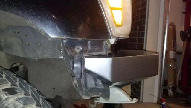

Bolted up and Taken back off...
Well i got in contact with the guy i bought the bumper from and I am not sure how all that is going to go, but he doesn't seem too concerned about what may come, so here are a couple pictures.
Needless to say I am not too happy with the way it fits.
What say you guys? Should I be upset? I've seen pictures of these on other trucks and the gaps weren't this bad, even the seller said so.
Oh and sorry if the pics are small, the princesses have both computers so i am on my phone.
that is a cool bumper, too bad the gap is so big. What did you pay for the bumper? Do you have a body lift on your truck?
I don't know if you can weld but here is one option:
make an adapter spacer plate that bolts on to the frame and then bolt the bumper on to it. Or add more steel below the center and drill new mounting holes to move it up.
I would see what kind of room you need for a winch in there before moving it up any.
Another option would be to weld steel on the back of the bumper lip that sticks up 2-3" to fill in the gaps between the body and bumper.
Other than the space I like that bumper.
