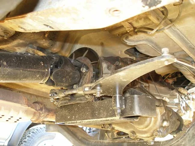

since i'm lookin at a 60series drivetrain for my 40 project i figured i'd chime in on this...
what other e-brake options are there other than a line-lock?
i thought the point of the emergency brake was to provide a mechanical backup to the hydraulic brake system...so if you lost fluid pressure you could still stop.
i've seen the transfercase mounted style (which i like), but wondering if this is the only other option.

this pic is from Razor's minitruck...

If you're going for 60 series axles they'll have the e-brake setup at the rear drums already ;) You're absolutely right on the second part - the line lock is a compromise to get your truck inspected in states that require a working e-brake. It's also good for holding your vehicle on the trail etc, but does have a single point of failure ...

BTW - Cadillac Eldorado rear disk calipers have a provision for the e-brake as opposed to the Monte Carlo calipers most people use on FJ40 conversions ...
