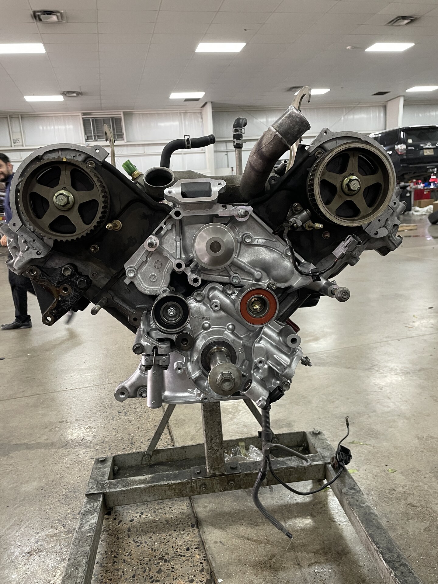

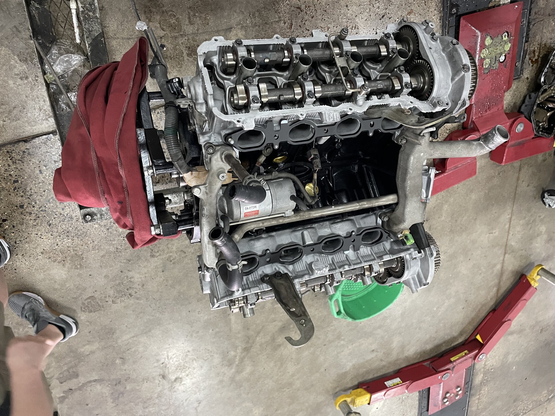

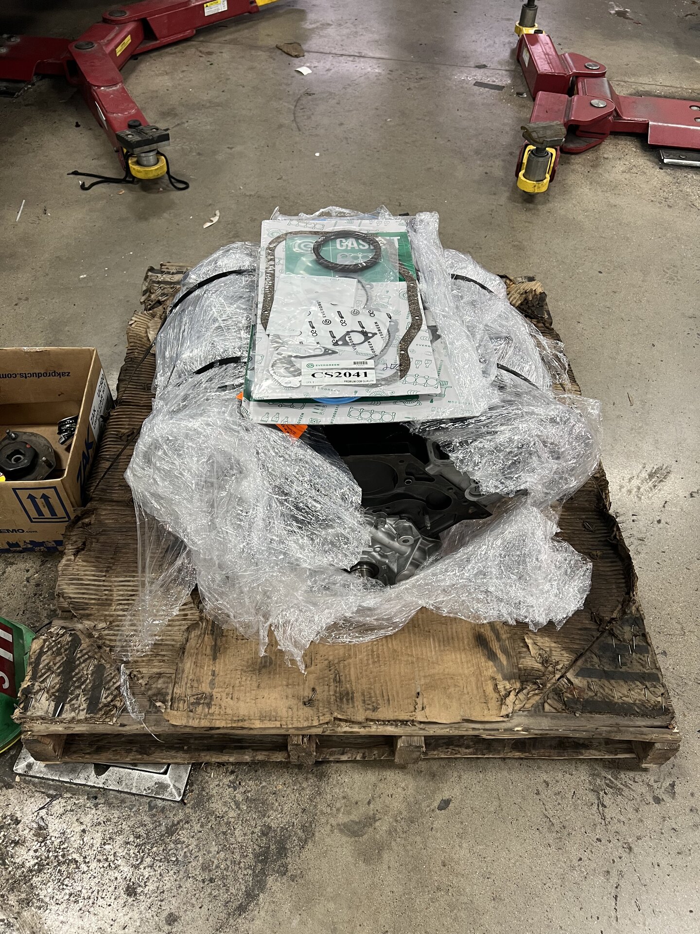

It was $3950 not including $500 ship including core ship back. There was also a $650 core charge deposit I should receive. No tax. However, it shipped with an oil pump not compatible with my VIN so there has been significant additional labor involved to get that replaced. They say their warranty does not cover labor so we will see what happens with me trying to get reimbursed. It will be costly. They also shipped it with a gasket set of the brand "evergreen" instead of their stated Ajusa so that cost me an additional $350 to do Toyota OEM. Other stories to tell, but I'm still waiting for my LC! It should be ready tomorrow but I'm out of town of course...

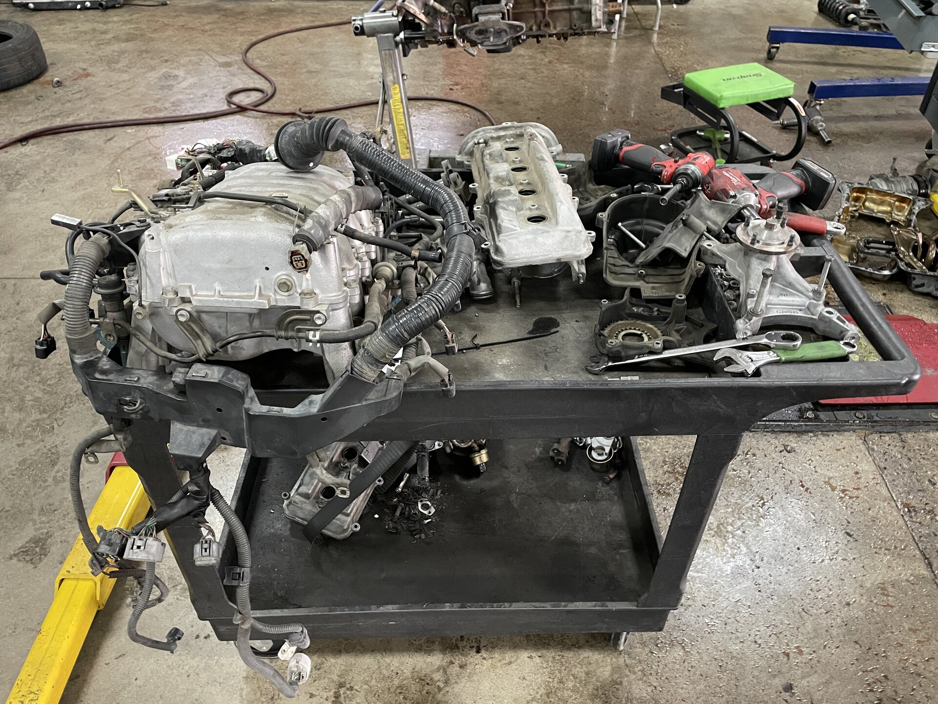

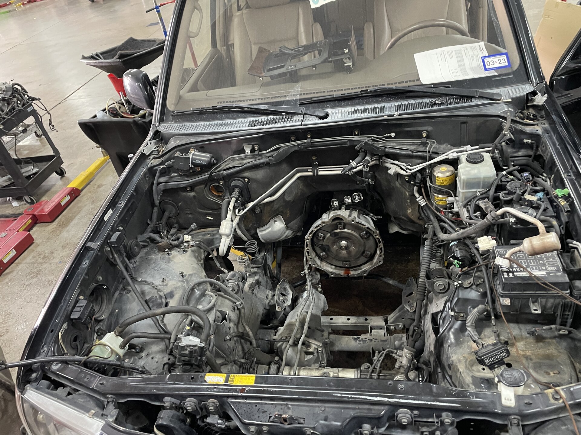

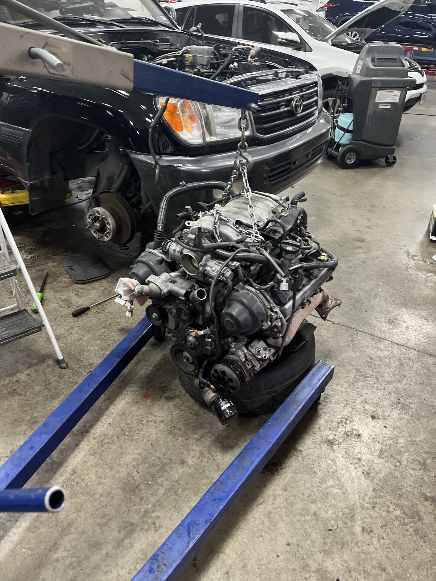

It's turned into a bit of a saga, for me at least. I am still out of my LC. After toiling for a week or so while the car was at Toyota of Dallas, I finally pulled the trigger. The engine arrived fairly quickly. Maybe 4 days after order? Then a week delay due to backorder of a gasket set I should not have had to purchase. Another week of trying to find a replacement of my timing belt sprocket that was chipped. They are supposedly saving if for me for a paper weight. Along with a host of hoses and other minor things, they are changing the motor mounts and the fuse box that I had already and planned to do myself. Everything else from my engine is good to go. I had the shift knob and center console armrest re-covered and plan to do the front seats as well. Toyota of Dallas has been great to work with even though it's taking so long! Alec Raetz is foreman I'm working with and he's all over it and seeming to have a good time as well so that's good. They are good guys. It's going to cost a couple thousand more than I had anticipated, but hopefully not more than what my outside estimate was to begin with before working the costs down as much as I could. They showed me under the intake manifold where a squirrel had been putting acorns! It was so full the starter was half covered. I don't get it because the car stays in the garage most of the time. Anyway, I will report back soon!

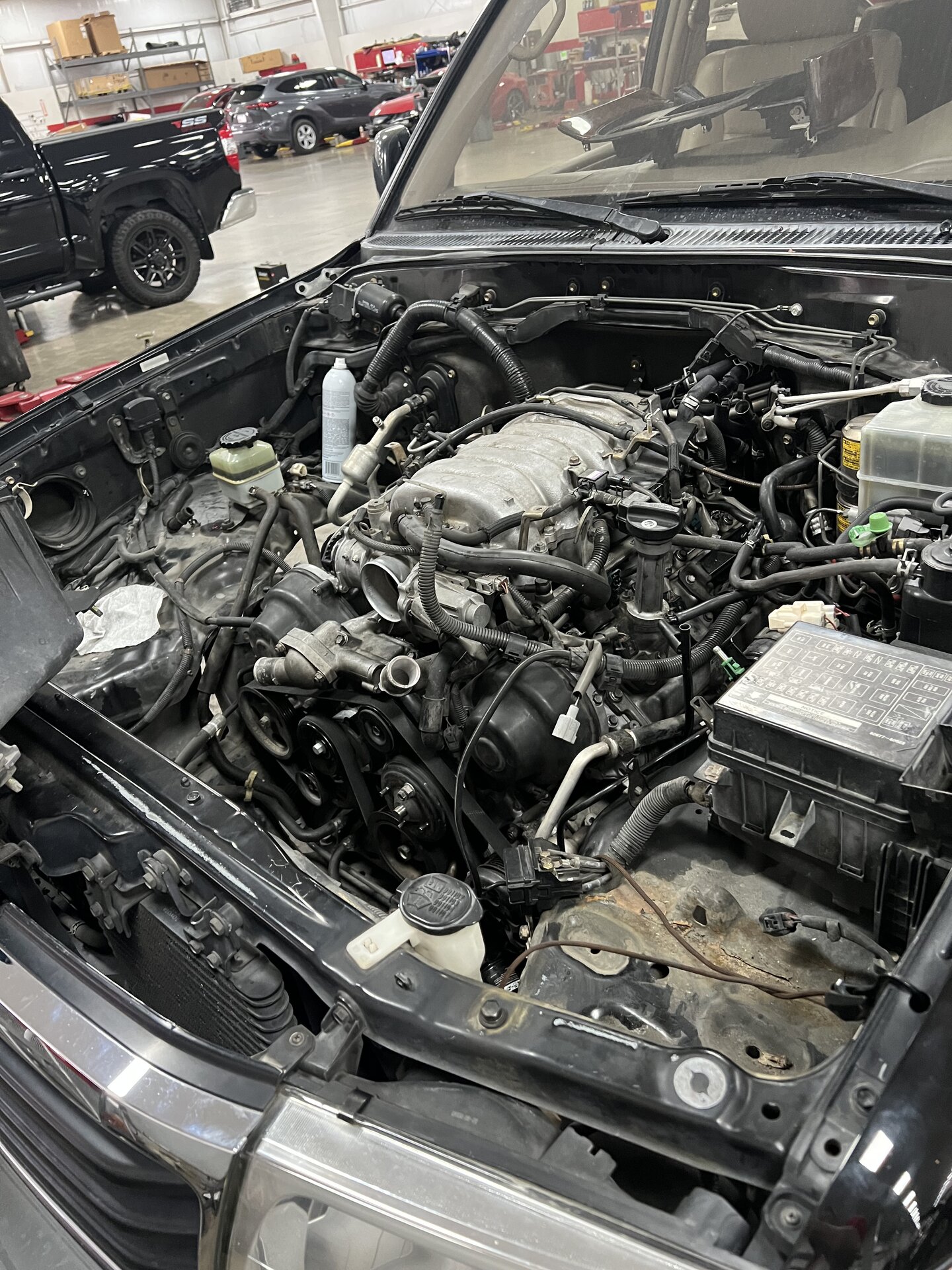

Hi 2001LC. Thanks for the message. On the 2019 work, there was no other work or condition noted. I was not given or shown any pictures from any diagnosis, but I was verbally told the compression differences between cylinders and that #7 had almost none. I do not remember the numbers. It was noisy and the engine was shuddering at that point when I finally decided to bring it in. I visited the car today and they started it up. I can't believe how smooth and quiet it is running now; it's incredible. They broke the fan shroud and somehow lost the dipstick so they're waiting on that to give it back to me hopefully tomorrow.
