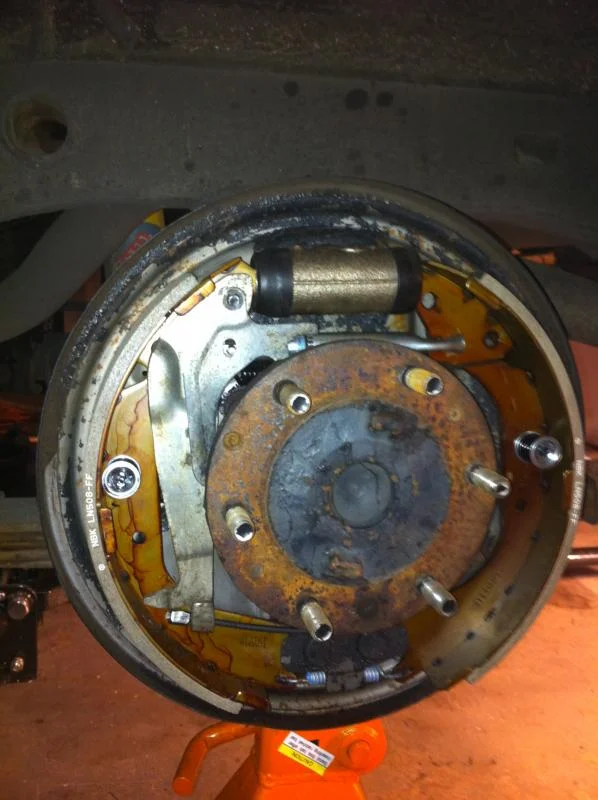

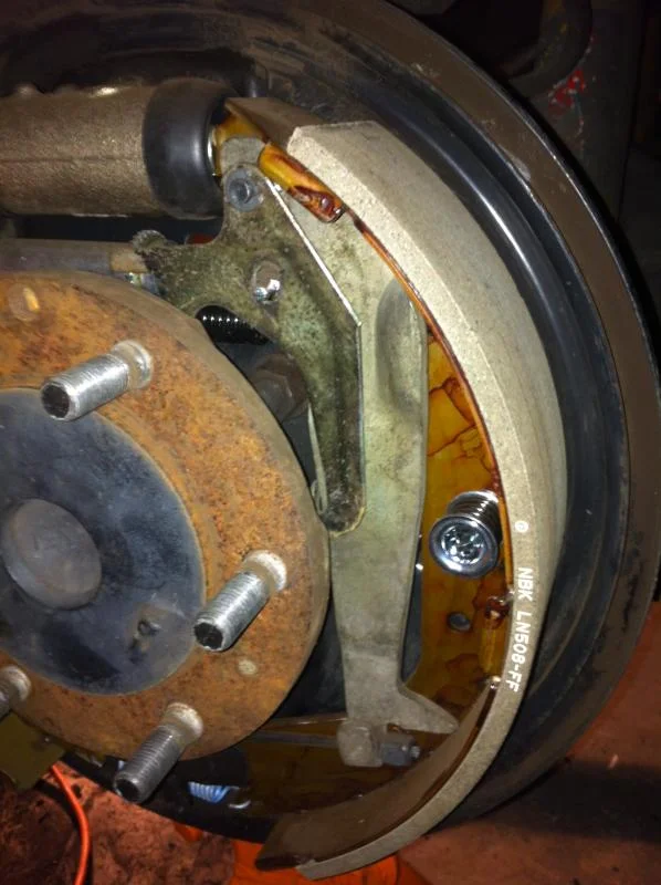

I'm pretty sure I put everything back together correctly. I laid everything out and put the new components and shoes together with the old shoes and components next to it. My adjuster was brand new OEM but I still adjusted it all the way out before I put everything together and put anti-seize on the threads anyways then adjusted it all the way closed before I put everything together.
Perhaps someone can check out these pictures I snapped before I put everything back together to make sure everything looks right. It's tough to see in the photos but there is an R stamped on the passenger side adjuster level so I'm assuming I that is at lest on the correct side.
Still a little fuzzy on how the adjuster is supposed to work and I feel pretty good that 2 folks with over a thousand posts are not in agreement on this subject as I am admittedly still lost on how the system is "supposed" to work.
