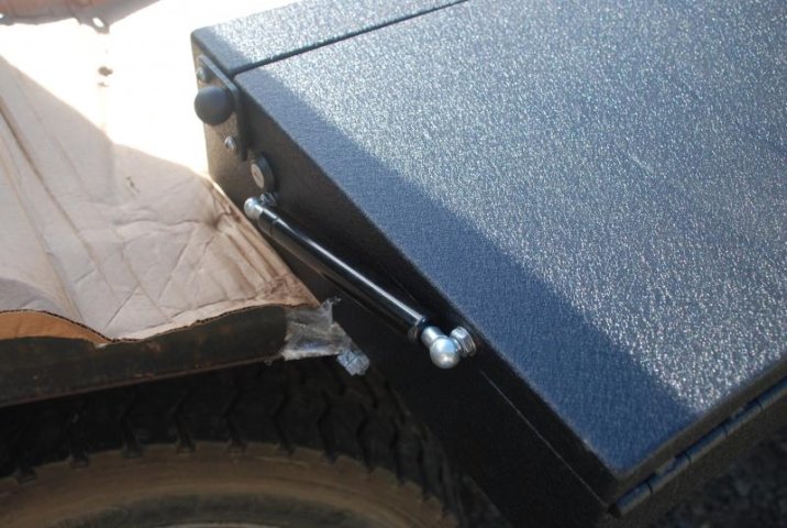

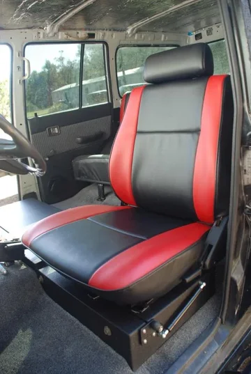

Dang dude it's just too easy put it in for fitment and never took it out. Everythin fit first time only problem I had was some paint on the threads and you had nothing to do with that. I told you I could break an anvil with a rubber ball. Modification of the stock mounting bracket amounted to cutting off the lower projections and drilling out two rivets one fore and one aft. Locating an appropriate position in the truck and drilling 4 holes. Done.

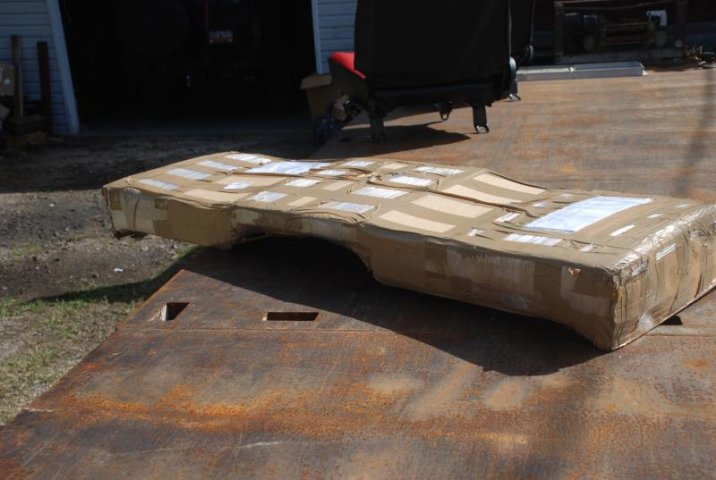

Package as it arrived no damage well one lift rod was bent but I bent it back so all is good also cardboard on the corners wore through and rubber the powder coating off, nothing a little black paint didn't cure. 005.webp
marine carpet
Had this done locally less than 300.00 for material and install.

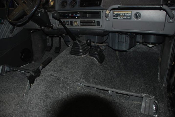

And the rest of the story

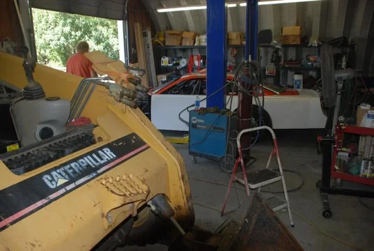

As I own the shop I have another fellow who works there every day doing large truck and forklift repair. Keeps someone there while I am away, but it can be destracting. Also was working on these today the reason I did not get both seats installed.045.webp

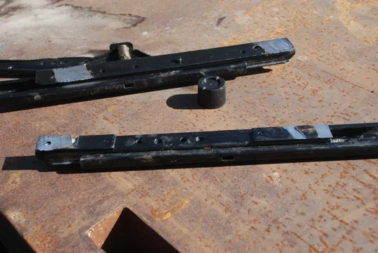

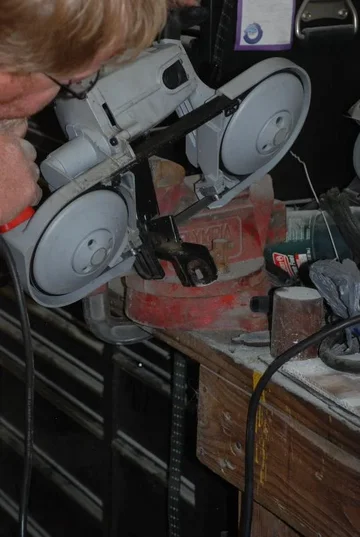

And a shot of cutting off the brackets for the seat sliders
Then just install on the seat , put on the box and mark the holes for drilling drill 4 holes and done dude this is just tooo easy, just like always thanks Kevin Now when is my window coming?:)
