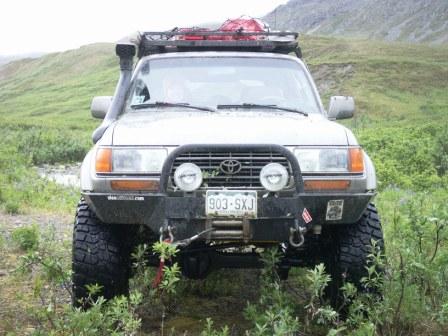

345 KM2's
I am running them with a Slee 6in lift. Very little rubbing albeit I had to get the dremel tool out to cut into the fender flares. I do rub the wheel well at full stuff but nothing I am concerned with at this time. I will eventually increase my bump stops by about 1/2 and in and that should do it :)
They took me to Alaska and back as well as some local wheeling in Colorado. They ride as nice as the Toyo MT 35's with about the same noise I believe but that is why I have a big stereo... :grinpimp:

Thanks Nemo, I think you may be the first to run these. They look huge!:D How do they measure on that 8" rim?

Nemo,
Now that is one tough looking vehicle. I only have a 3 1/2 inch lift and I am pretty sure I'd need Slee's 6 inch lift to run those tires. They are HUGE!!! Reminds me of some pictures I have seen on the web of some TLCs in Iceland.
I am glad to hear the good news on the KM2s. I hadn't done a lot of research but my experience with BFGs has been stellar.
It will probably take me a couple of years to wear out my new 35 inch KM2s but when I do I'll likely buy 345s to replace them.
Thanks for the pictures! :clap:

Based on Nemo's pictures, I don't think they will stuff very well unless you have a huge lift. These are VERY BIG tires. You have to love how they look!
Nemo, I think that those tires look killer on you truck. Are you running any wheel spacers on that set up? If so, What size?

I am not sure I would state you must go 6inches but for me it is ideal. The tires do rub slightly but not so much that I am concerned. The fender flares needed trimming and I get a slight rub on the inner lip of the metal wheel well. Not enough to even consider cutting yet and I have had it articulated to full stuff. The 6inches allow for more movement in the fact that the wheels are angled just enough to allow the wheels to get inside the wheel well. 4inches of lift would suffice if done with the right bumpstops but I would think the articulation would be affected?

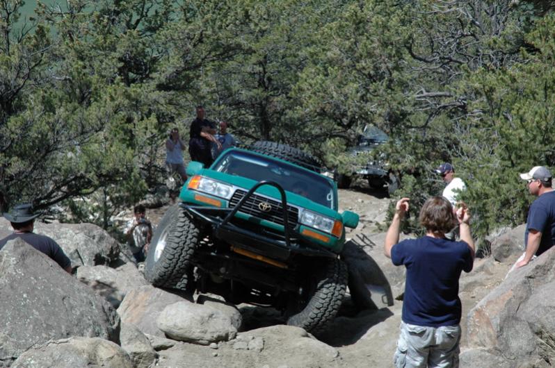

I have a 3.5" lift and 37x12.5 Trxus MT, which are not a 36" size tire. They stuff perfectly with a well balanced suspension although I had to lengthen my LCA's 3/8" and trimmed a little bit off the rear fenders, but you don't need extra lift.
Love the look of a 37, you need that much tire on the 80 visually (and in the rocks).
