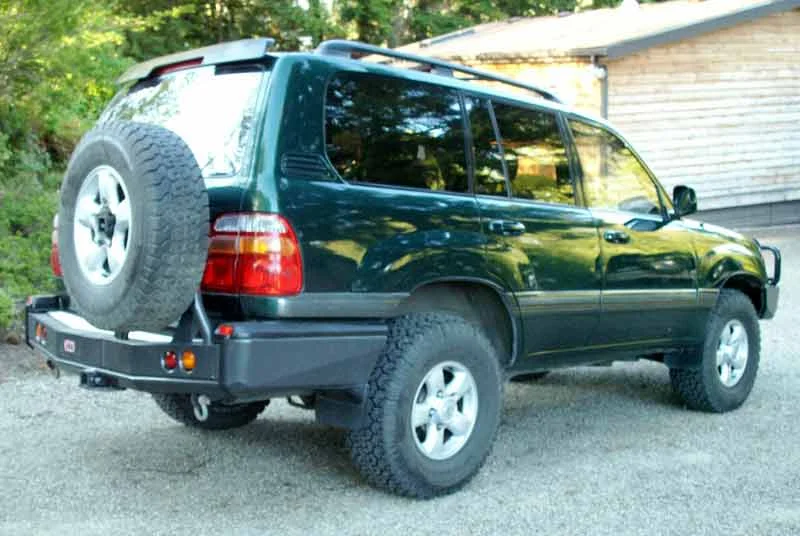

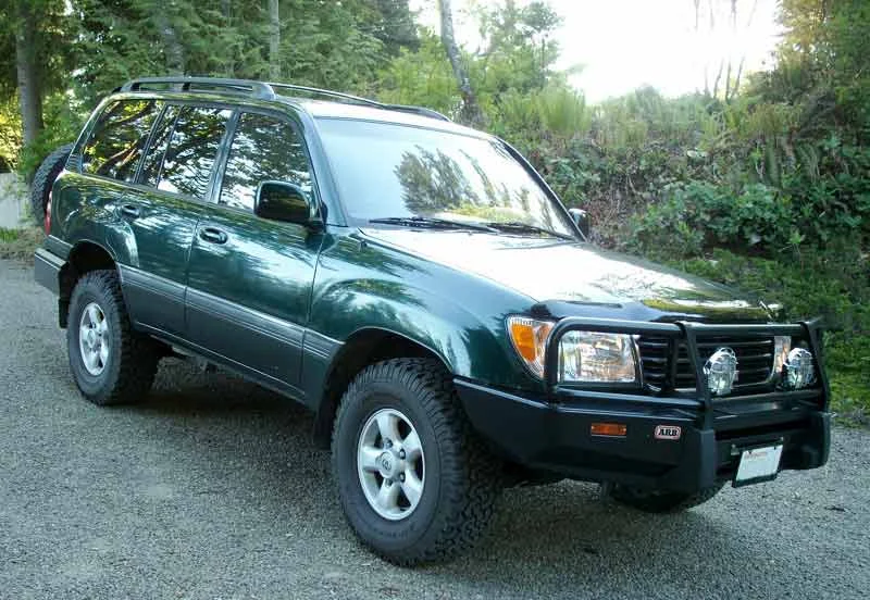

Bloodhound,
Could you post 2-3 pix showing the whole truck, side and rear?
Just want to get a better impression of the look of it.
Details look great tho'.

Here's some photo's from more of a distance. I don't think it's as lightweight as some might think. I wouldn't hesitate to put the weight of truck on and where the original tow hitch had a total of 6 frame bolts and 2 cross member bolts this bumper has 10 frame bolts and 2 cross member bolts. I'll certainly find out! :flipoff2: By the way although I went to ARB's warehouse I called and purchased through Slee Offroad.

I don't have an 80 with a 35 to compare. My tire is a 35. This has been debated often. It's just preference. No one right or wrong on this one.

Oh, I know. I just don't have an 80 with a 35" tire back there to compare to. Comparing ARB 100 with a 33 to my Slee with a 35 isn't a match. The 35 will cut down 1" above and 1" to each side of tire compared to a 33.
Is that what you want a pic of?
Despite the Hi-Lift, I just prefer the tire in the middle and the added view to the sides.
If the car is small I can just see it's roof at a stop light. The 2nd car back I see OK.
The depth of field on this pic is altered because I'm elevated to the road. That's why it looks the way it does.
