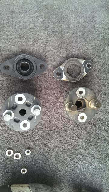

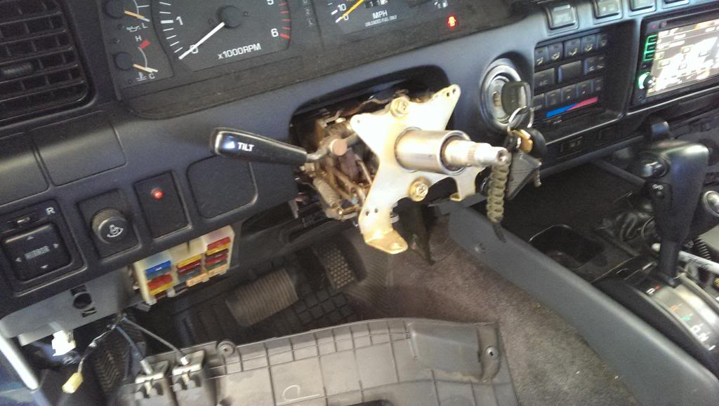

Finally got around to replacing the steering shaft seal. I have had it sitting in my tool box at work for many months, lol. I also replaced the rag joint since it was only one more bolt. The old rubber was wavy and had a few cracks showing.

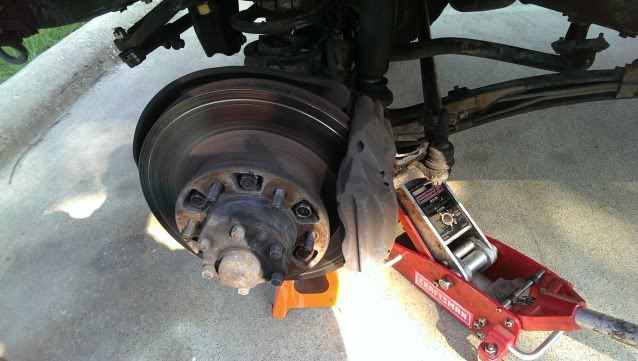

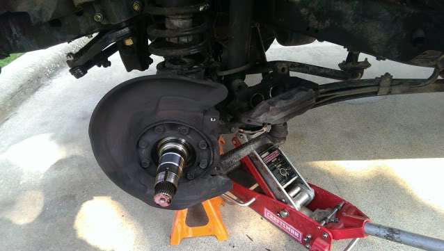

I used one of my days off to replace the front rotors and brake pads and repack front wheel bearings.

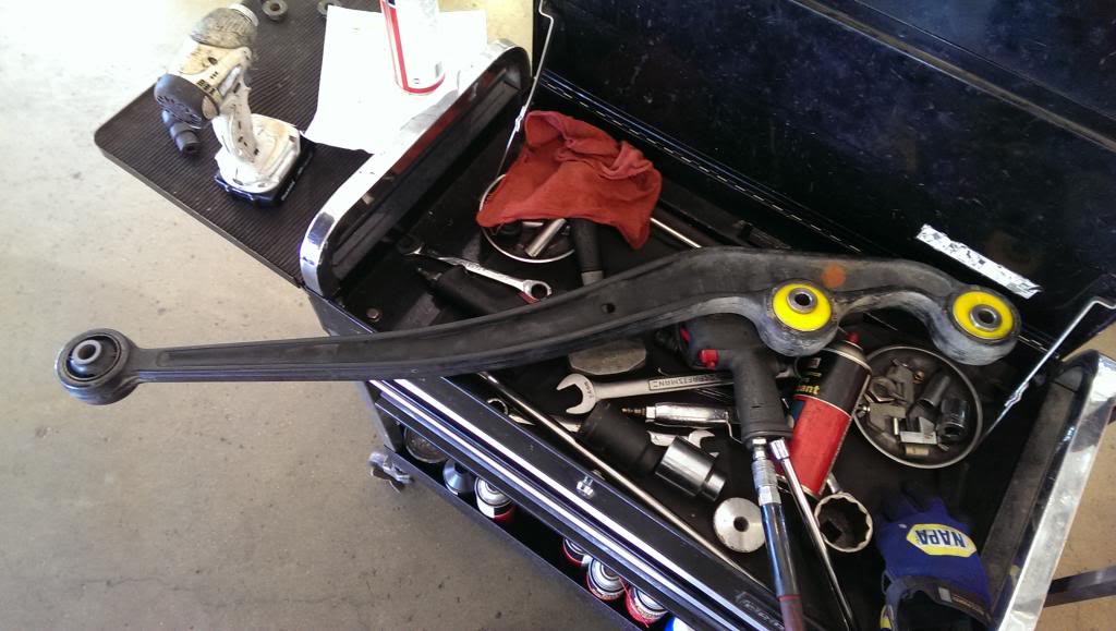

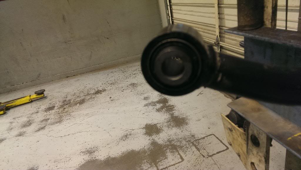

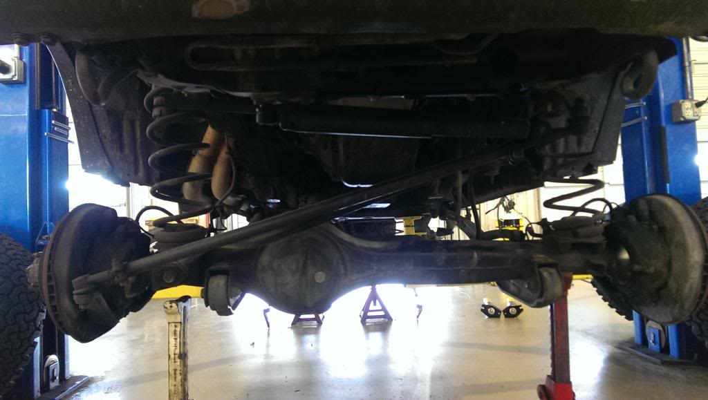

I have a clunk in the front end somewhere and since the trac bar bushings looked pretty worn, I decided to replace them.

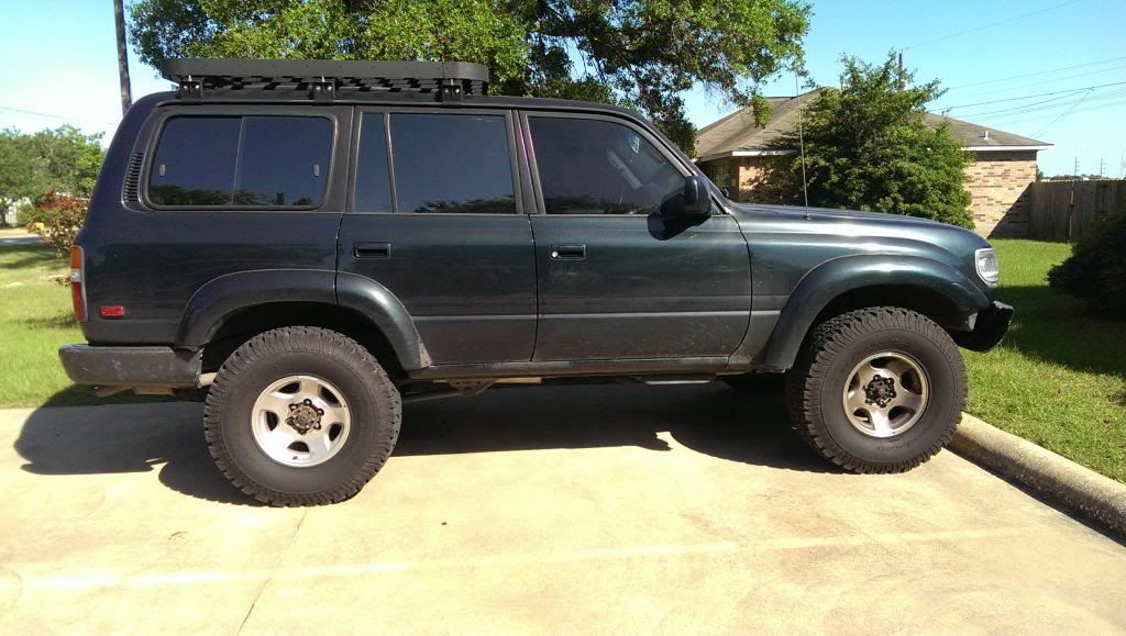

Here are some current pics of how the LC looks.

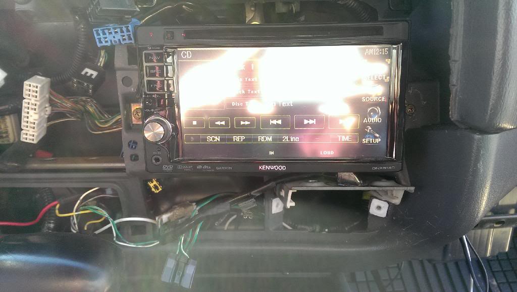

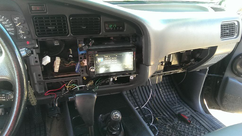

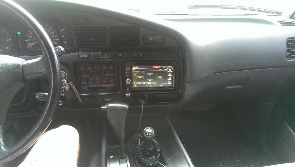

I forgot in my last update that I installed a Yellow box speedometer recalibrater. It has been going for a few weeks now and works great. Today I installed a Kenwood dnx5140 that I scored for free. I will install a backup camera also when it gets here. I also finally bought a welder so armor fab should begin soon.

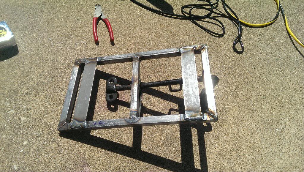

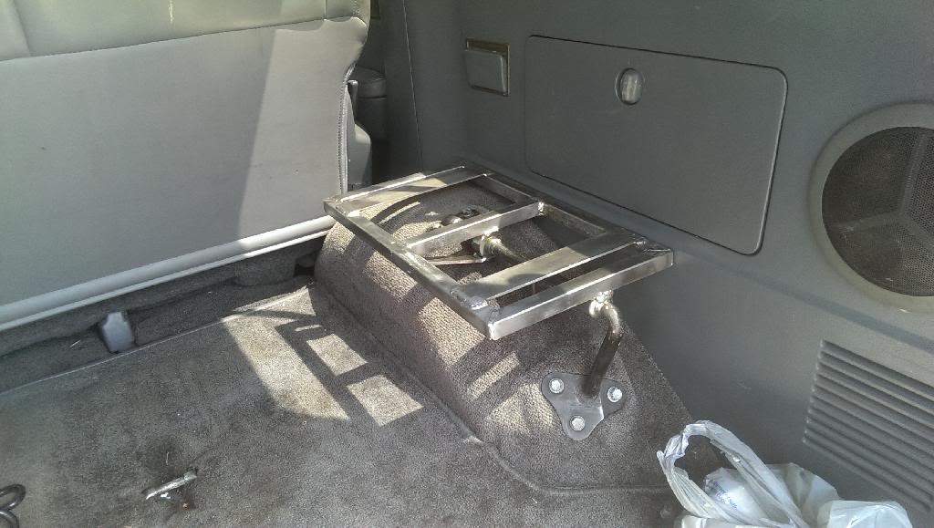

I ditched the York oba and bought a 12v Puma air compressor. I fabbed up a Puma compressor mount using the 3rd row seat bracket. I spent about $30 on steel and bolts from Lowe's.

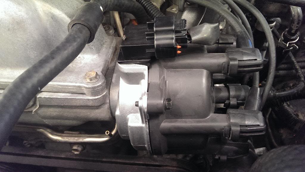

I also replaced my distributor since it was leaking oil from the inner shaft seal.

Did the replacement of your front bushings resolve the clunk? I'm chasing a front end clunk also and thinking bushings could be the culprit.
No. I suspect the noise could be something in the front axle. I have been over everything else and all is good. It has gotten somewhat less intense here recently.

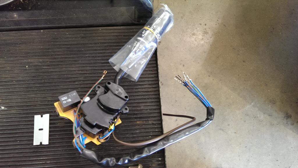

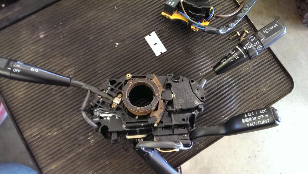

I replaced my wiper switch thinking it would fix my intermittent wiper function. Turns out one of the contacts on the brass plate in the wiper motor was worn. I cleaned the contacts and bent the tabs out for now.

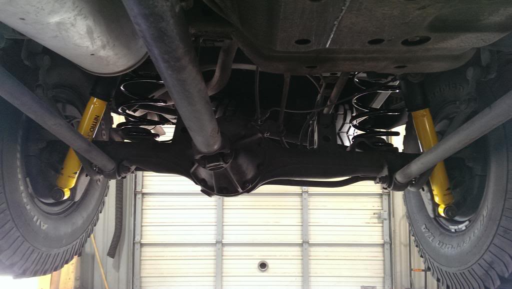

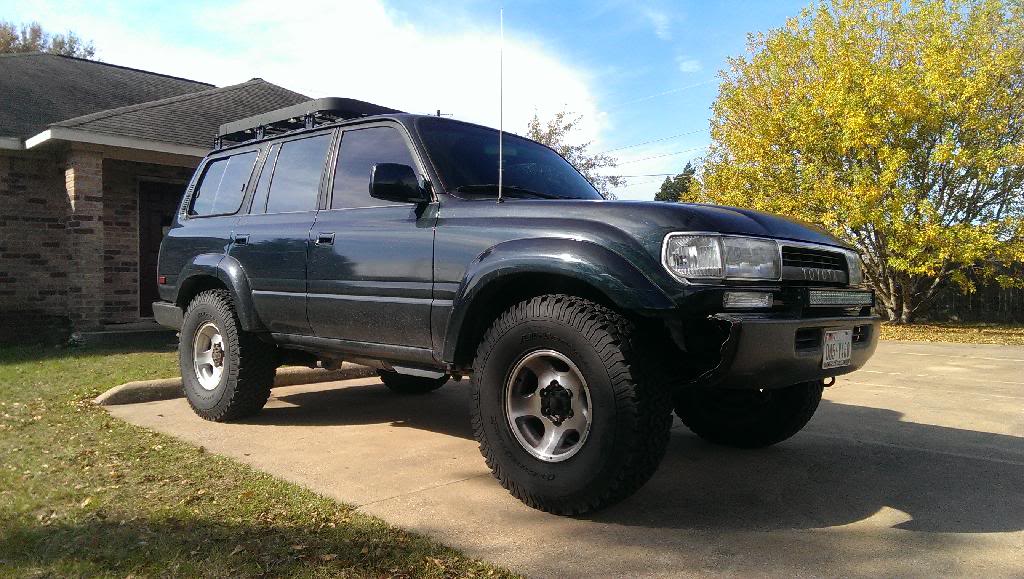

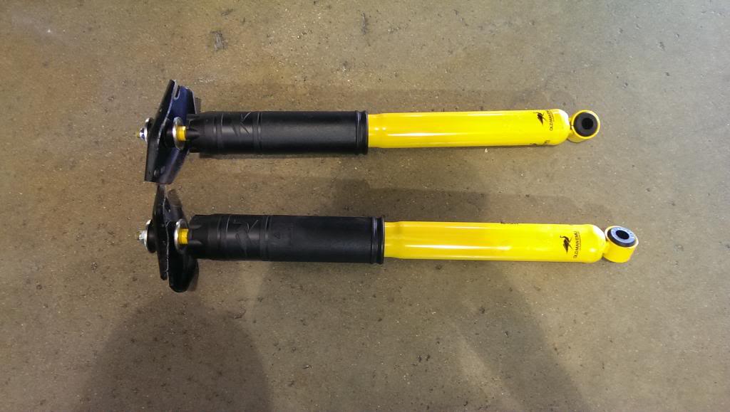

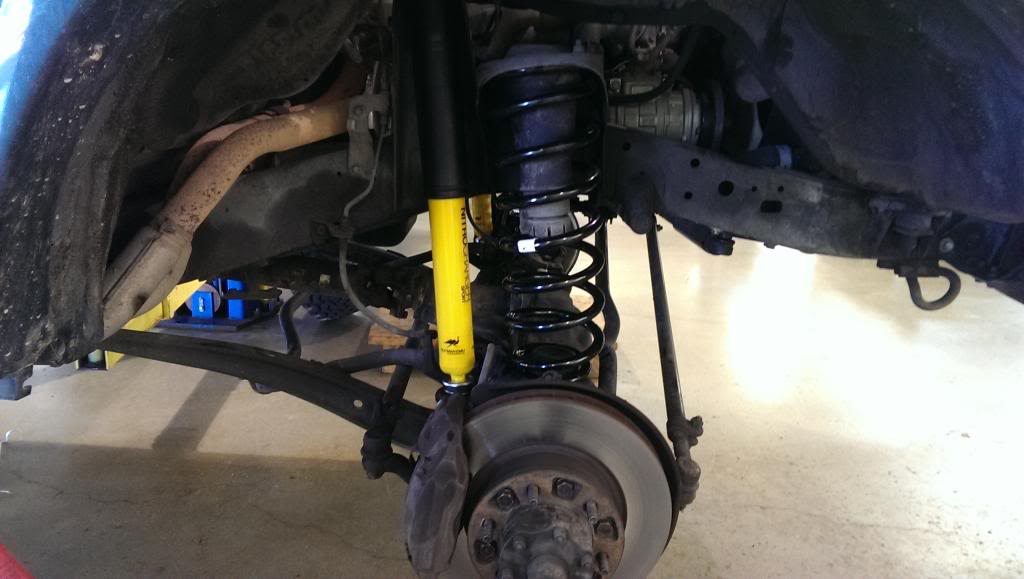

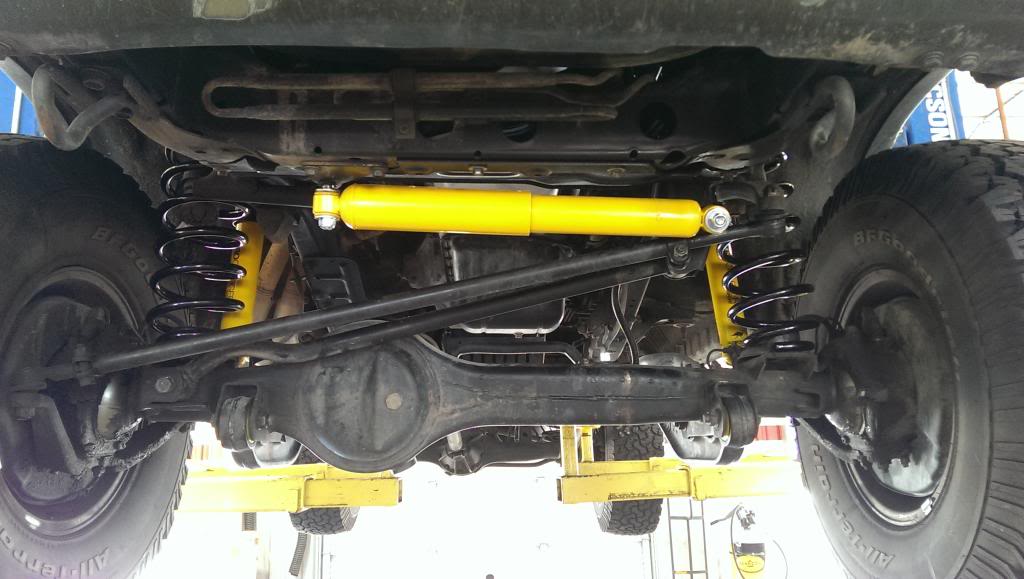

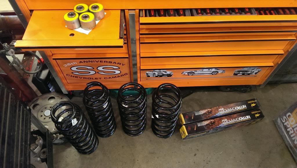

I finally bit the bullet and bought an OME 2.5" lift, I went with medium rear and heavy front for a level stance. I will likely move to the heavy rear after amour and rear drawers.
This is a bad angle, but I got a good 3" of lift over the stock springs with 30/15mm spacers.

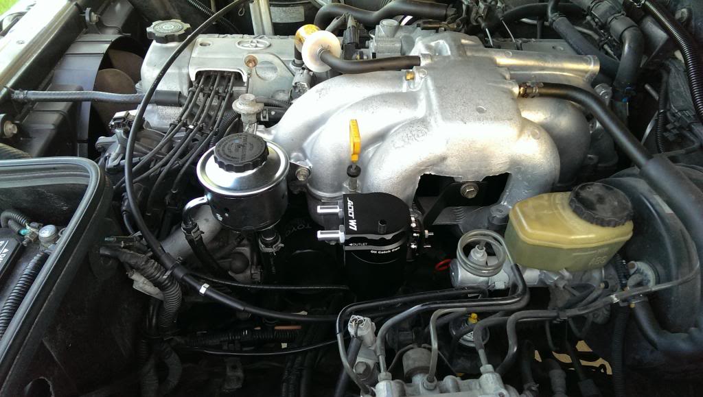

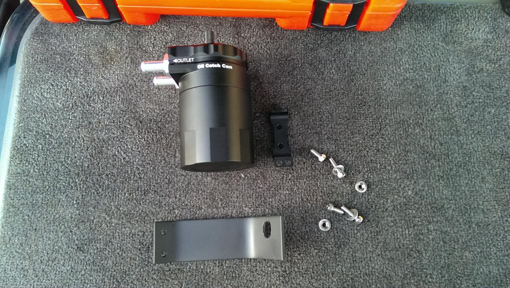

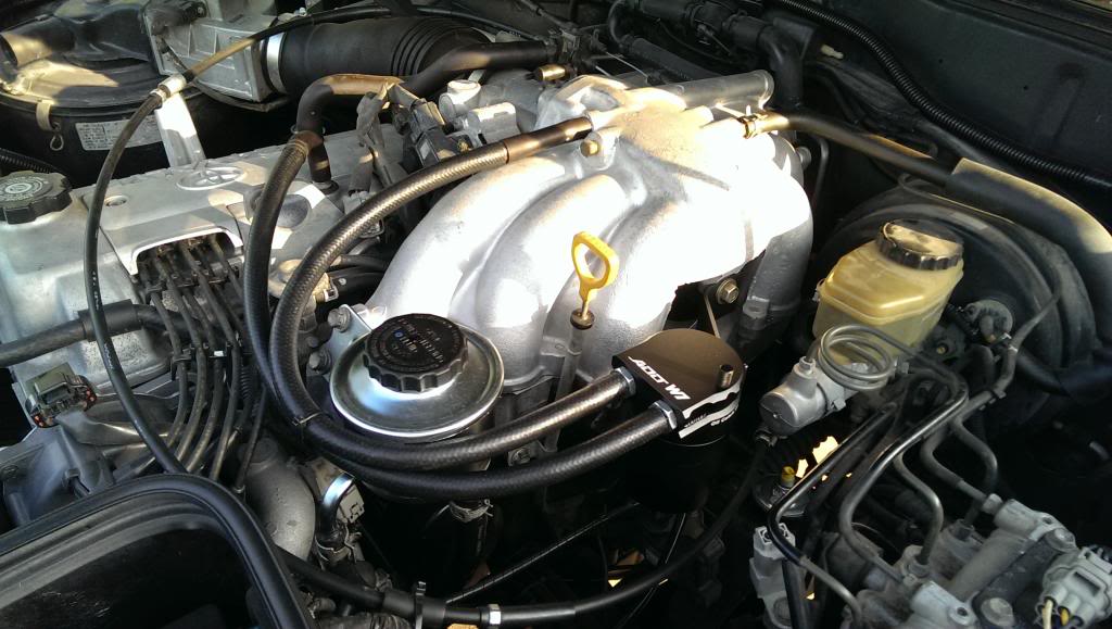

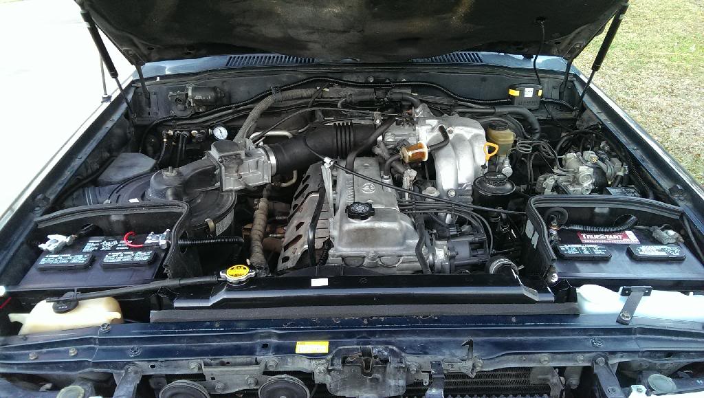

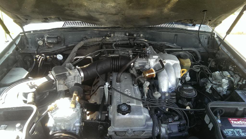

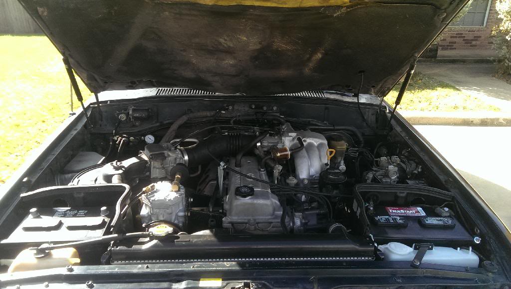

I installed a catch can on the pcv line, I fabbed up a small bracket to mount it to the intake manifold.

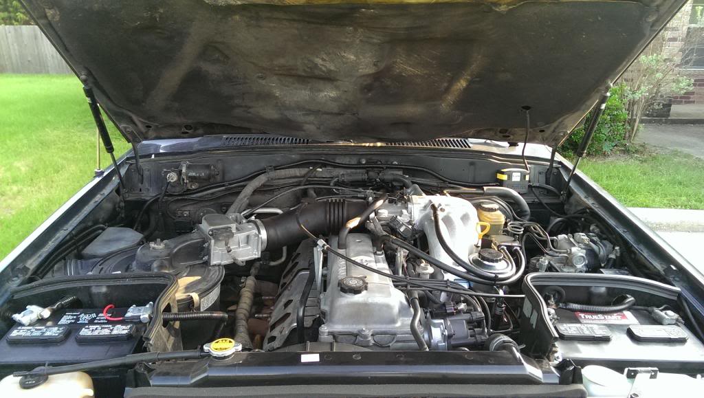

Here is a current engine pic.

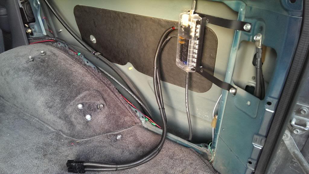

I finally installed a blue sea fuse box, I fabbed up some brackets and mounted it to the sub bracket holes. I ran 4 gauge wire from the second battery.

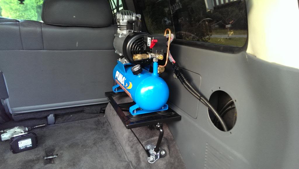

Here is the Puma installed on the bracket I made that is finally done and painted. I wired the puma to the blue sea fuse box with 8 gauge wire and anderson power pole connectors.

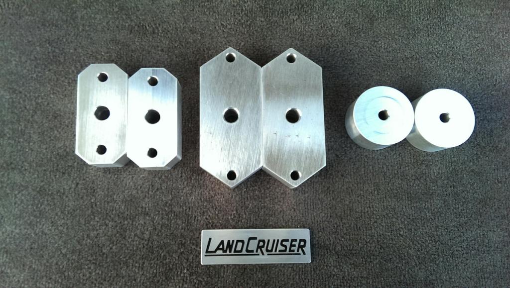

Sway bar and front/rear bump stops spacers made by Hitit66, I will install these soon.
I made some rear sway bar extensions and will install them soon also. I will be making lspv extension soon as well.
Where did you get that oil catch can?
EBay. I wanted a smaller can and that's the only place I could find what I wanted. It's actually well made, but was $89, more than I wanted to pay. It doesn't have as much baffling as I wanted so I added some steel mesh to help condense the oil.
