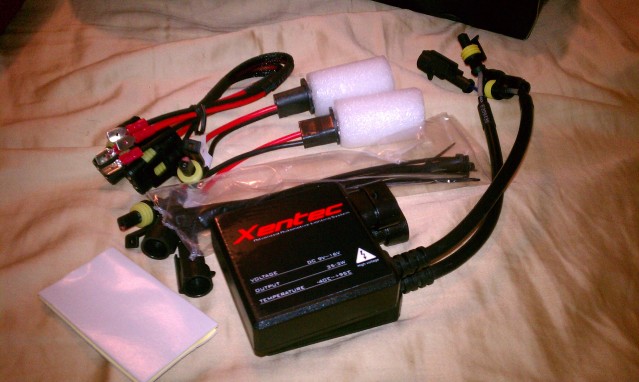

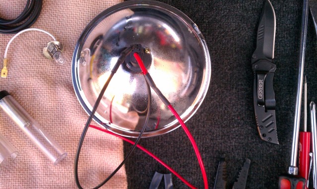

Here are a few pics from the hid conversion I just finished on my lights. I bought a Xentec H3 6k 35w kit from Amazon for about $41 Shipped.

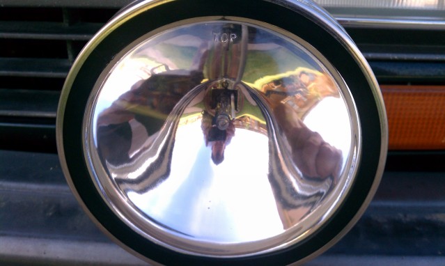

Here are the bulbs mounted. I had to bent the tabs a bit and cut the plugs off of the bulbs and splice in about 6-8" of wire to feed the wires through the light housing(wires run through the mounting bolt).
Here are the plugs back on the bulbs.
Bulb in the lens.

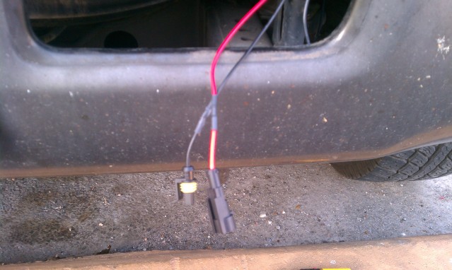

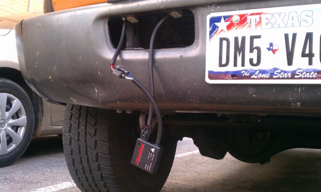

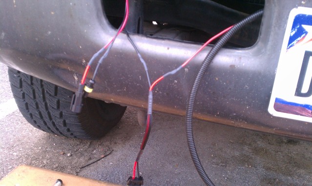

All the wiring done.
Wiring all wrapped up. I used the double sided tape included and stuck the ballast to the back side of the bumper and secured the wiring with zip ties. I picked up the lights for another vehicle years ago for cheap, but I never used them. I probably have about $70 plus wiring supplies in these. I will take a pic of them on after dark.

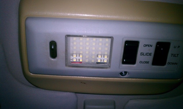

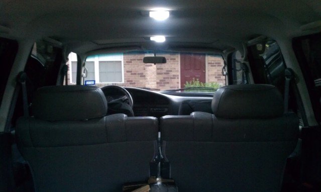

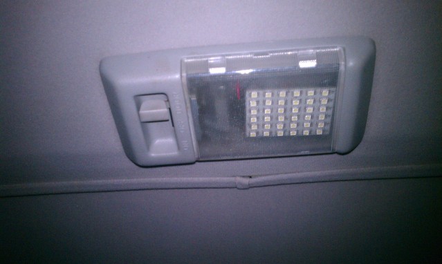

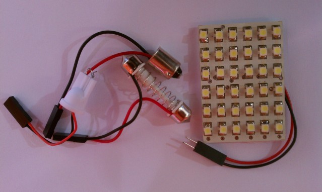

Here are a few pics of my led dome panels installed. These are 36 led panels from Amazon with dome adapters. They are bright and decent quality, but are made in China so I am not expecting long life. But they were cheap, around $11 shipped. I also installed one of these in the front map light.

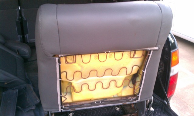

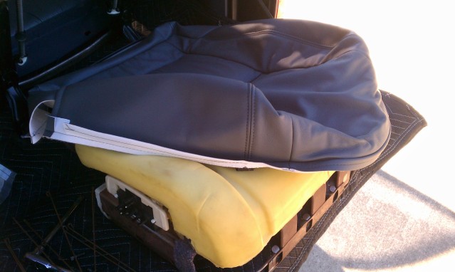

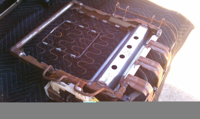

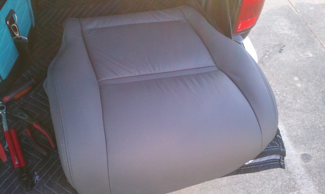

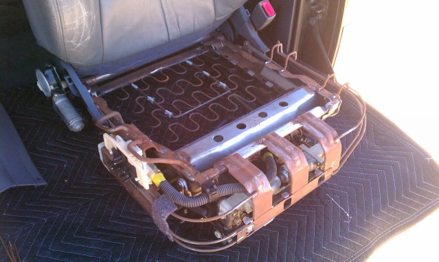

I started leather replacement, and got the passenger seat done. Need to find time to do the rest. Leather is from Shane, and using new foam for front seats.
Wow that looks nice! Makes me want to do my seats..... Maybe next year.
That does look good man! How close is the color match with the second row? My second row seats and the two third row seats are in mint shape, but didn't know how new leather on the front two seats would match color-wise... Also did you mention the cost for the leather? New foam or reuse from original seat?
The color matches the vinyl on the door panels and he dash, but the other seats are lighter color from fading over the years. I used new oem foam for the front seats. The leather for front seats, seat backs, and 2nd row was 925 shipped.
Thanks for the quick feedback! Sorry for the follow on question, but did the price above include that OEM foam? Again, love the post and progressive pics. Looking really good.:)
I wish. The foam was about 400 for 4 pieces to do front seats and that's employee price.
Ouch! I bet that foam would be hard to match after-market tho... you probably did the right thing getting the OEM. So the seat holds up correctly.

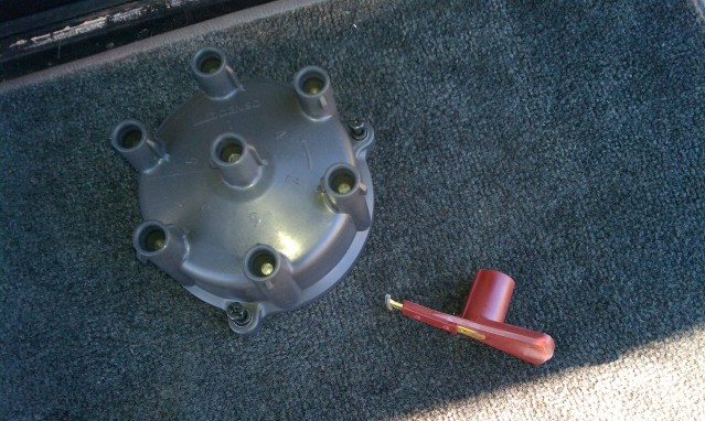

Installed new cap and rotor:

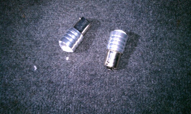

Installed cree led reverse bulbs:

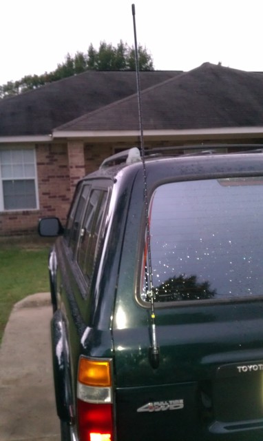

Firestick cb mount, I went with a 4' firestick, and the compact Midland cb 75-822. I bought the antenna in a kit for no ground plane since I planned rear mount it. I didn't really want to use this mount, but I had it and it will make running the cable more stealth since it will go through the hatch. I am concerned with the hatch sheet metal flexing, so I think I will reinforce the backside with aluminum sheet glued inside the hatch. I have some rubber plugs for the emblem holes until I find a permanent solution.

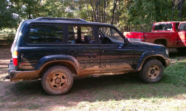

Here are a few pics from a newer offroad park I went to a few weeks ago. We rode some trails, creeks, and a few mud holes. Going back next month to try some rocks.
