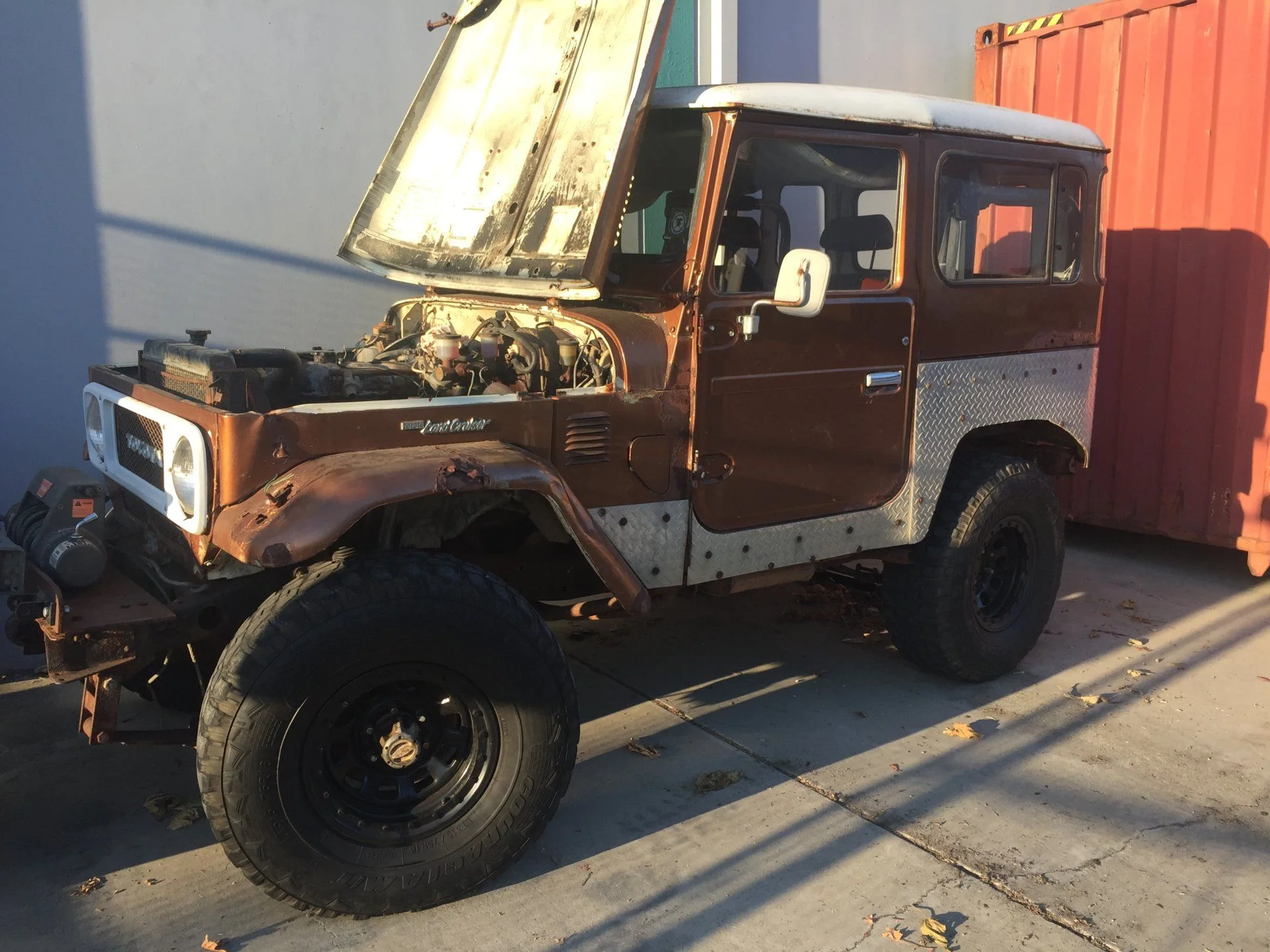

I initially went to see this truck because it was local and in my price range. when I saw it in person it looked rough and I immediately knew it would take alot of work.

the basics:
-Original 2F not running/starting, turns over though
-Clutch master/slave not disengaging clutch, need to figure out if it is a bleeding issue or seals.
-Soft brakes, no pedal feel. quick look under the truck found some pinched/cut hard lines
-No intake
-Wiring is a mess
-Front drive shaft is disconnected. the output from the tcase looks like it potentially broke the spline? hard to tell.

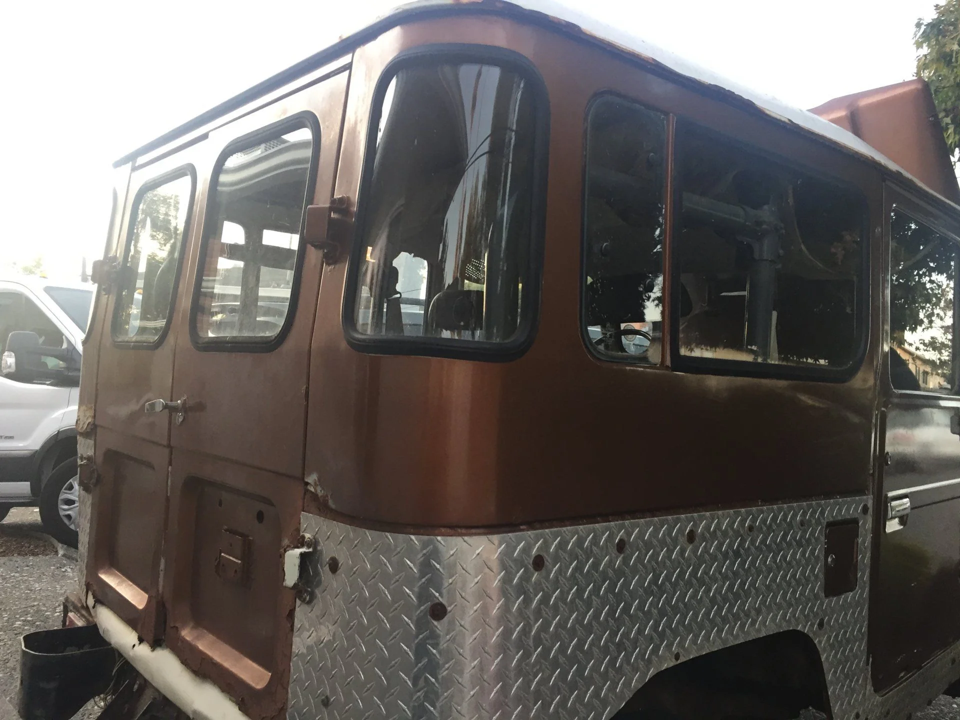

-Lots of rust, BAD rust, almost every body panel, fenders, doors, floor, quarters, ambi doors....
-interior is in decent shape
The end goal for this truck is mostly to be a trail rig. Reliability/capability is what I am looking for. I still want to be able to drive to the trails so needs to be relatively street-able but willing to tolerate decrease street performance.

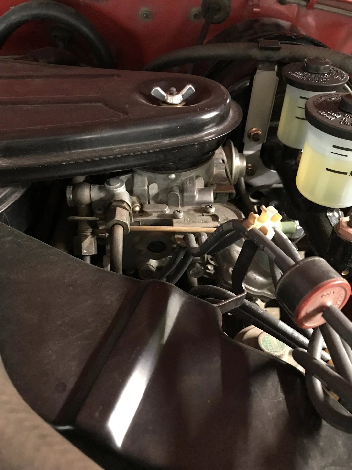

Yeah there will be some work involved in sorting everything out. Do you by chance have any pics of your engine specifically smog stuff so I can start to figure out where things are supposed to go.
I also need to rebuild the carb so if you’ve got any pics of what a correct running one looks like I would appreciate it!

Yes I can get you pics. My 77 stuff will be a little different but should get you started. Man I hope my post did not discourage you. I just wanted you to be aware of the issues you are likely facing. Work in the carrot business and this is a very busy time. Pics will be coming Saturday.

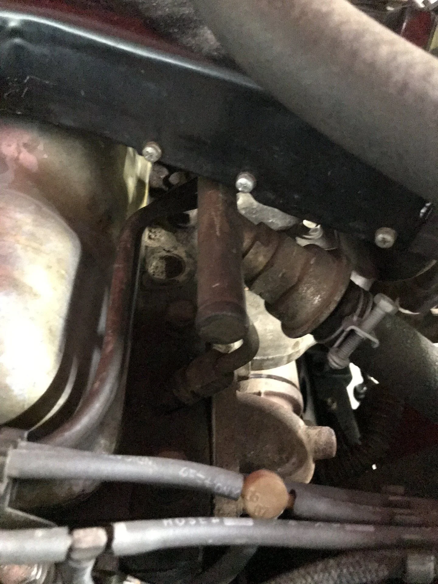

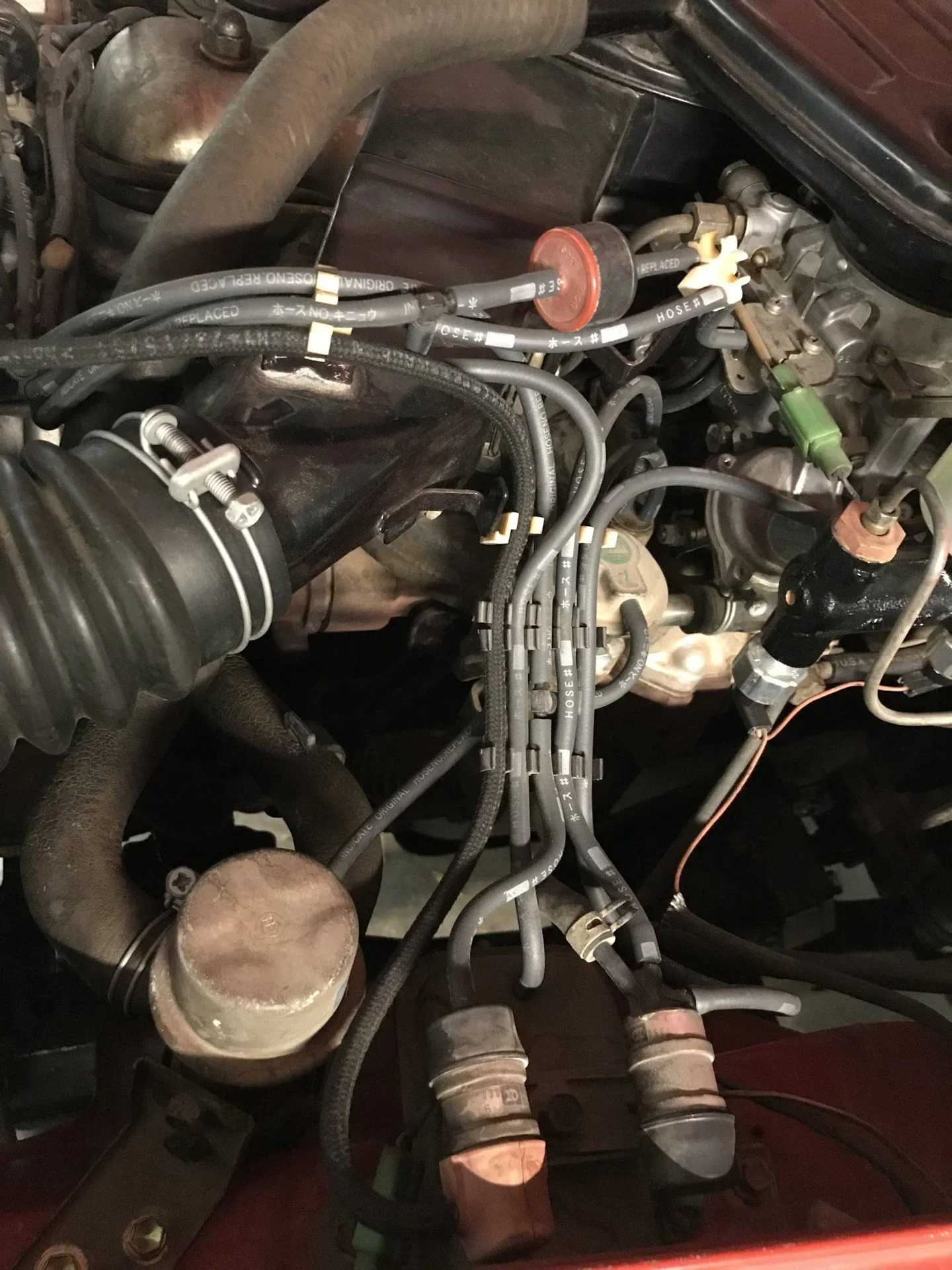

here are some quick pics without pulling air cleaner After looking at some "smog diagrams" some of the vacuum hoses and VSV's ( vacuum switching valves ) will be fairly different for your 79 As you get closer you can ask for specifics there is a digital emissions manual on here for 79 i believe
here are some quick pics without pulling air cleaner After looking at some "smog diagrams" some of the vacuum hoses and VSV's ( vacuum switching valves ) will be fairly different for your 79 As you get closer you can ask for specifics there is a digital emissions manual on here for 79 i believe View attachment 2151608View attachment 2151607View attachment 2151609
