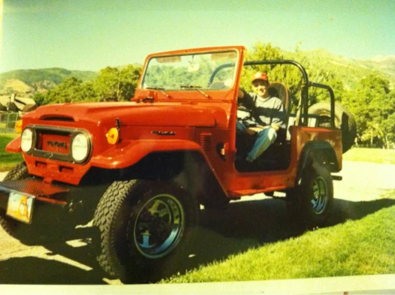

My first experience with an FJ40 was back in the '90's in high school when my father sold his '85 solid axle hi-lux for a cherry '76 FJ40. Affectionately named the tin can turtle, this began a family passion for all things 'cruiser (and all things turtle). As soon as I was able to drive, my landcruiser radar was buzzing and we found the distinct white top peaking over an private wrecking yard in Salt Lake City. We jumped the fence and found a relatively intact '78 that had been "totaled" by the insurance after a front right impact. Taking the license number down, my aunt at the DMV helped us track down the owner and $2500 later, it was dropped off of a trailer at my parents house for a six month restoration/build including a high output SBC and bright red paint.
I only have a few regrets from that cruiser, first being that I ever sold it. Also, add-a-leafs make for a terrible ride. Armor-all on the tires and chrome rims are...well...out of place. Lastly, what's with that black bezel that's on upside down? College came and sadly, both cruisers were sold. Fast-forward 16 years of higher learning and I picked up a '66 (or is it a '65?) for $1500 that had been rotting in a neighbors driveway for a decade or so.
