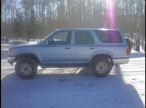

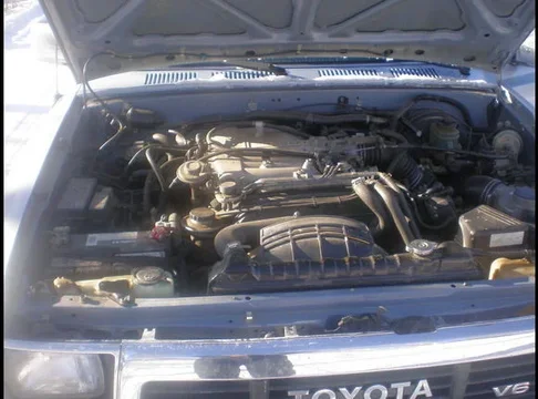

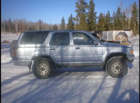

I am pretty much a newbie in the 80's and yesterday I traded my old Chev truck for a 2nd gen T4R for my daughter to drive and park more successfully. This rig is in pretty good shape for the year, but there are probs. I read all about some of them last night but wanted to start a thread with a list of questions to get a kick start on this thing.
1. 1990 T4R 155k, 3.0, 31x10.5 tires.
2. Had headgasket done by unk mechanic friend of PO in past 3kmiles
3. had full tune up at garage by PO in last 1k miles
4. new tires and shocks by PO in past 3kmiles
5. new front CV's in past 3k miles.
Problems:
1. Runs like *&^$# at idle. dies while sitting at a light. TPS was replaced at tune up, tried adjusting throttle linkage to raise idle, no-go.
2. no speedo, no odo, no tripmeter. All dead. PO describes cold morning drive, clicking sound then dead speedo and all else. O/D off light flashing in the dash. PO says started when speedo died
- cable? speed sensor? gear? cluster? i don't know which
3. loud exhaust but don't see a leak/cant find it if there is
4. loud valve tapping sound from DS head area, improper adjust? oil? dunno.
5. Loud Clunk from front axle on hard left turn.
6. Stereo was a botched install, bezel all cut up and deck sliding around in the sleeve cause they didn't re-use the toyota bracket. need new blue dash bezel and start over.
7. otherwise clean with a little body damage, clean interior, and great tires and shocks. I am optimistic with the recent work done that she is salvageable and be a DD for the daughter at school
All help is appreciated. photos attached.

UPDATE:
Took the truck to a buddy who is very Toyota smart. In 5 seconds he pointed out several vacuum lines that were cracked.
2.09 for a couple feet of vacuum hoses, a little air pressure to blow out the EGR system, and locate a couple of other bad lines, voila!!!!! running like a kitten, no more black smoke on acceleration, great idle, quieter etc......
